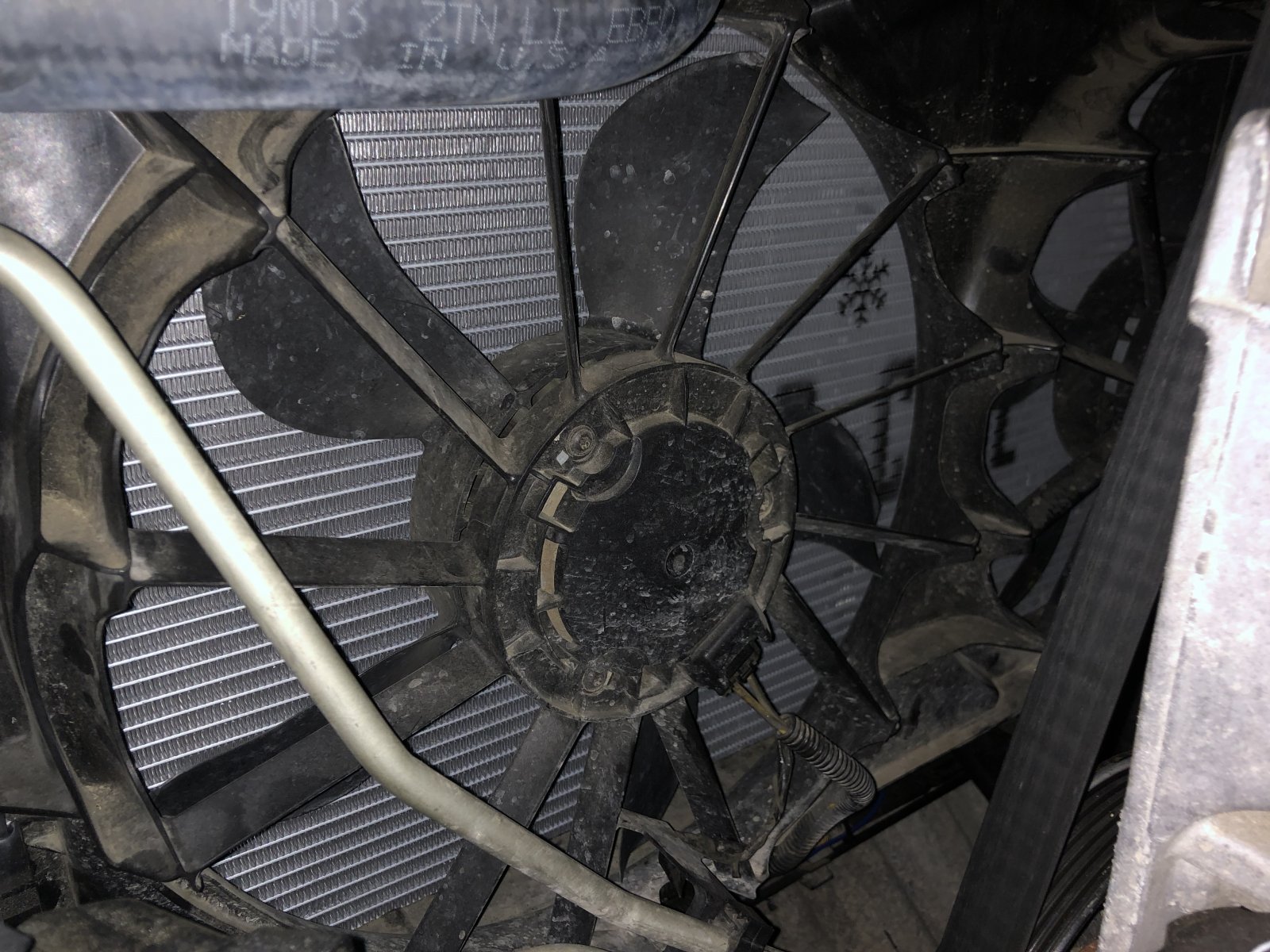

Made it through! One thing that comes to mind is that I have no way to know that my 2012 doesn’t already have 700w fan motors even though it doesn’t list the K5L cooling package. It does have 5 bladed fans and it has the heavy duty towing package, as evidenced by the factory trailer brake controller, engine and transmission oil coolers and the power steering fluid cooler.

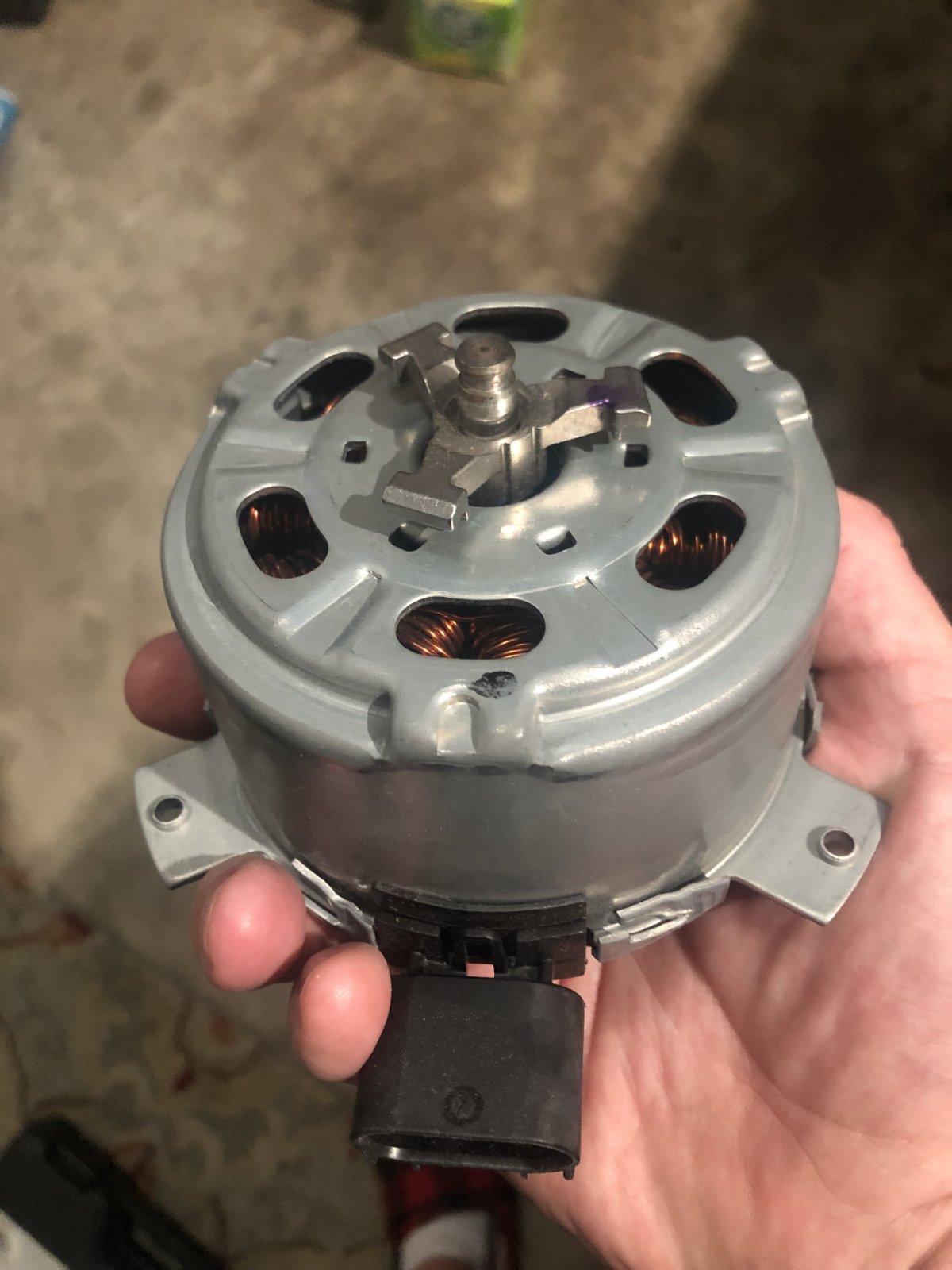

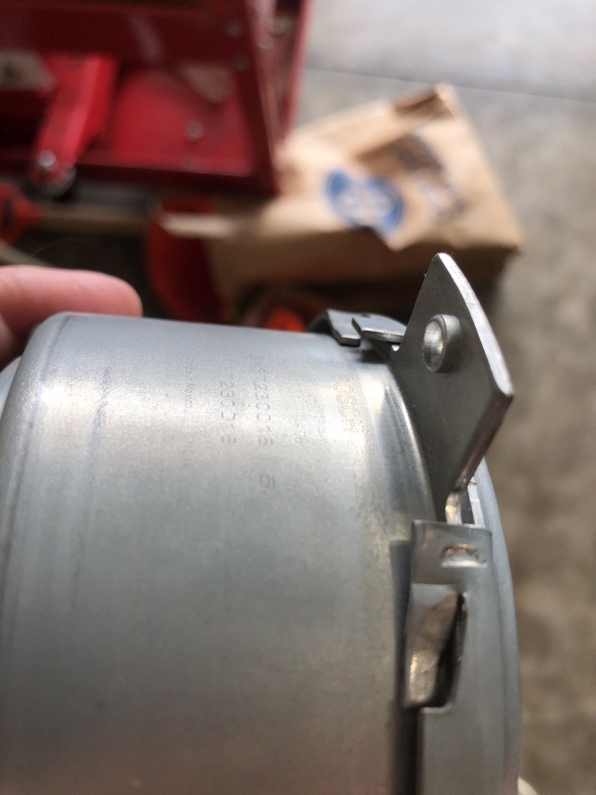

So I misspoke earlier, my 2012 is actually five blade fans, and that’s what I ordered as well to go with the 700 W fan motor. There are no markings for part numbers on either the fan or the motor.

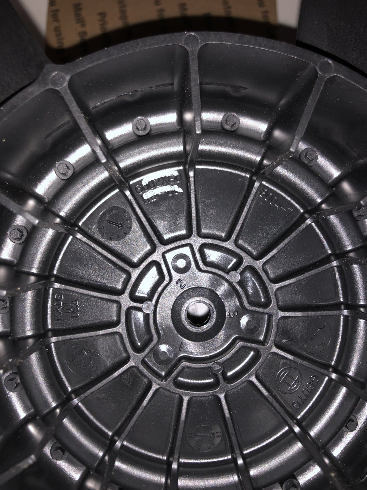

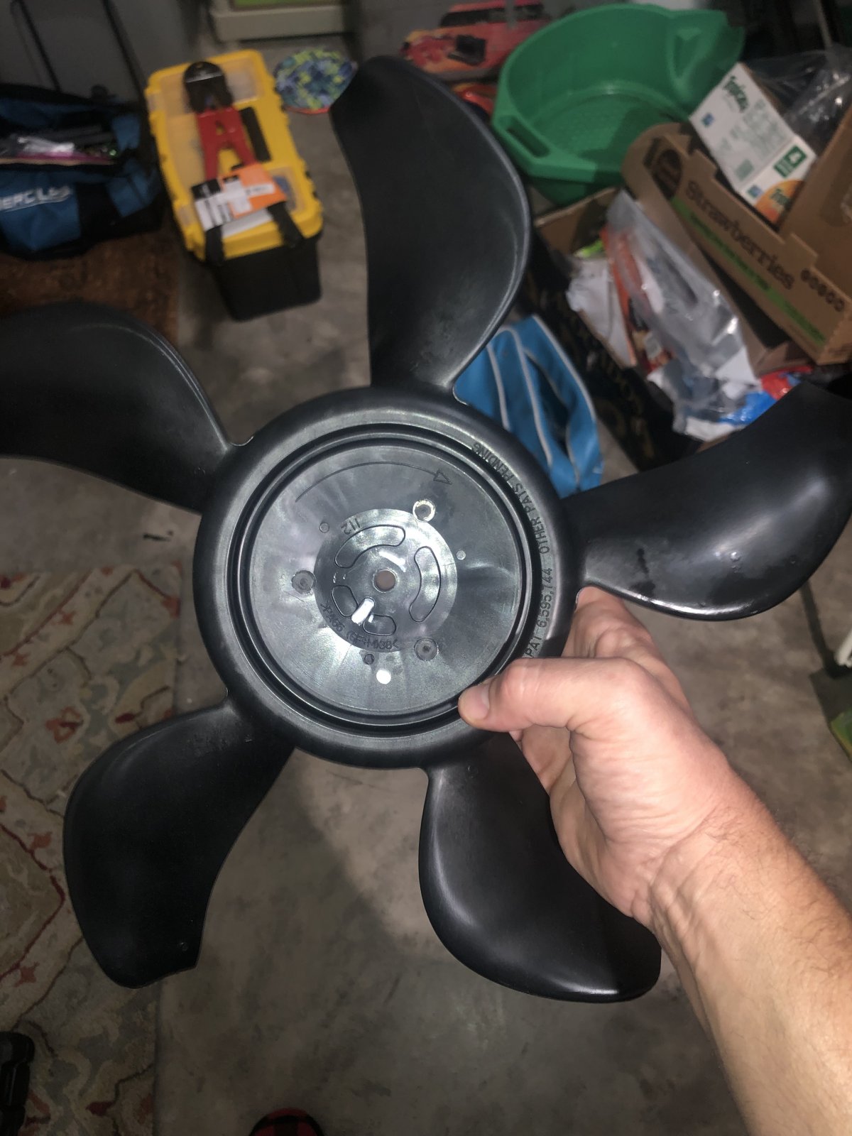

there are markings on the motor, the numbers are stamped in the metal on the deep side of the motor case near one of the 3 bolt tabs, you will have to hold it under some light and at angle to see it, and could I see a picture of the backside of the fan blade? the front looks like the same patent number but that doesn't really many anything as there can be variations

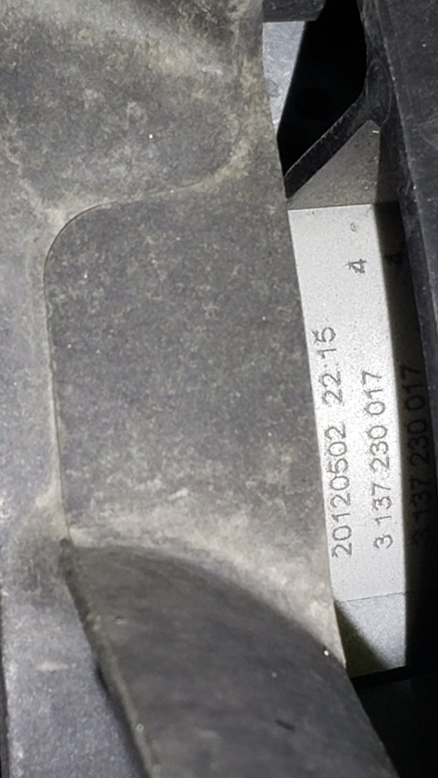

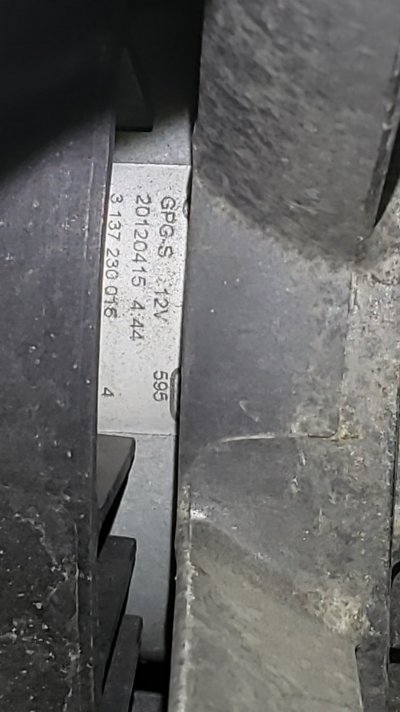

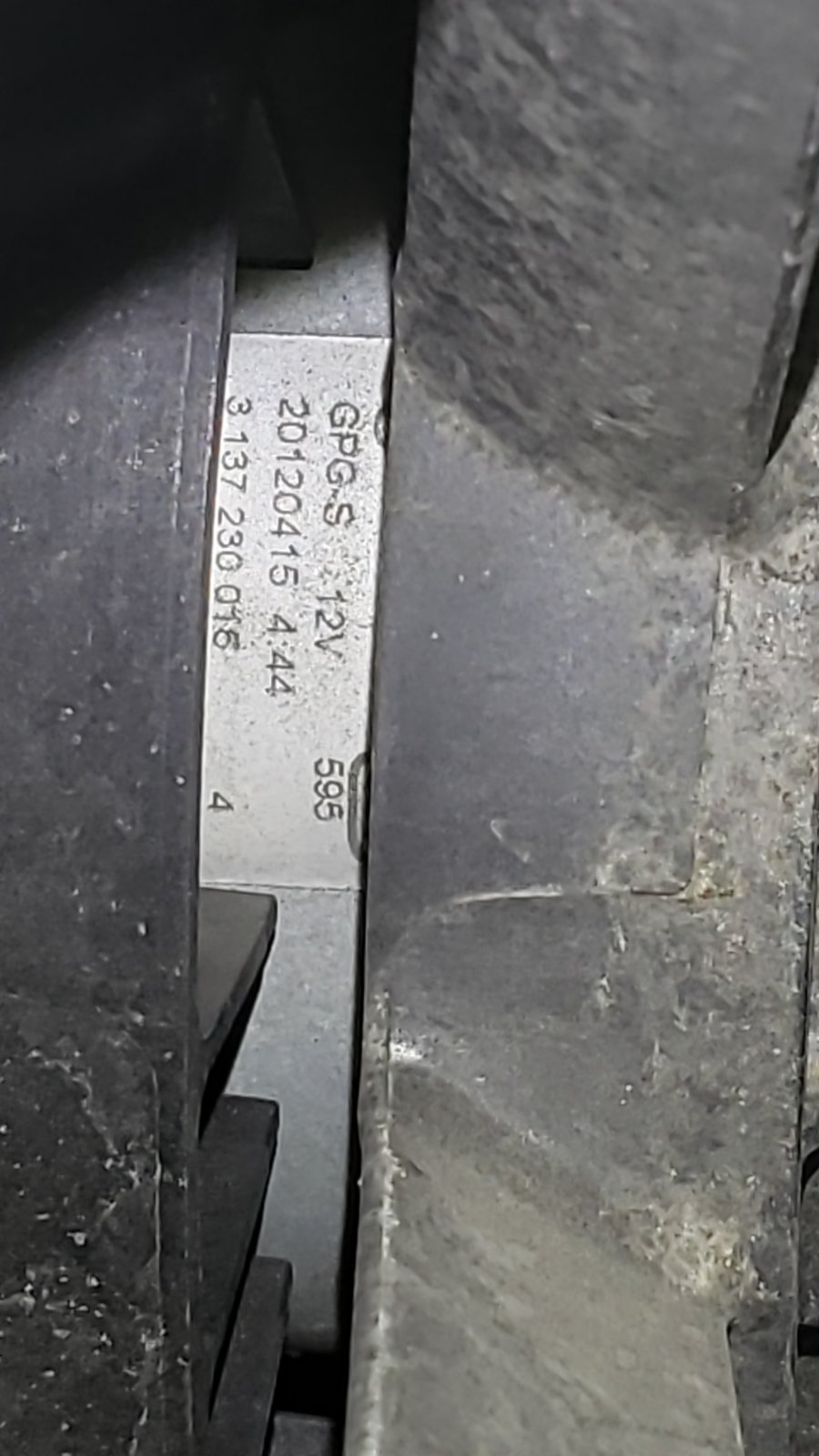

the numbers on the motor will be around one of these area's, it will say bosch nearest the bolt fin area and have a list of numbers under it

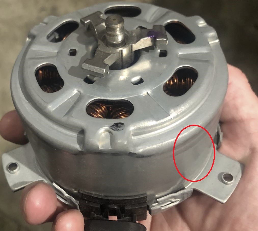

also the harness connector for the right motor has either a blotch of white paint on it or a nice painted white strip, my theory is the blotch of white painted one is 700w? just a theory based on photos I have looked at, could simply be they changed the way they marked them over time.

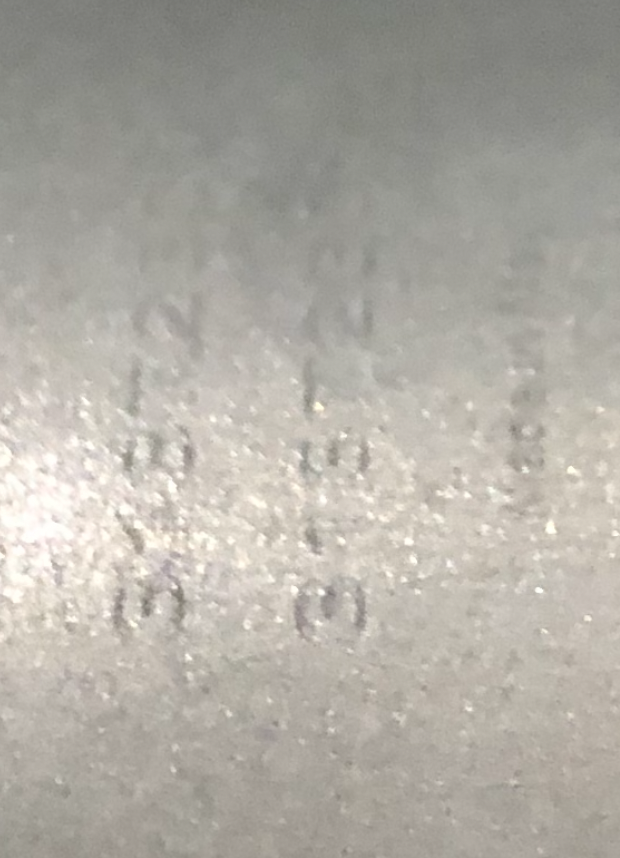

Sure, here you go. Those numbers on the side of the motor are super faint. So even with my best reading glasses, I can’t be certain that I got it right. Looks like 3137230016.
