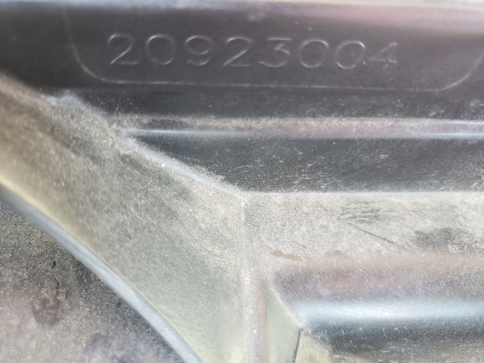

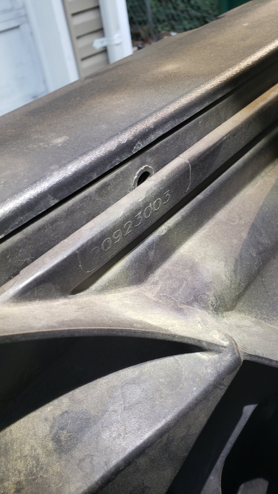

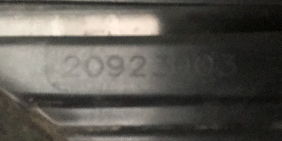

Here is the number on the shroud from my 2012. Sorry for the fuzzy photo, but the number is 20923003.
And just for fun, here is the shroud number from my 2007. Both trucks are XL Denali's.
I also inspected the fan motors on both trucks carefully, and can't find any stickers that show part numbers anywhere on them, top or bottom.

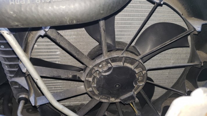

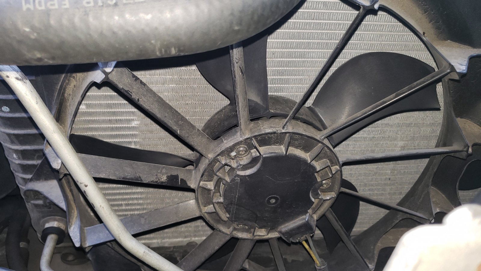

that fan blade matches the one on this shroud I bought that is supposed to be 700w
I wonder what the backside of a 5 blade non-rimmed 500w fan blade looks like, there must be a design difference between the two more plastic or something on the 700w

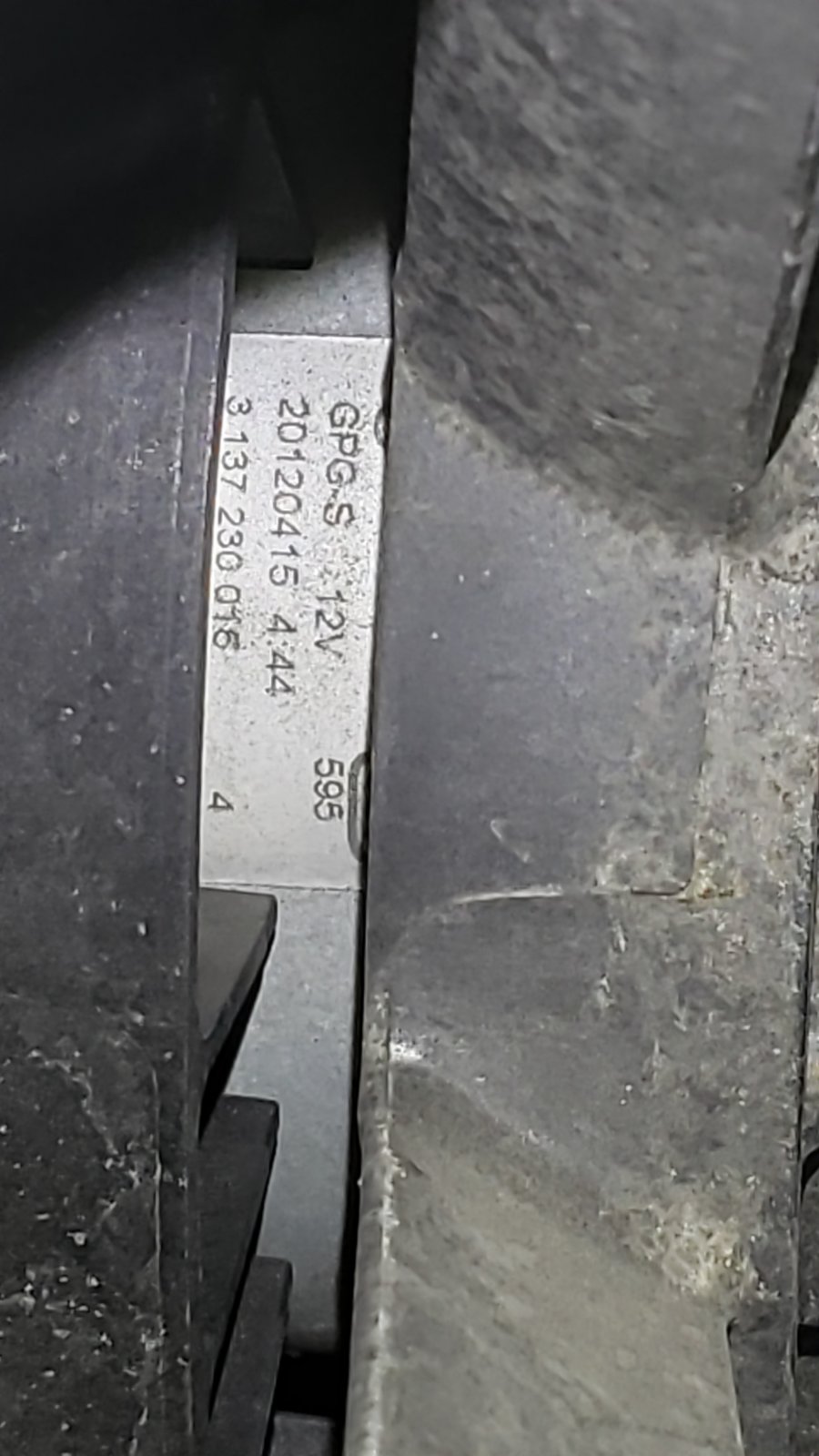

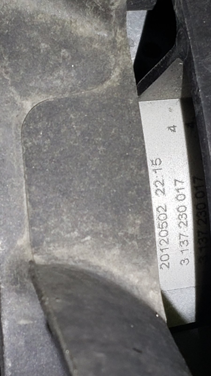

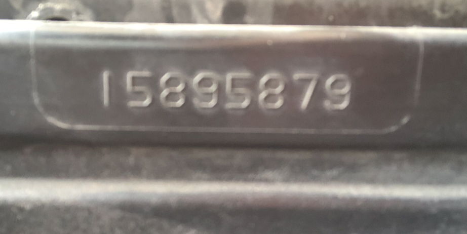

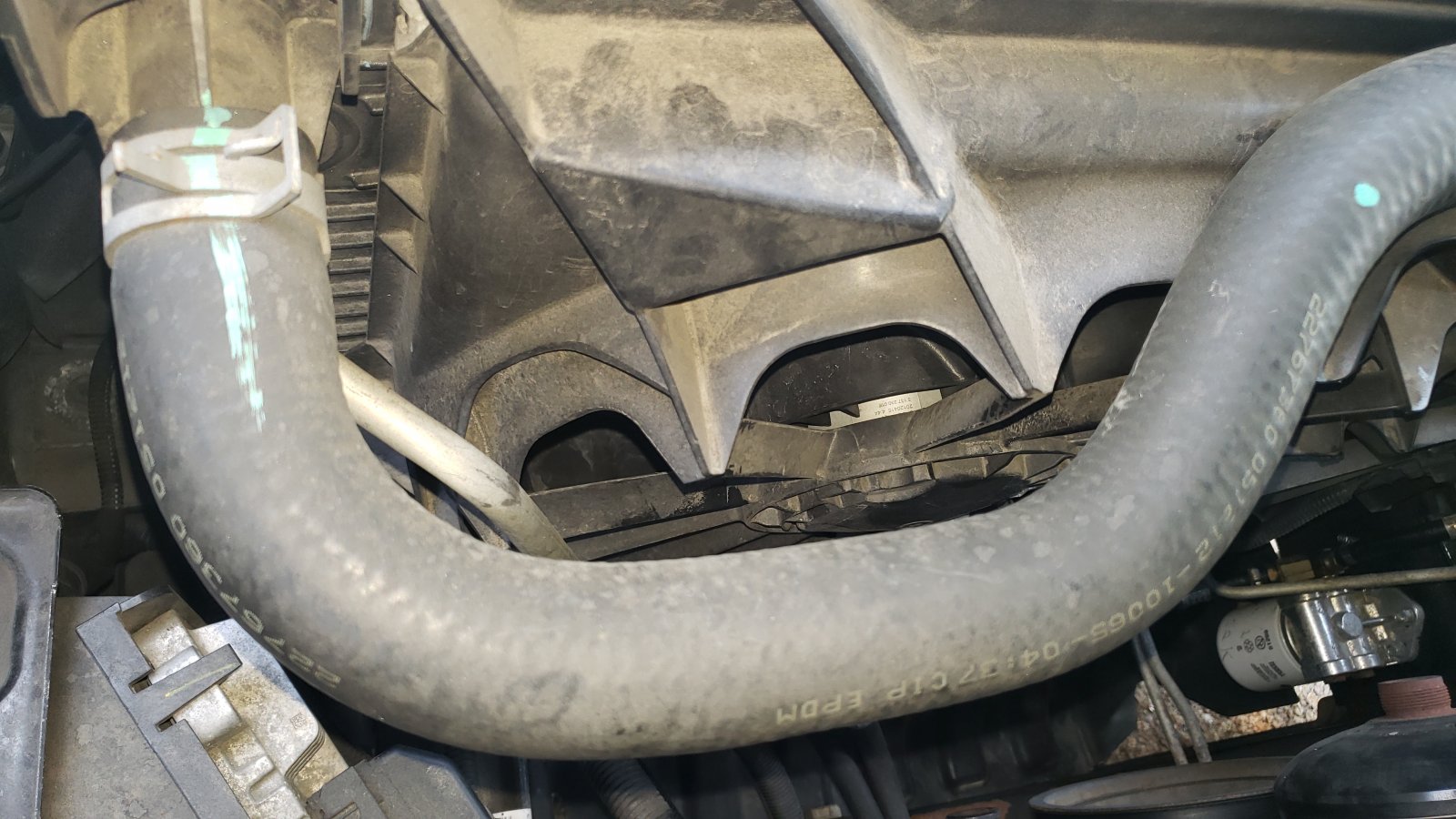

Here's some pics of the part #s on my shroud, left fan motor, and right fan motor.
The left fan motor has the same part# you listed above.
They're Bosch motors, 5 blade non-rimmed blades, and stock non K5L rpo so I'm guessing 500w but they're loud and really blow
@Doubeleive may be curious about this info also
the shroud I bought that is supposed to be 700w doesn't have any room to take a photo like that except right in the back bottom where the harness plugs in but the numbers are not located there on the motor they are in a different spot, plus the plastic from the back of the fan is in the way.
can you take another shot but back up a little bit I can't tell what is shroud and what is fan
Don't know if these help

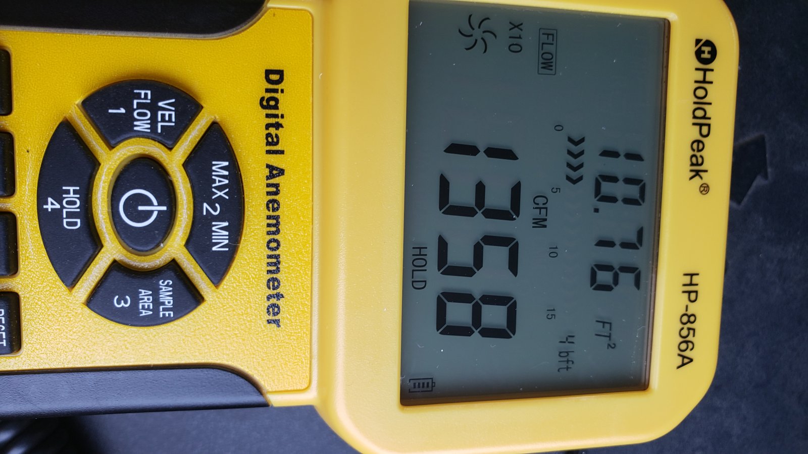

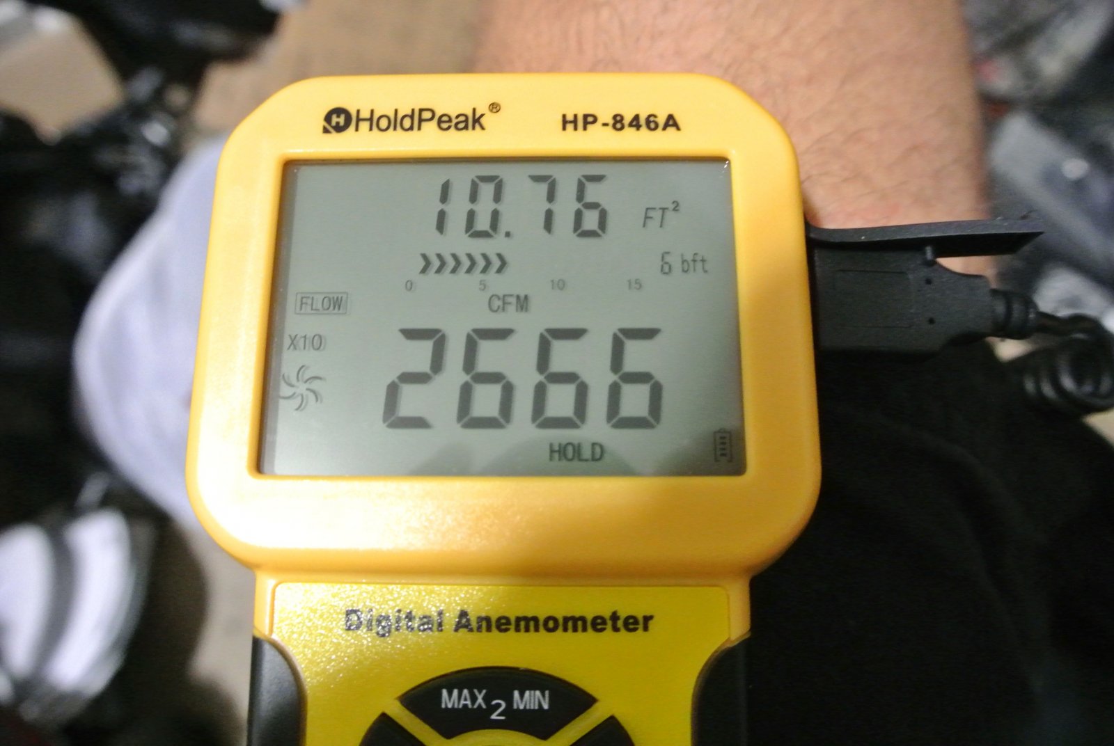

had the seller send me a replacement meter still get the same readings 2400-2600 cfm, with the left side being 2600 and right 2400 on high. 7/9 rimmed 700w
Odd, then maybe it's my meter?
I would think if I used the same settings I would get somewhat the same kind of reading, but mines waaay more.
How/where are you actually holding the meter sensor?

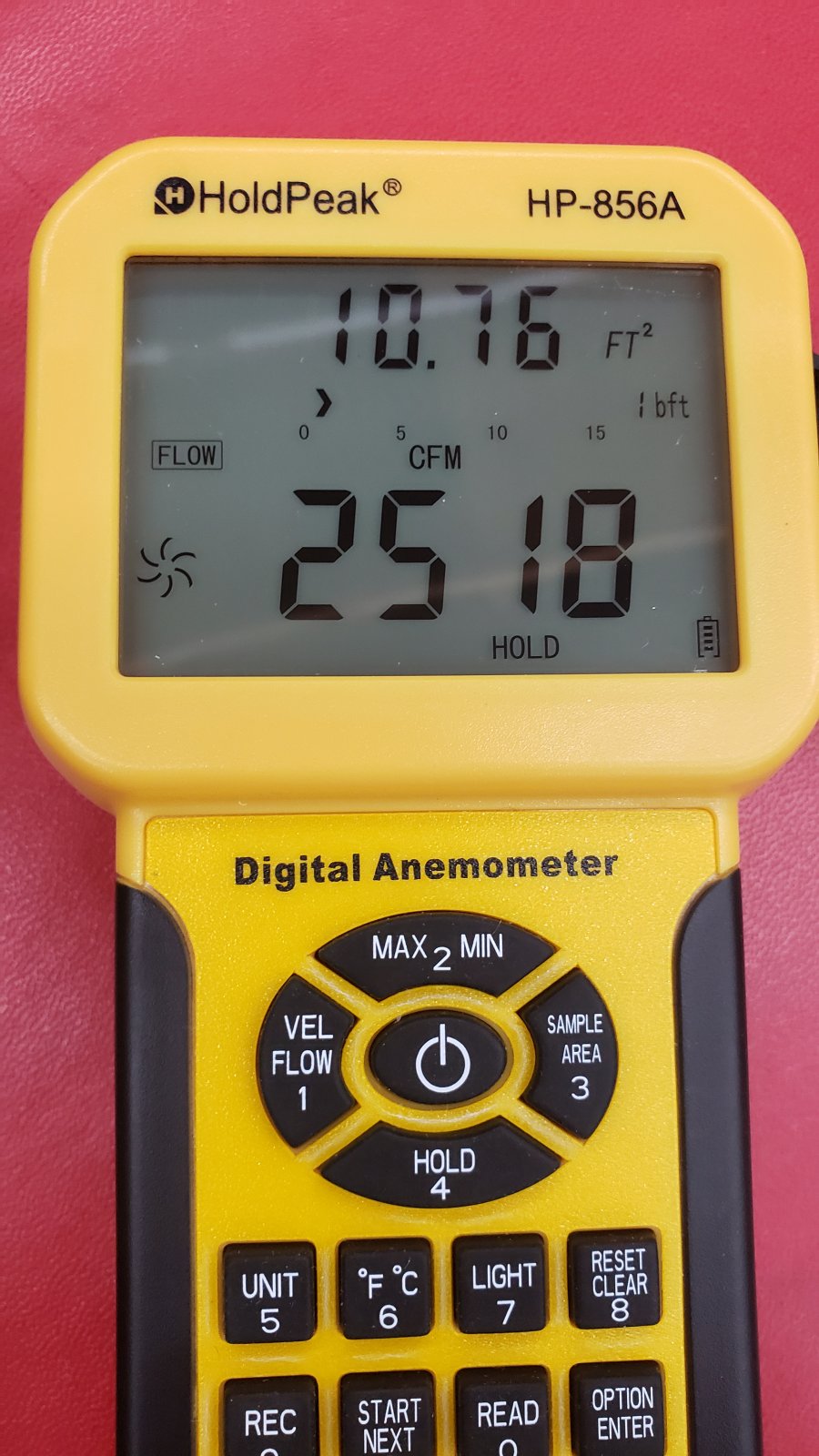

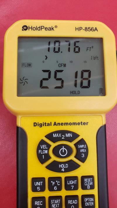

For me to get that reading with those settings it barely takes any air. Also notice the 1bft and only 1 arrow to get that same reading.

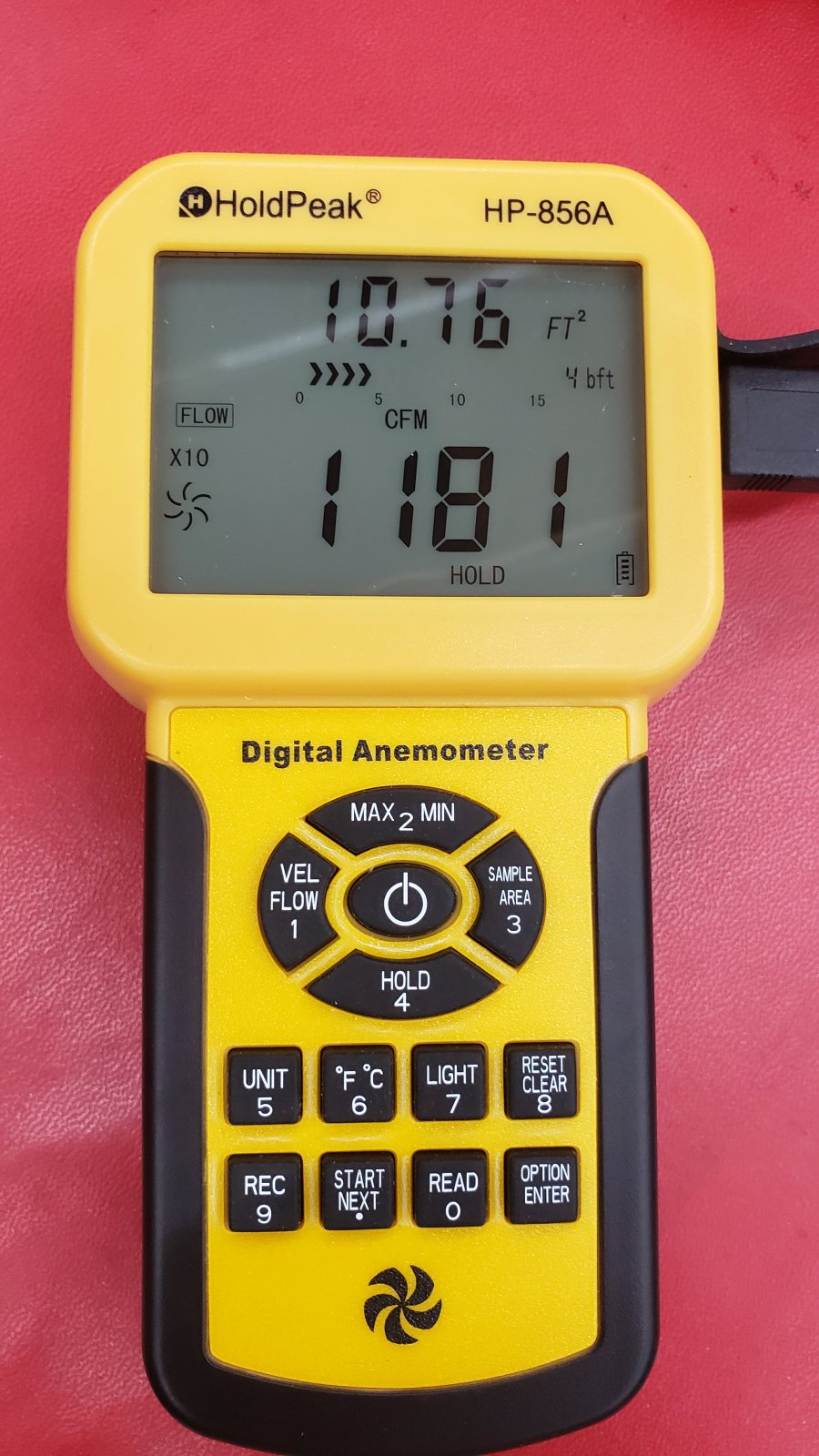

OK, I messed with my meter, cleared AL settings and re-entered 1.000 M/2 (which is 10.76 FT/2) and held it up to the minisplit head unit in my garage and I was getting a more "on par" reading20210727_163916.jpg

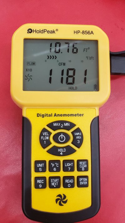

OK, retesting my drivers side fan, depending how/angle I hold it it will read x1 and high cfm like in the 8000/9000s, but while moving it around it will read x10 and be in the 1200/1300s20210727_164641.jpg

I have a vornado house fan that blows 8000cfm but it only get's the flow to X1, the fans on the truck get it up to x10
I know the cfm Is supposed to be setup for the area being tested. Usually setup for air through a duct or corridor. An open fan probably has a special procedure or setting up like the physical size of the fan in square footage to get a more accurate reading.
