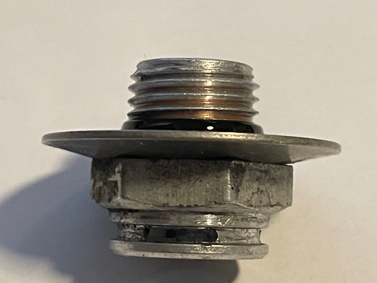

Is the female side a different thread size? :p
outside diameter of threads looked like 14mm with a ruler..
but dorman part says 5/8-18...
mikez71
Mar 9, 2023
3,398
4,220
Ah, gotcha. Calipers measured 14.15mm..
thread pitch looks like 1.5mm..
BUT that is a 2005 GM radiator.. Which uses the same generic replacement radiator as my 2012.
mikez71
Mar 9, 2023
3,398
4,220
Thank you for making the effort to measure for me!
No problem!
Unfortunately it looks like I measured the wrong year.. It seems like the older transmissions used a different size..
Glad you didn't go off my measurements!

Interesting that those are SAE threads.
