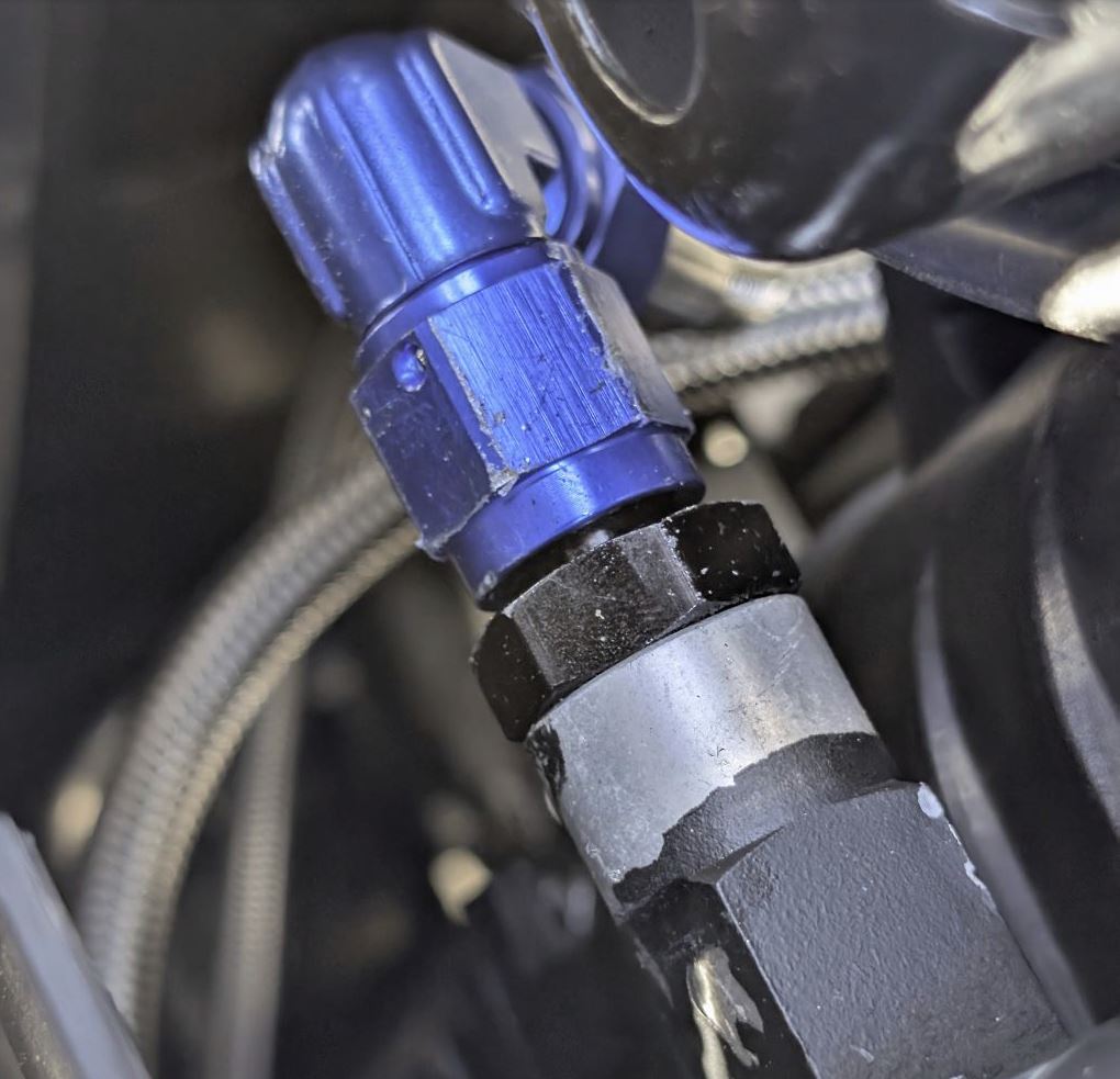

What did you use for the OEM lines to AN fitting? I have some leftover 6an from my other build I can use. I dont think these lines are high pressure that it would require SS AN fitting? aluminum fitting would probably be sufficient given that I see a lot o people use barb fitting?

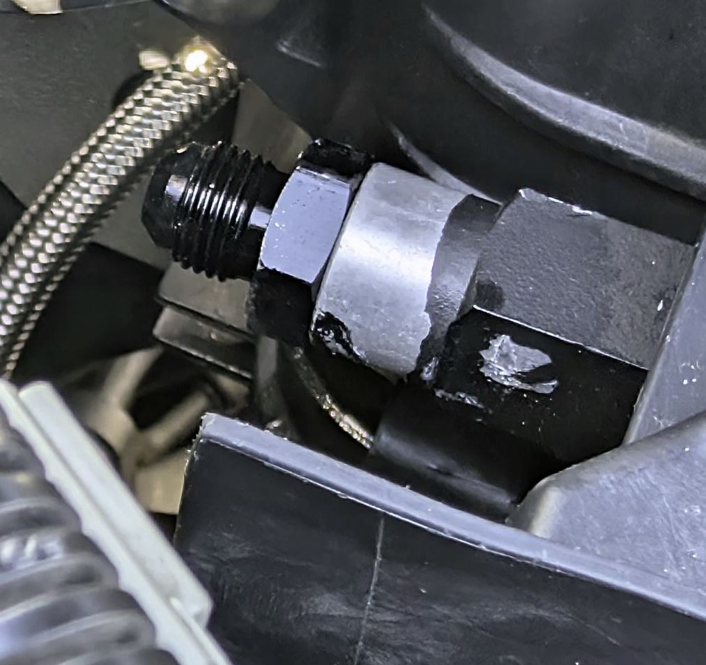

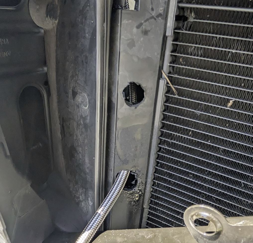

this is not professional work, it's out of sight out of mind behind the grill.

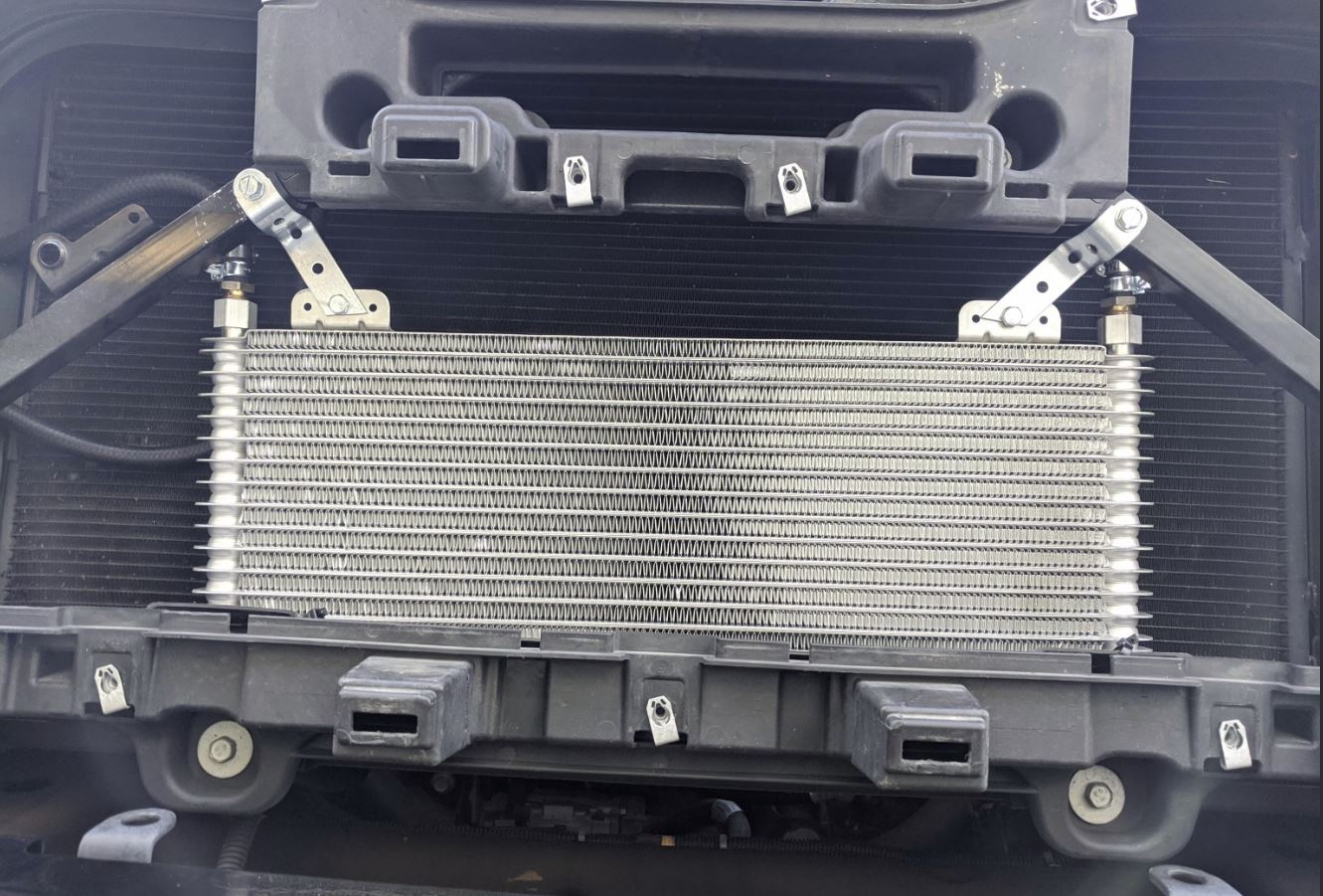

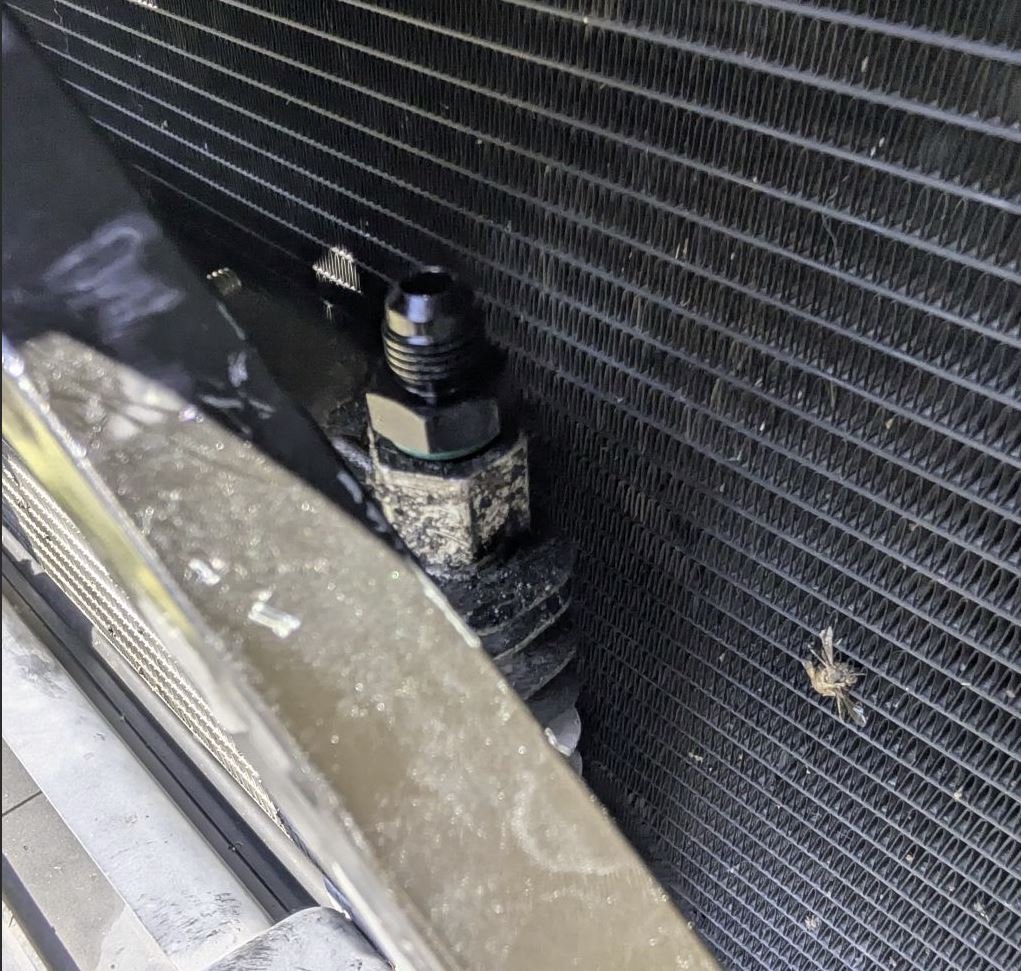

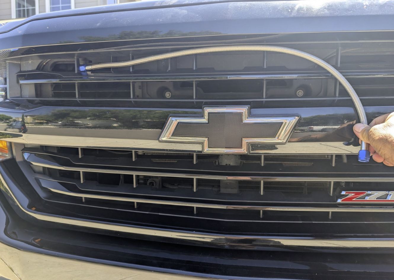

I do not have a finished picture with the 6an lines attached, but my last photo is how it will fit behind the shutters, you will want to trim the plastic wing of a couple shutter levers in order to be sure there is clearance for the shutters to open/close otherwise if the shutter hangs up it will throw a code. I originally used the rubber hose and worm clamps provided with the trucool but they leaked and they leaked on my yukon also. both of them I changed over to 6an.
you will be connecting on the left side (passenger side)
you will need 2 6an lines I used a 24" for 1 line and a 54" for the other line
you will need to make 2 holes in the plastic on the left side in order to fit the 6an lines thru to the front to connect to the tru-cool

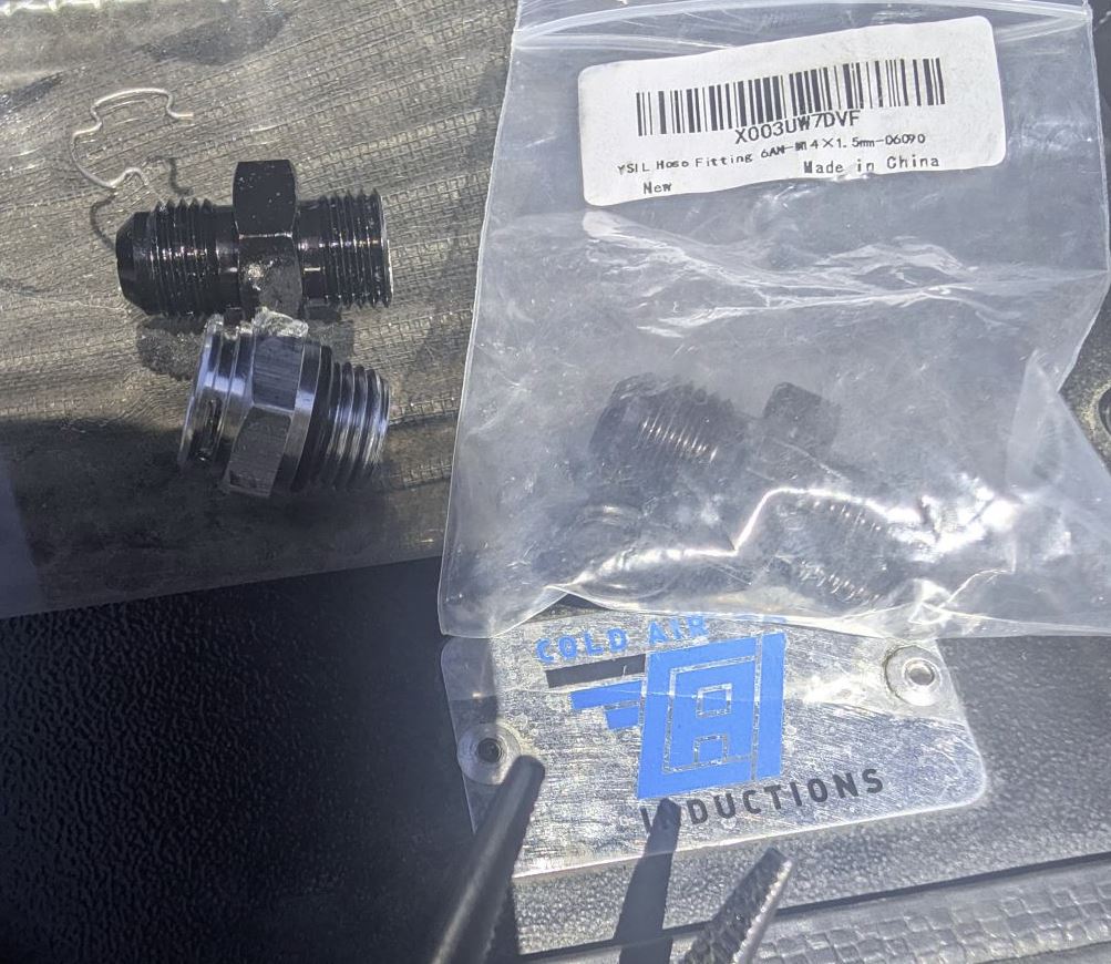

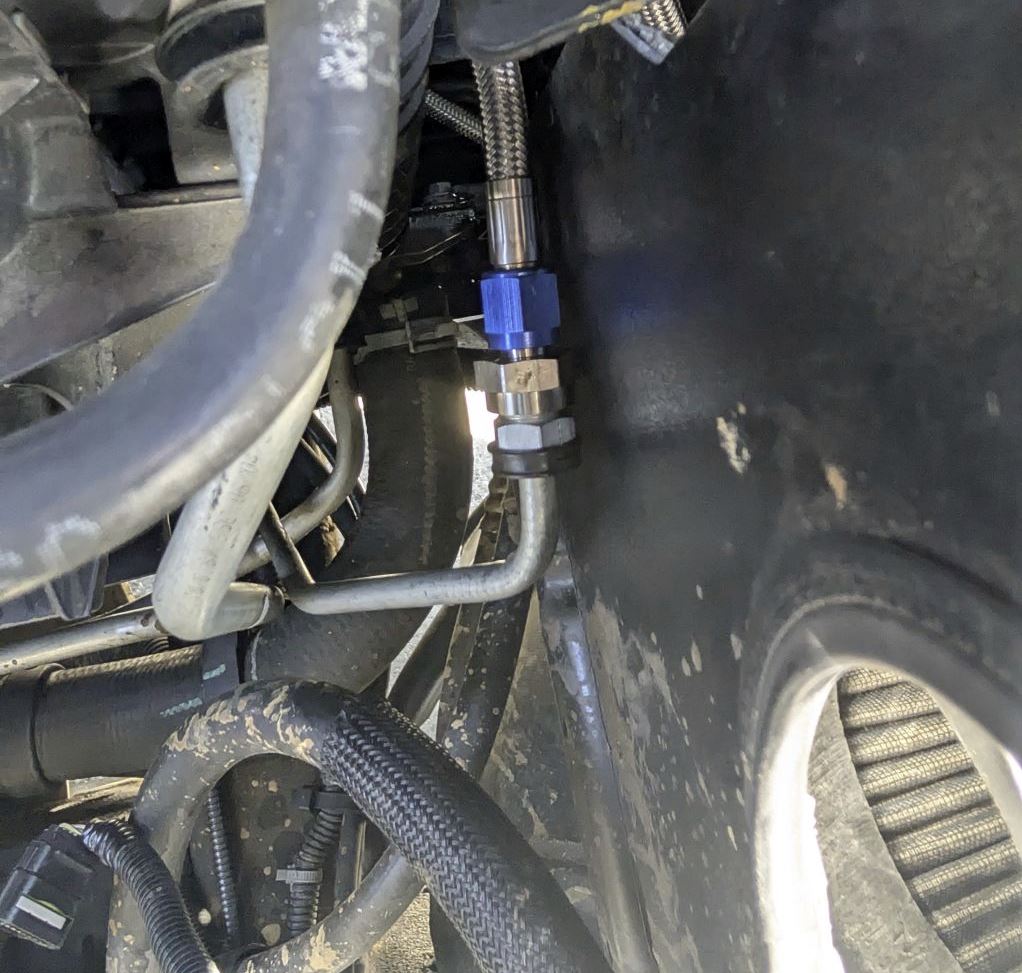

m14x1.5mm to 6an for the left side upper oem connection, you will have remove the oem connector on the cooler and then trim the m14 thread side shorter in order to fully seat. you only need one but they only sell 2 packs
https://www.amazon.com/dp/B0C7ZQQF3S?ref=fed_asin_title
6an to 6an 90deg this connects to the left side connector noted above
https://www.amazon.com/dp/B000CPARHE?ref=fed_asin_title
1 6an hose connects to that and then feeds thru to the trucool
1 oem quick connect, this connects to the factory transmission cooler line
https://www.amazon.com/dp/B0013FFLOG?ref=fed_asin_title
1 5/8-18 connects to the other side of the fitting above and provides the 6an fitting for the 2nd hose to tru cool
this 1st 6an line was 30" and was not long enough to reach the other side of the trucool a 54" worked well and allowed for easy bends/curves
