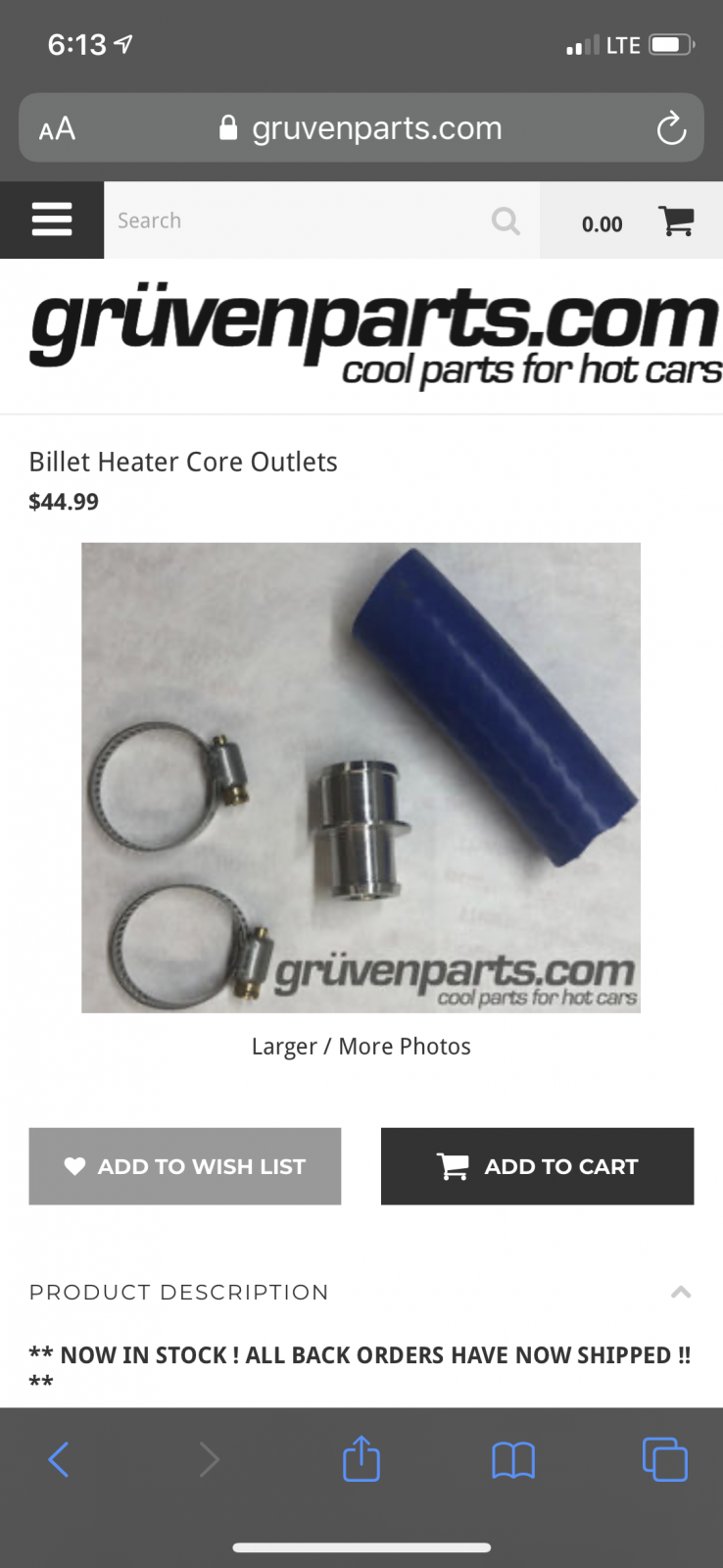

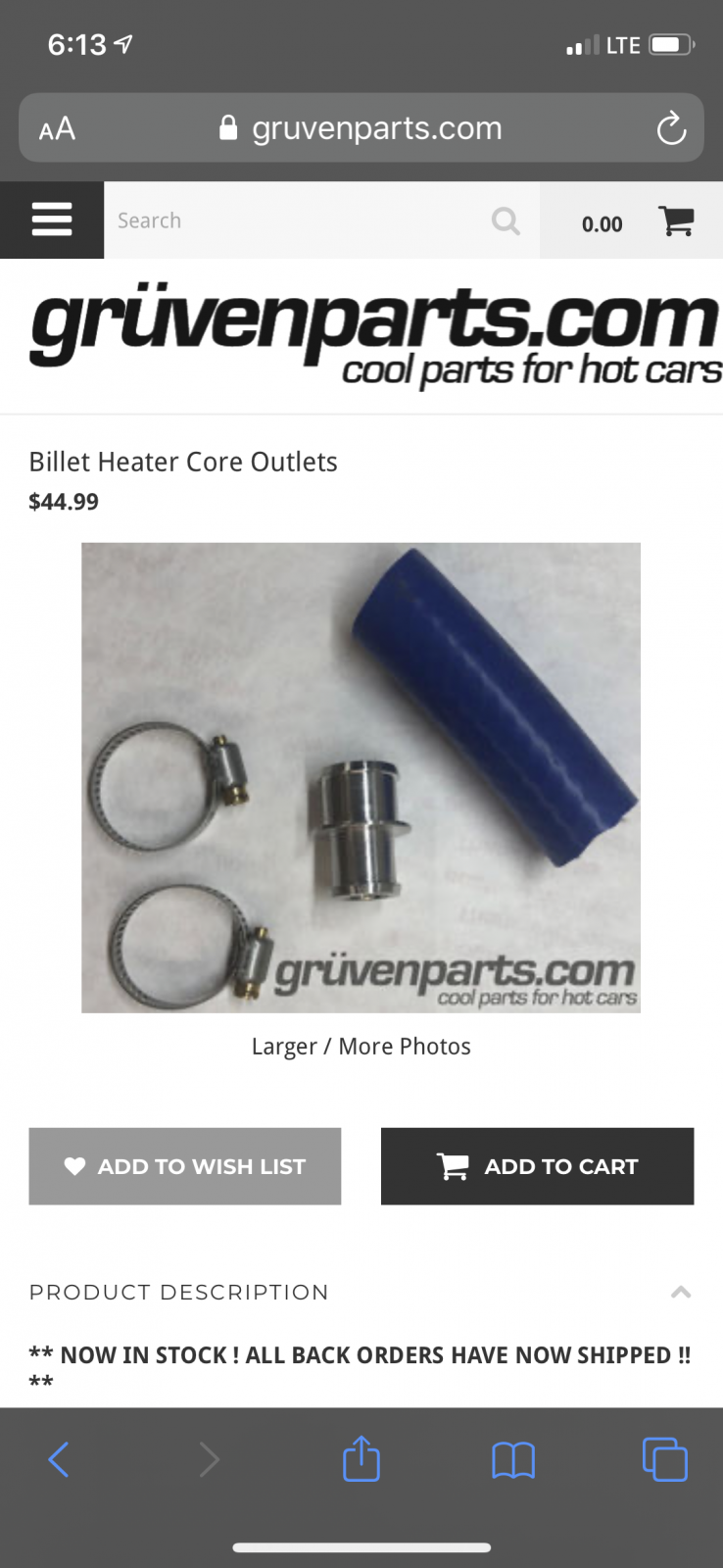

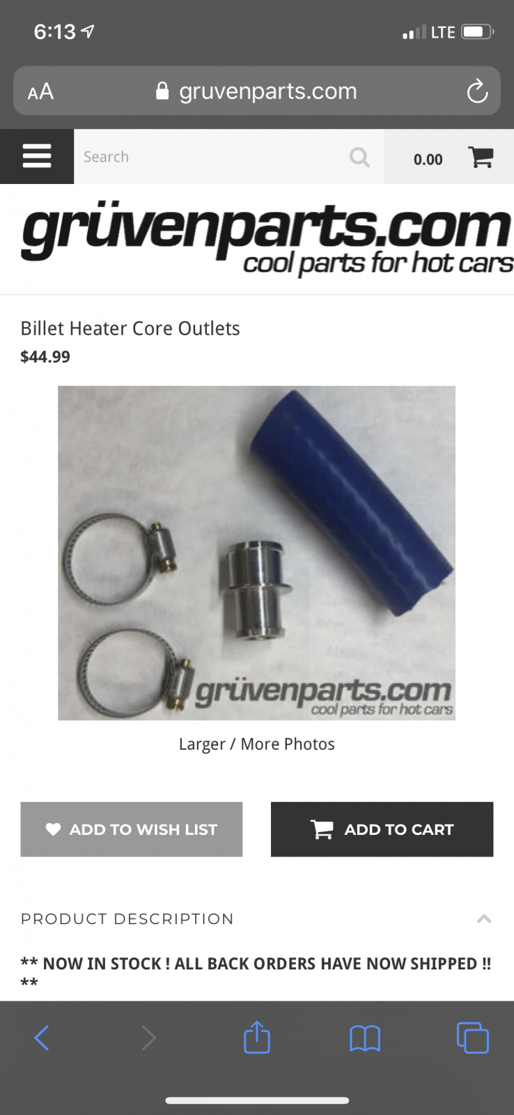

Question for those who have used these Gruven tees. I see that they also now sell billet heater core couplers for these trucks. Should I buy them in addition to the tees? And what about the tee down near the water pump? Can the Gruven tee be used to replace that one too? 2012 Denali with rear aux heat.
View attachment 237890 View attachment 237891
The straight connector is not needed for trucks with rear heat.

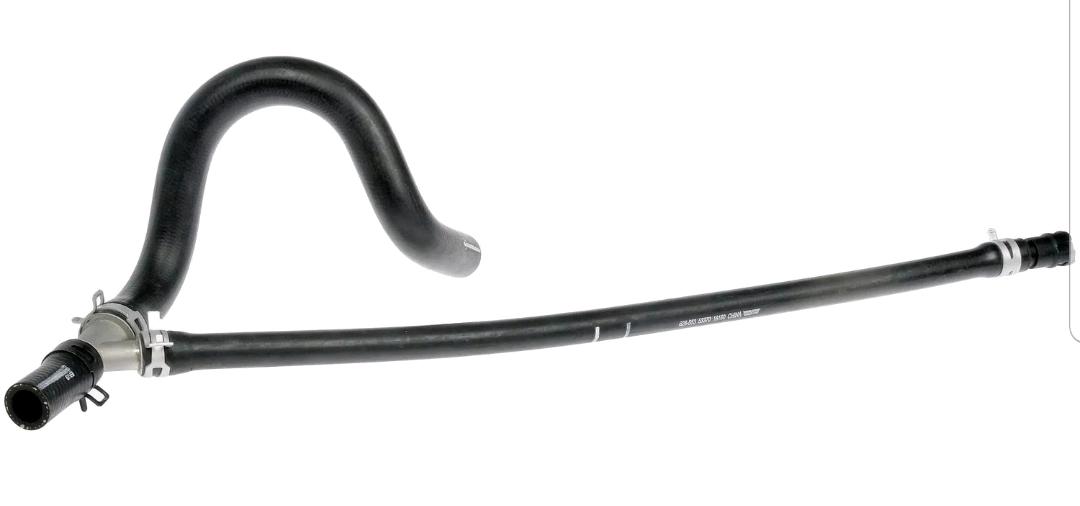

You CANNOT use a Gruven T-connector to replace the Y-connector down by the water pump BUT you can buy the Dorman 626-553 which is a direct replacement made from aluminum. That is what I used.

The only way you can buy it is with hoses. They don't sell it separately, I called Dorman and asked.

Thank you, Ken! VERY helpful. I'll order the Dorman aluminum part with hoses as well.

DARN,:( I wish I would have know about that Dorman hose Dec.24th when one of my plastic t-fittings broke. I had the GruvenParts.com aluminum t-fittings in hand, but I changed that heater hose with one from NAPA, and that Y fitting is plastic.:badidea: I'll buy the Dorman and install that aluminum y as soon as possible

Ok,, so I think i'm going to do the dorman part mentioned earlier for the
single Tee with heater hose assembly.
But, when I look up the heater hose Tee , they list one that's 111 MM and one that's 113 MM... How do I know which I have (without disassembly first). I have 2014 Yukon XL Denali

I assume you are asking about the Dorman part... everything seemed to be of good quality. I used the entire Dorman assembly... aluminum Y-connector, hoses, clamps... except for the plastic quick connect fitting that goes to the factory plastic T-connectors obviously .
