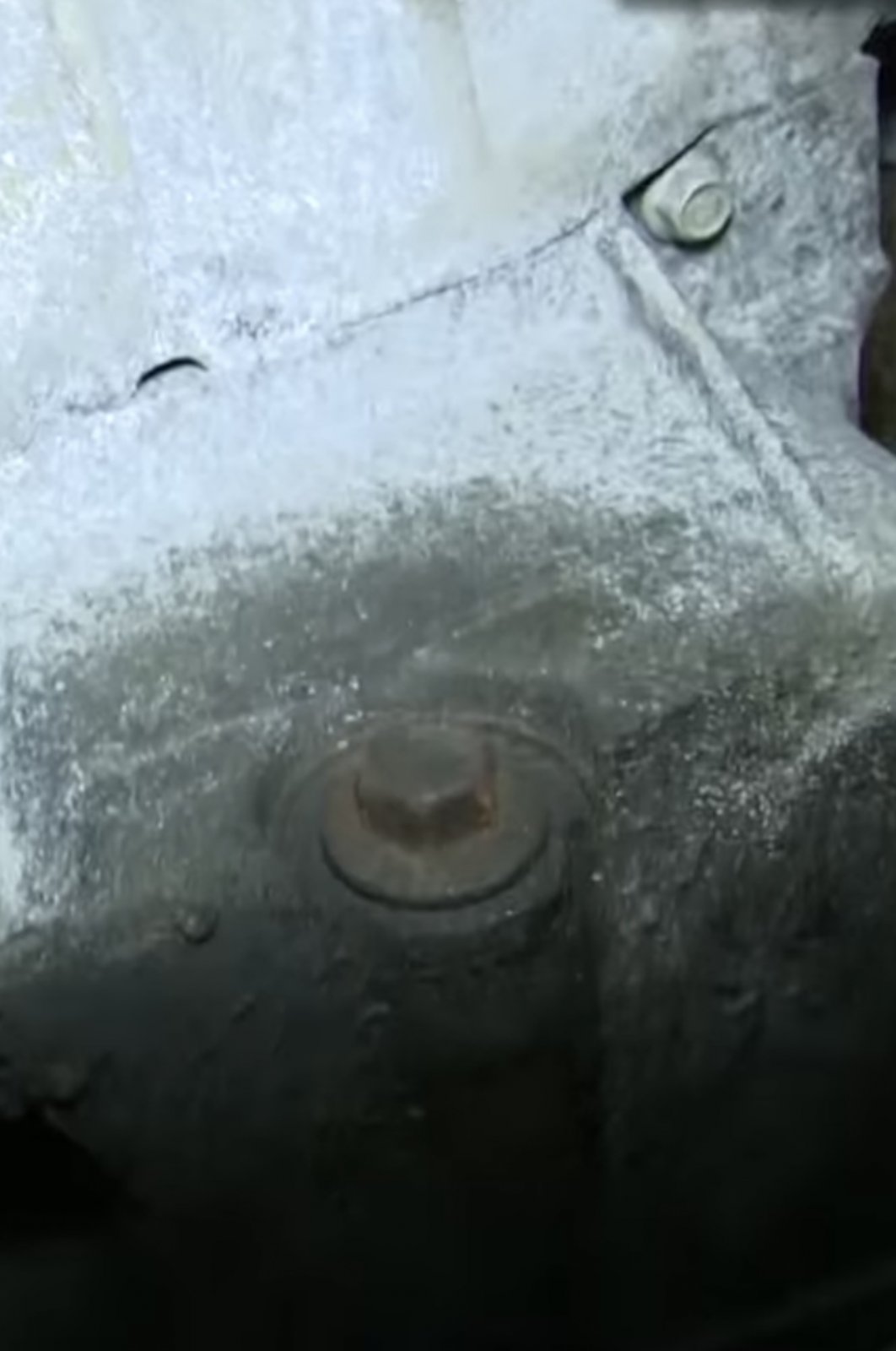

Does it fit well on its own into the recessed oil drain plug on the NBS? Or does it require the extension adapter?
No adapter on mine, I did get the one with a 90* fitting since the drain plug is vertical instead of horizontal, so the hose points straight down.
Edit: I don’t recall my drain plug being recessed ? Pics of yours please.

It’s just recessed ever so slightly, but wanted to assure it didn’t interfere at all with the valve (photo from 1AA)
Is the 90 degree elbow version also adjustable, so you can tighten it well and also position it perfectly downwards?
