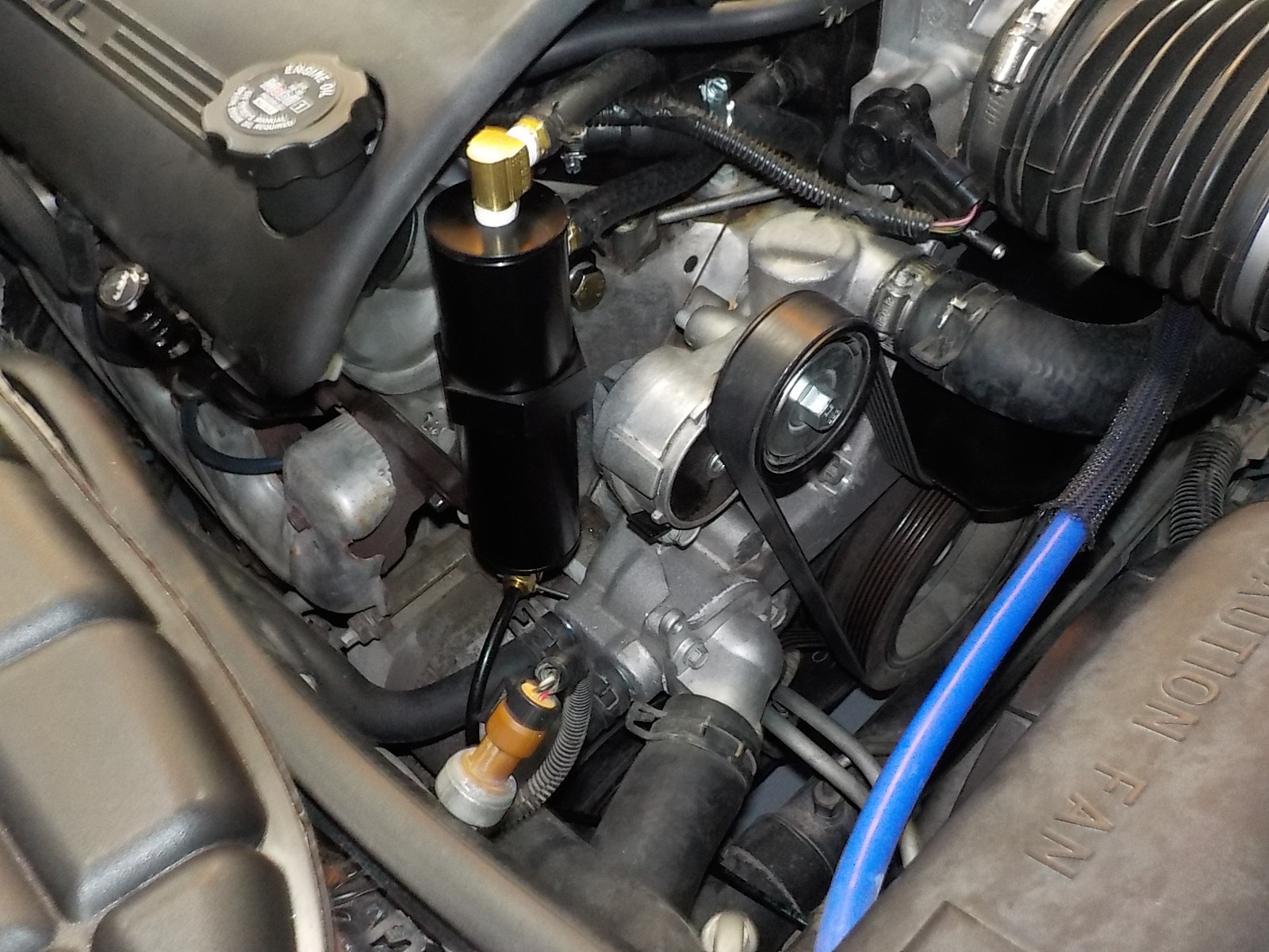

have you considered a catch can on the clean side of your c5? or maybe the clean air separator they call it that replaces the oil cap with a mesh filled housing before running to the air box port? with such low mileage and lack of abuse. I feel like it's gotta be using the half qt thru the pvc system and not the rings?
No
My dirty side catch can doesn't catch much between oil changes.
