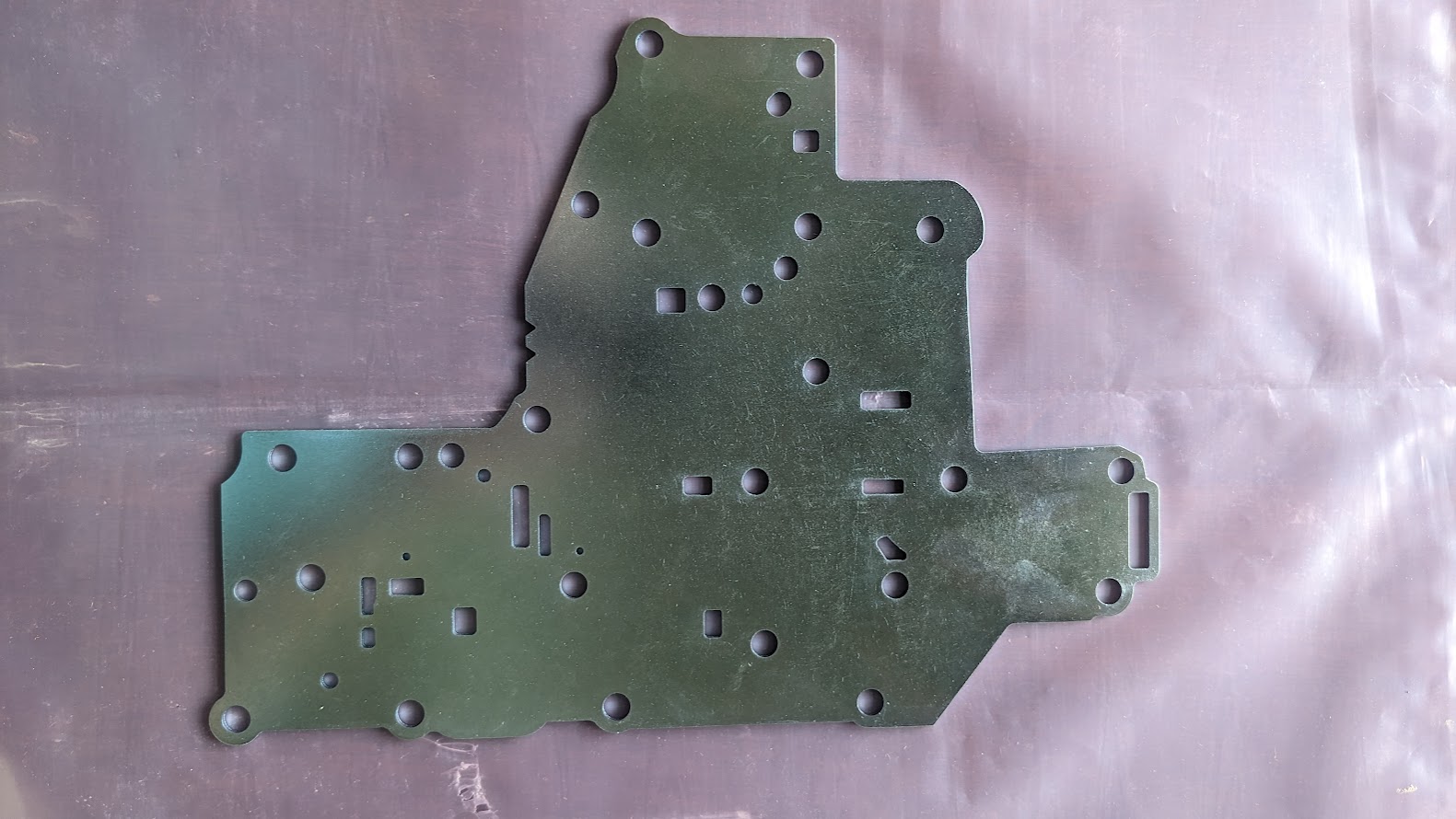

Initial impression of the Project Carbon parts is they appear to be very high quality. The valve body separator plates appear to be made out of 14 gauge steel, 0.0747", 5/64" or 1.9 mm however you choose to look at the thickness. I expect this to be at least 2X the thickness of the OE separator plates. Understand that the hydraulic pressure in this area is probably in the range of around 250 PSI, so thickness matters.

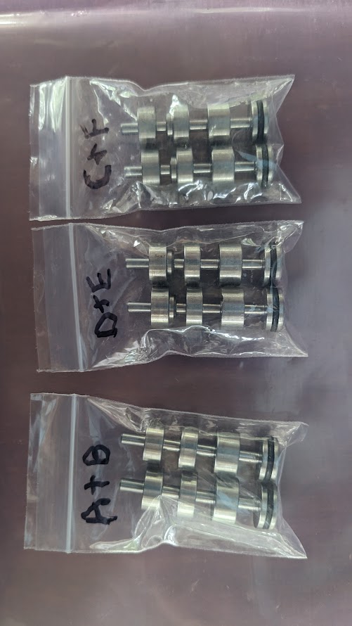

I chose to order the 6 shift valves to hopefully head off excessive valve bore wear and leakage problems. There is no manual shift valve required or needed on vehicles with the "electronic" shifters, only earlier models with the shift cable requires the manual shift valve.
Overall nice machine work on the valves and instructions appear to be fairly straight forward and easy to follow. I will likely be making some notes on the instructions to make sure things are 100% clear when I am in the heat of the moment and I am getting interrupted every 15 minutes!

Now for some eye candy!
