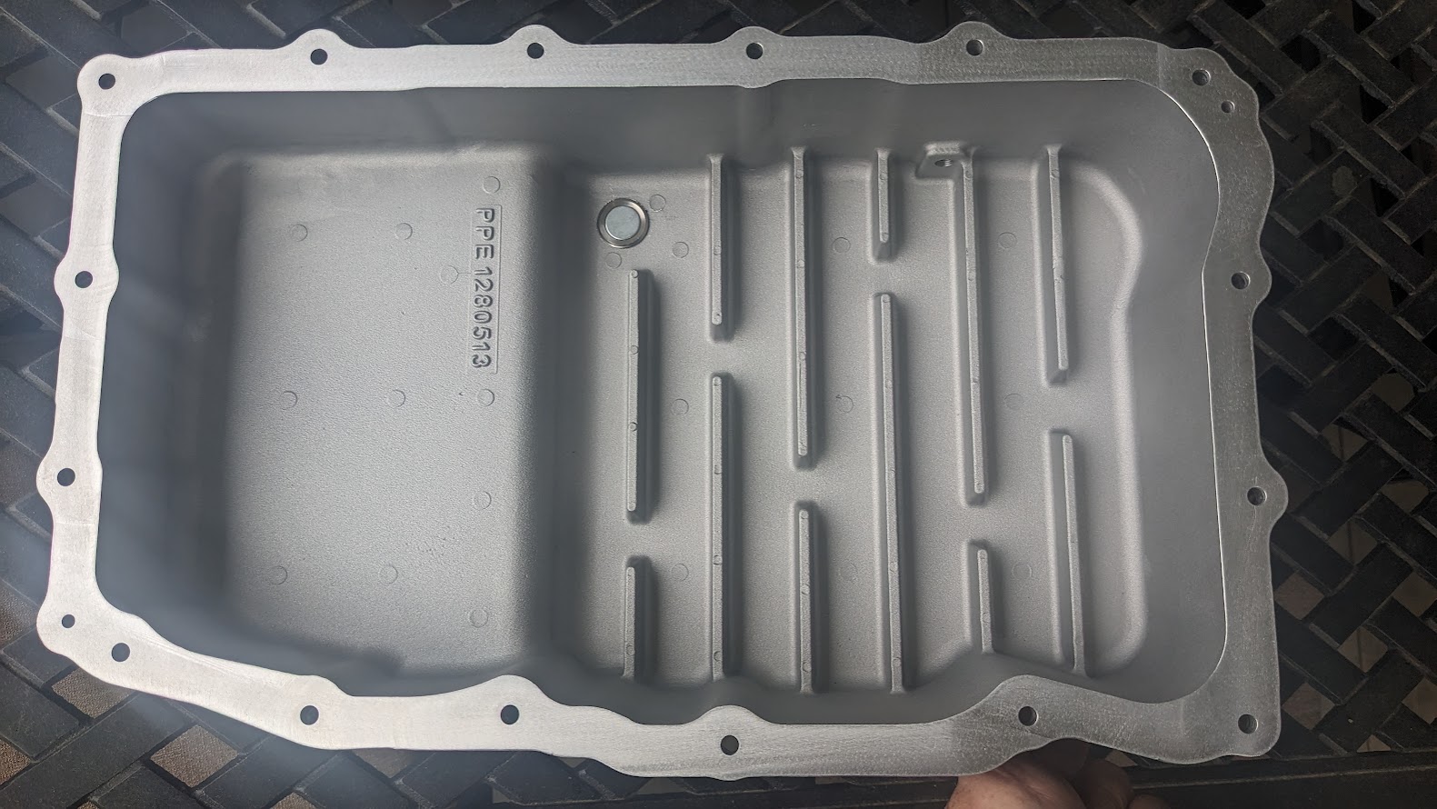

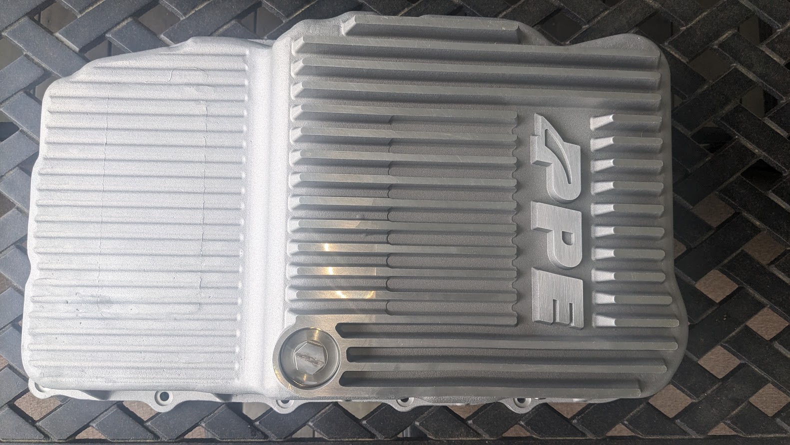

PPE Aluminum Transmission Pan info and pictures. Note this pan is for the SUV's and has the smaller end to go under the exhaust cross over pipe. Some of the trucks use a full depth pan which is a different part number. The SUV pan is PPE part number #128051300. I think this is a newer product, currently only available in unfinished aluminum.
The pan seems to be good quality and weighs in at 12 lbs!!
It has nice machined flat gasket flange with locating holes for the gasket.
Large Magnetic Drain Plug
Interesting internal baffle design that appears to allow fluid to fully drain and not get hung in the baffles
Heat sink fins on bottom area of pan
Holds 2.5 quarts over OE transmission pan
Includes mounting hardware
Also includes a small 1/4"?? threaded side port for an external temp gauge if desired. Might try to figure out a way to set up a fluid level sight glass using this port??

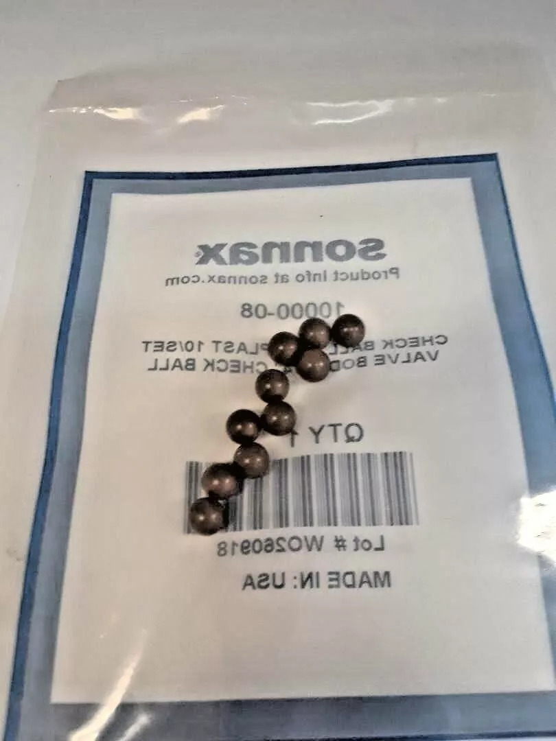

Sonnax Zip Kit and Torlon Check Balls arrived. Decided to swap out the cheap nylon check balls wit hthe Torlon Check Balls. These are overall more durable than the cheap nylon OE check balls that may start to wear over time.
Project Carbon Valve Body Kit should be shipping today. They were waiting on a spool valve delivery.
Is the Zip kit for a gen1 or gen2? I believe we have a gen2 on the 21+ SUVs. I only found a zip kit for the gen1.
Also, where did you find the check balls?
@Kpwweb
You are correct that the only Sonnax Zip Kit I found was for the Gen 1 transmission, we do have Gen 2 transmission in the later models. There were some minor changes between Gen 1 and Gen 2, some in the valve body I believe, some in other areas of the transmission. But there are some parts that are similar. I kind of bought the kit on a whim and figured I would see what it may offer that the NextGen Project Carbon kit did not offer. I did a quick comparison and I think there may be 1 or 2 parts from the Zip Kit that I may consider, but I really need to get the valve body on the bench and inspect the OE parts and the Sonnax parts. Most likely an audible call as I rework the valve body.
For some reason I was unable to locate a Sonnax Gen 2 Zip kit, maybe only AT parts suppliers sell them direct to transmission shops.
As for the Check Balls, I was poking around and found them as an option. They are standard 0.25" check balls. I think I found them on ebay, but I did see them on Amazon for about $9 more as I recall. The check ball kit is Sonnax Part #10000-08. It is a package of 10 1/4" Torlon check balls.
