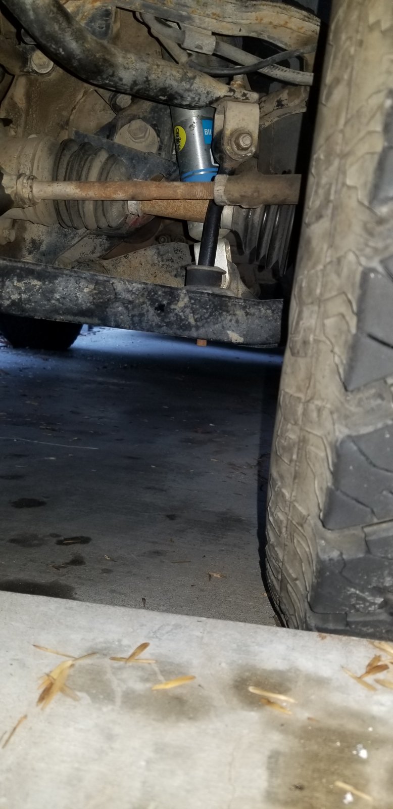

For those of you reading this and wanting a 6" lift, go with a kit that drops your diff!

nevermind! didnt realize you were also the previous post saying which lol
looks like a lot of angle, but no issues?
No issues but I haven’t been in the dirt yet. I have my stock keys up pretty high but like I said….I use the Extended Travel NAPA CV on both sides; so I have an additional 1” of articulation whereas the conventional CV axle would pull apart.
My NAPA axles can extend up to an 1.5” minus the half inch for difference between 2008 length and the total 2004 length plus CV spacer. So an effective 1” of travel beyond what you guys have…so I think I’m safe running higher angles. If I get out on trail and break one then, InshaAllah I’ll add limit straps.
