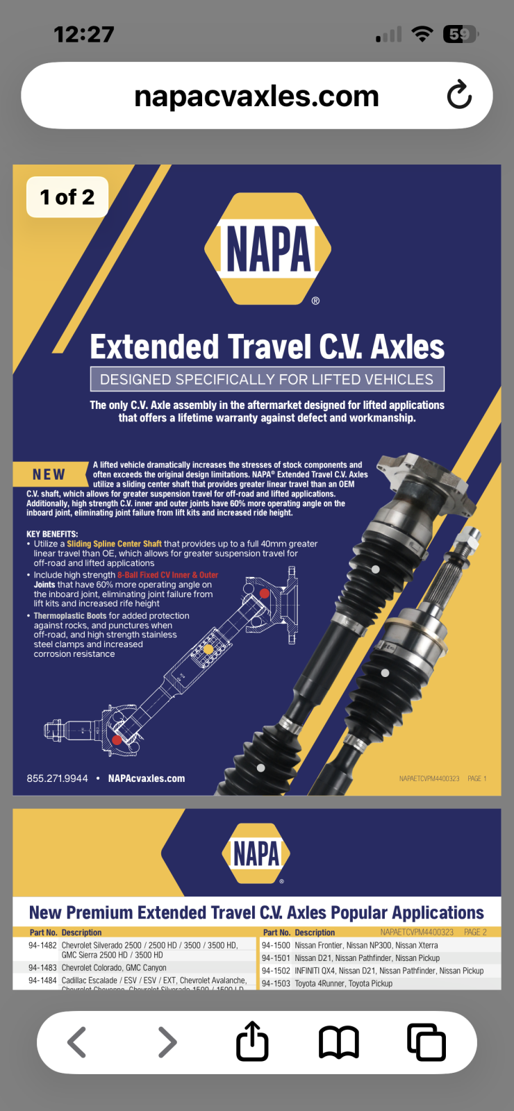

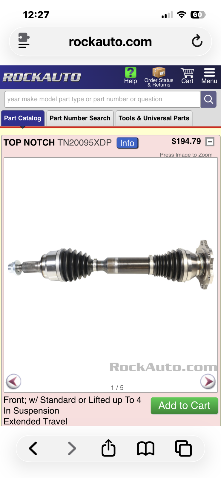

I need to go a little taller on my 2015i gmc Yukon xl.
I’ve noticed the cv axle is what is current limiting any additional droop or lift.
I need to raise the vehicle about 1.25” to get it level. (Z71 suburban height level)
So longer cv axles is what is needed so I can utilize the whole shock. My shocks are essentially 19.5 extended 4.9 travel and I want to toss a level spacer on there until I get new shocks built that will 20.25-20.5 extended and 5.3 travel
Anyone use the trakmotive lifted truck axles sold through Napa?
It looks like top notch sells a similar axle for half the price. But I have never heard of them. So no idea on quality.
Any opinions on these axles?

have you looked at axle spacers?

But my real concern is that it would make the joint angle worse. The trackmotive use a higher angle joint and it also keeps the joints spread to minimize angle at full droop

from the photos of the axle it basically looks like the spacer is buiilt in, I was just suggesting other things to consider. Not sure what all mod's you have done or are doing but shocks alone are probably not going to give you extra travel, probably going to need to do other mods like control arms, brake lines, and even abs sensor harness.
If you are just doing a level kit there is no need for extended axles

I have those shafts on my yukon. 3.5 lift
I don't have enough miles on it to verify longevity but in durability testing the rear driveline grenaded while they remained unfazed.

I ordered the trakmotive ones as Napa had a 20% off and free shipping deal going.
Arrived last night. I’m going to try to install Saturday or Sunday
I’ll take some measurements and see how their extended dimensions work out compared to oem ones.

I should have been more clear, I currently have track motive as well.
RCV's will be installed when I do the long travel kit and 9 1/4 front diff.
