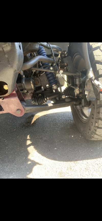

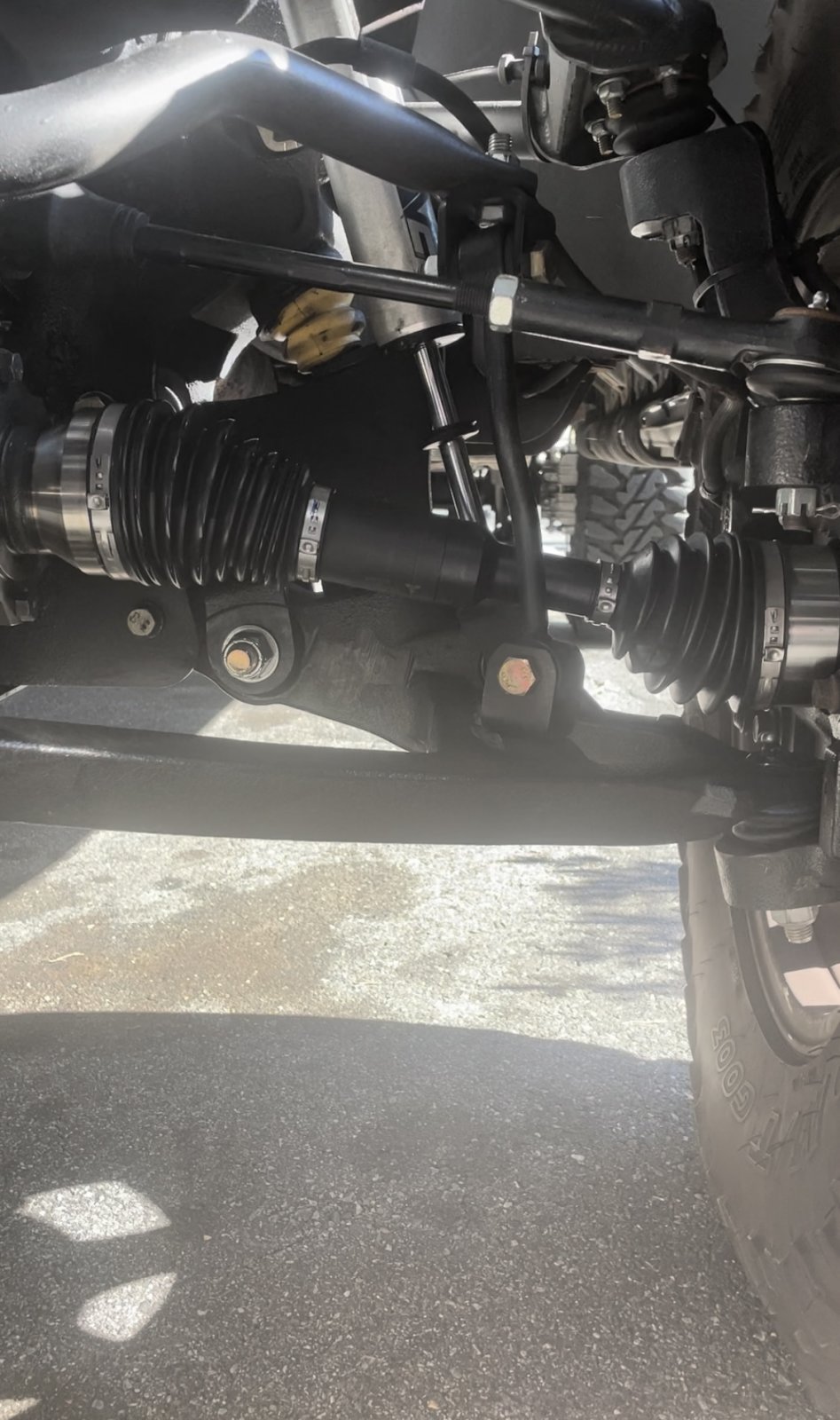

I attached a picture of how it breaks. It’s the same every time. The angle could possibly be too steep so I'm gonna add a picture of it before it breaks and let me know what you think. I was originally on a 3 inch lift and never had a problem like this until this was installed.

ahhh i gotcha, the inside joint(tripod) will just pull out of that inner cup if the axles are too short. the only thing holding them there is the boot really
07+ axles will help, i think they are 1.5" longer than the older ones, probably not long enough to use without a spacer though

Your angle is too great. You must drop the differential and restore proper geometry.
This is our Sierra with a 6.5" zone lift, the axles have basically a stock geometry.

Agree with @swathdiver . IMO, that angle is too large for proper and long term operation of those components.

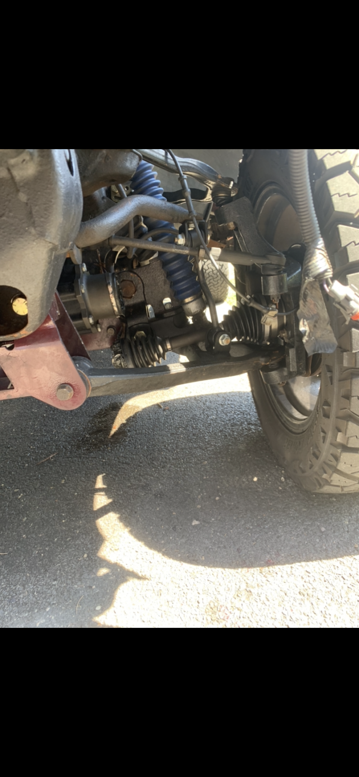

Brian...are you driving on dry pavement with your 4wd engaged? I don't know how you would hear the front tires chirping unless four wheel drive was engaged...Also, I installed Extended travel CV axles from NAPA for my '04 with 6" lift because I have aftermarket Upper control arms and the droop can be fatal for stock CV joints at full droop. To alleviate this I installed (2) Extended travel CV axles from NAPA ….but I ordered 2008 Tahoe CVs because they are longer and it allowed me to ditch the 2” CV spacers that came with the lift (kept the current ones as spares). I think one day I will end up on a trail at full droop and I want everything to stay together. Did you ever find a solution to your problem? I also have my stock keys turned up and am loathe to turn them down more. I haven't broken anything but I also haven't played in the dirt yet...I installed the lift myself back in Sept. 2022.

The 2008 axles under my 2004 Tahoe…no spacers!!

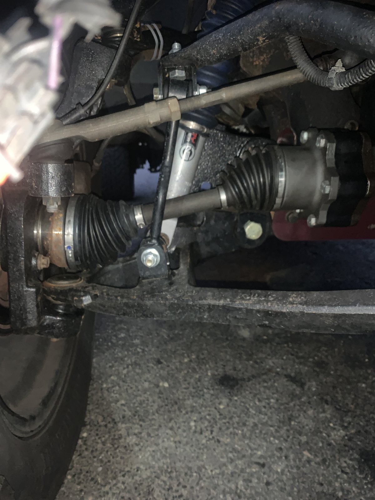

For those of you reading this and wanting a 6" lift, go with a kit that drops your diff!

looks like a lot of angle, but no issues?
No issues but I haven’t been in the dirt yet. I have my stock keys up pretty high but like I said….I use the Extended Travel NAPA CV on both sides; so I have an additional 1” of articulation whereas the conventional CV axle would pull apart.
My NAPA axles can extend up to an 1.5” minus the half inch for difference between 2008 length and the total 2004 length plus CV spacer. So an effective 1” of travel beyond what you guys have…so I think I’m safe running higher angles. If I get out on trail and break one then, InshaAllah I’ll add limit straps.
