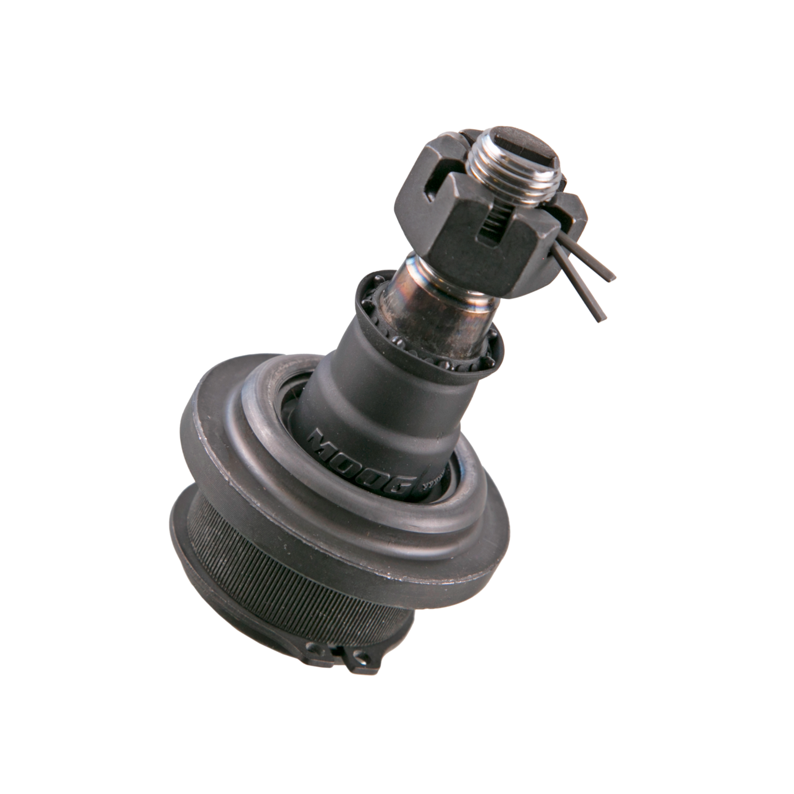

Exact same thing that's happening to the ball joint on one of my Moog lower control arms. Annoying. I'm letting it ride for now, but I know that's a short term strategy and I'll be in there again soon enough. If I can't find OEM, I will replace it with Mevotech this time and see if that's any better.

Do your ball joints have the integrated boot or standard type boot?

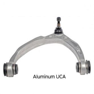

Detroit Axle - a pair of Front Upper Control Arms w/Ball Joint and bushings - $74 pr
Detroit Axle - Front Aluminum Left & Right Side Lower Control Arms with Ball Joints and bushings - $306 pr

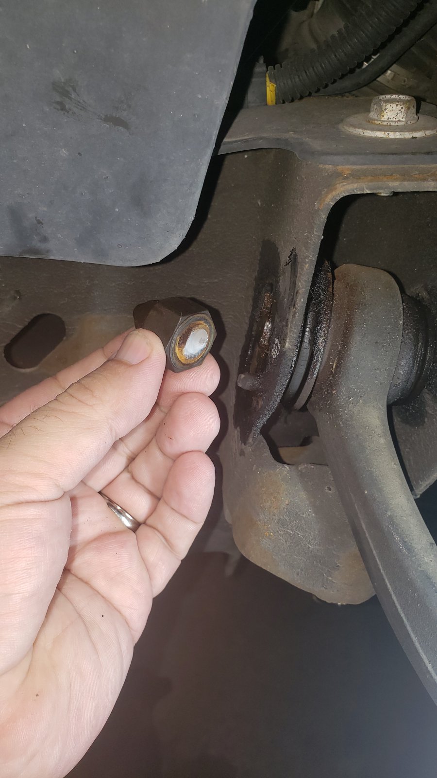

That brings up a good point, pick up either a camber/caster adjusting kit which includes the cam plates and flat sided bolts, or at least get a couple of the flat sided bolts.
I found when removing mine the front most bolt was seized into the bushing and snapped one of them when removing the nut. The other side didn't break but it was corroded and rusty. I replaced both front bolts. The cam plates were fine, but I did clean them up a bit. I also cleaned the area the cam plates lay against and sprayed the area with fluid film or surface shield to help prevent them from corroding to each other.
