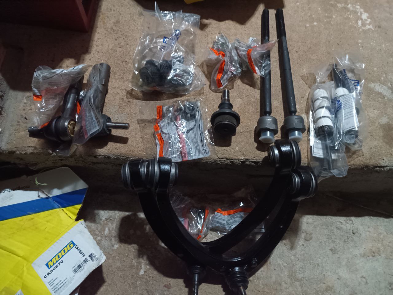

2013 Yukon Denali XL, with 180K miles on it.
This is the kit I got. Am I missing anything? Does the Moog stuff in the yellow box represent their HD line or is it the cheapest stuff?
Thinking about adding wheel hub and bearing assemblies to the list. Does the Moog HD line have good wheel hubs?
Do I need to add these?
Pitman arm, Idler arm and Idler arm bracket - Moog HD line
Center link / drag link
Sway bar / stabilizer Bar End Links

I think Moog's CK line is their top of the line parts.
I don't think your 2013 has a pitman arm or idler arm. It appears the package on the right with the white bushings in the pic are the sway bar end links
