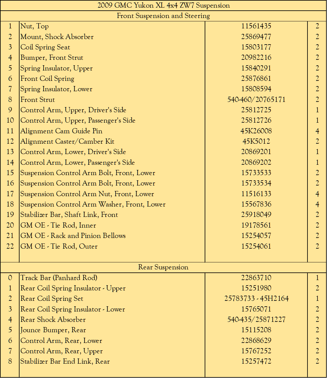

Looking at photos on GMPartsGiant, and other places on the web, the 20869201 driver side and 20869202 passenger side lower control arm assemblies do not come with the new locking nuts. They do come with ball joints and bushings.

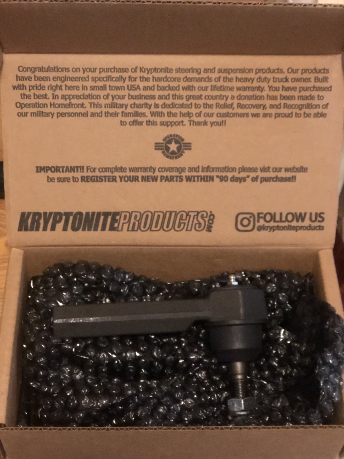

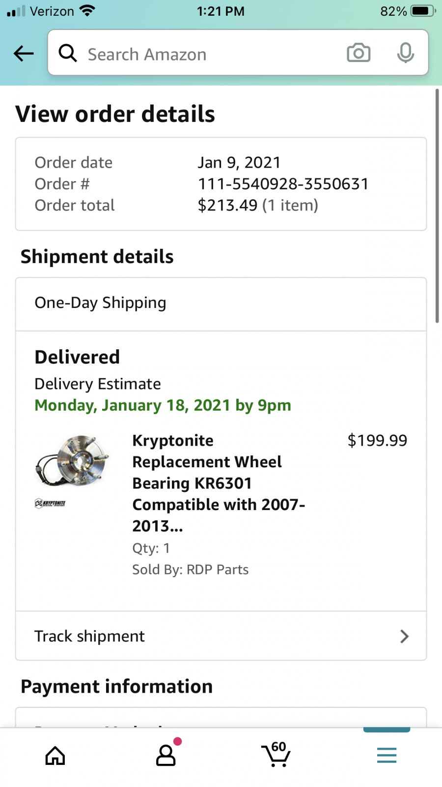

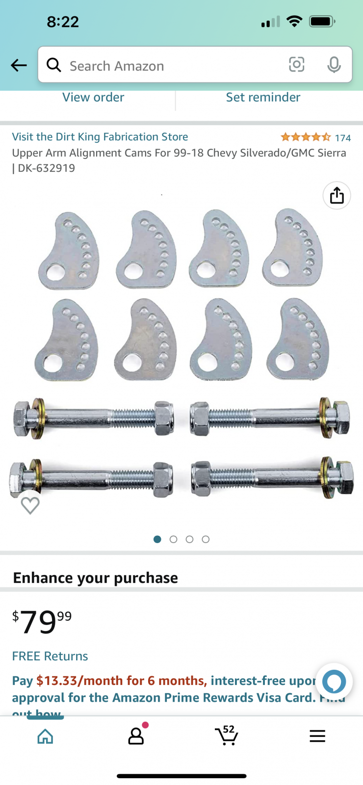

I personally recommend the dirt king fabrications locking cam plates over the stock sliders.
You won’t have to worry about knocking a alignment out of wack with them it’s well worth the 80$ or whatever they are now a days
Also kryptonite products has a lifetime warranty on ALL there suspension parts
I think the kryptonite ball joints were 60$ a piece
I used their wheel bearings also and have had 0 issues after 100,000 miles
I believe the bearings are rebranded Timkens but I may be wrong on that
But even if your rig is stock their stuff is about the best you can get for these rigs
View attachment 418183View attachment 418184View attachment 418185
I’ve had their complete front end kits minus the inner tie rods on two trucks now and my buddy did the full kit on his 05 and WOW what a difference
Yes, when I replaced my front suspension, the nuts had to be ordered separately.

Thanks for the confirmation. Do you remember if the upper and lower ball joints used the same nuts? I can find listings for the lower ball joint nuts, but nothing for the upper.

To to GMPartsDirect.com, enter your VIN, and scroll to the suspension section. You will find exploded parts diagrams which will identify part numbers.
Thanks! Unfortunately, that did not show the nuts themselves. I will keep digging.
