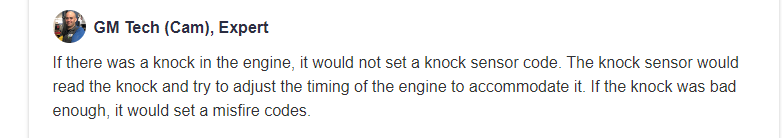

How do you know they arent telling you the truth and you have knocks? How old are plugs and wires?
From what I understand, if there are knocks, then the KS sense them and tell the ECU to pull out timing. They throw the low voltage codes if they are malfunctioning. Maybe I'm miss informed though.
