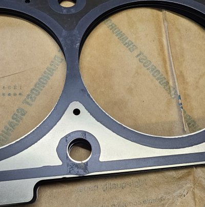

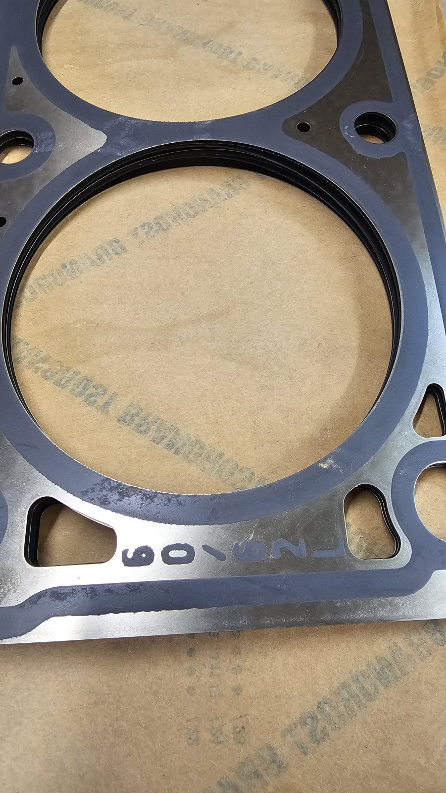

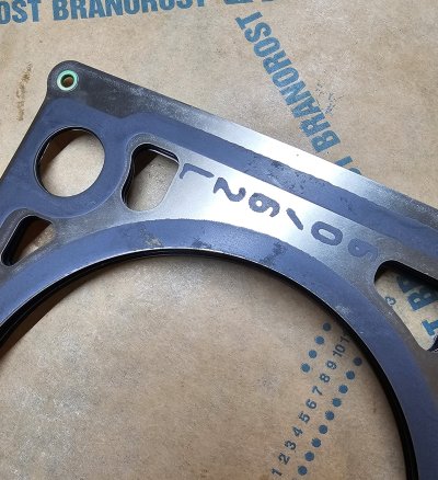

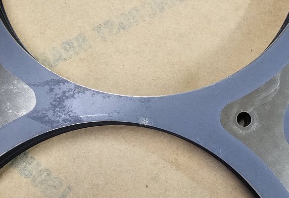

Had to call summit about my head gaskets. The sealing ring sealing parts are a little messed up. Sent some pictures to them and about 20 minutes later a new set is on the way!
