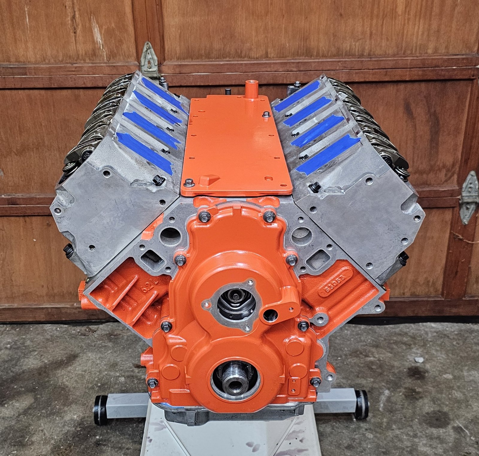

Got the front and rear cover on today and i did use the alignment tools.
Also installed the barbell and pics to let me know i did it in a few weeks.

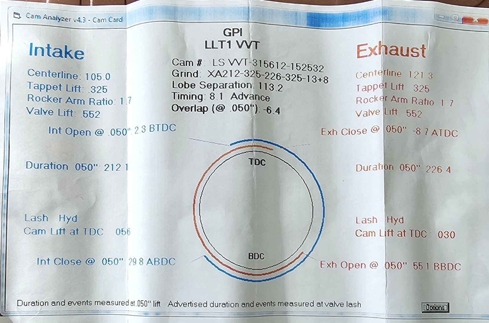

I think it might be the design of the cam.

Your cam card shows 113* lobe separation, that will build compression and give a flat torque curve. Engines that bleed compression usually have 106-108 lobe separation and valve overlap.
Maybe watch your compression gauge while turning the engine by hand to see when the valves are closed and when the exhaust opens? This would only tell you if the cam is far out of sequence
You will need to know where the piston is as you check at bdc and tdc.

I checked that the cam before i put the heads on in post #137. The center lines are correct.
I don't know much about cams but if the center line is correct the rest has to be correct? Lift is also correct measured at the lifter.
