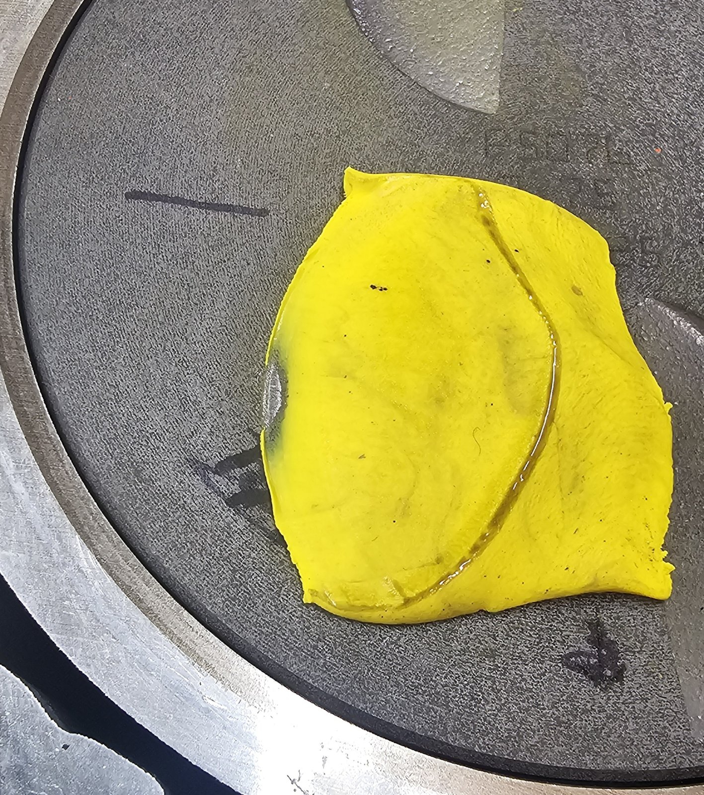

Head or block shaved too much?
Another valve job or shorter valve seats? idk
SpareParts
SpareParts
Sep 17, 2023
2,113
4,803
North Idaho
Less cam lift but that means a new cam or the stock cam.
I think im measuring wrong though.
mikez71
Mar 9, 2023
3,340
4,143
How come it's impacting the opposite side of valve relief in piston?
You'd think it would be angled the other way and smoosh the clay near the center?
