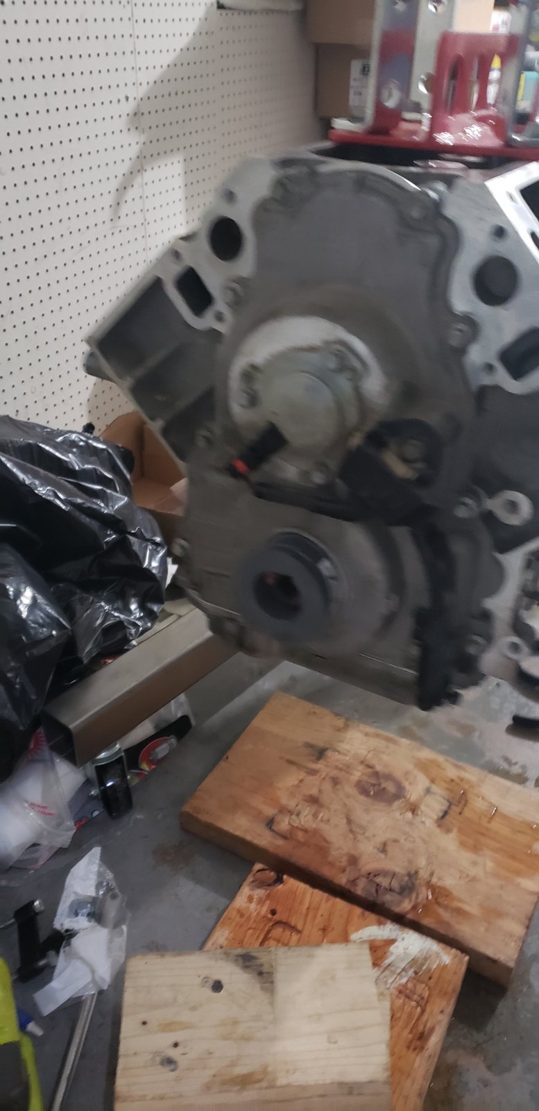

The first picture looked different, but with the better lighting in the other picture i don't see any cracks. I must have PTSD now, haha

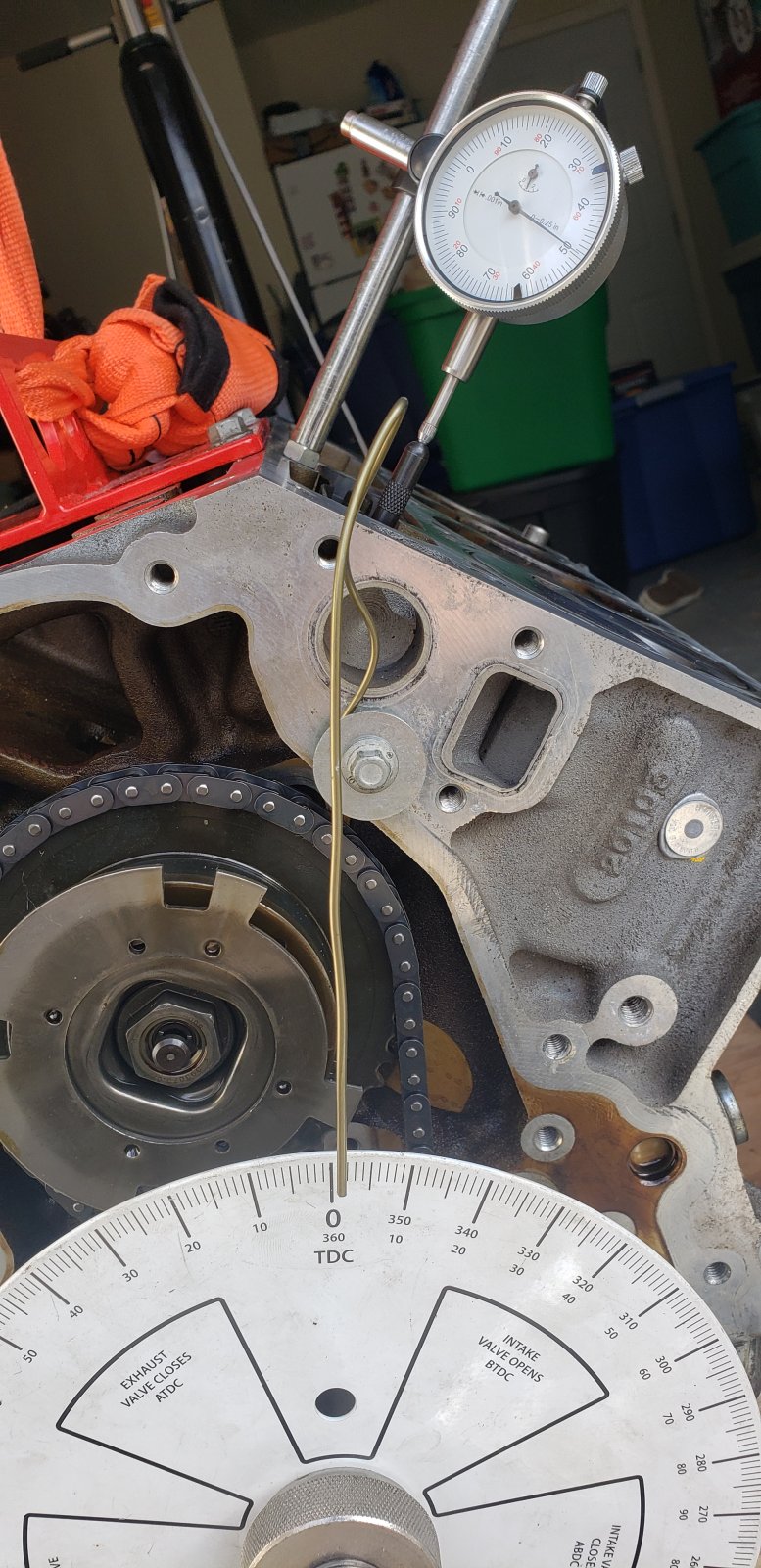

Took me forever to do that, it had been years since I busted out that gear and I forgot how to do it lol. But I needed it done for peace of mind since there is so much conflicting info about VVT and what the base advance is. Now I know parked position = whatever is ground in the cam. I can tune the cam phaser tables now to retard it to 0 advance by the top of the RPM range now and be confident it's doing what it's supposed to be doing.
Tonight I'll finish buttoning up the bottom end. Likely taking off this Thurs and Friday to drop it in. I'm gonna make sure to write down all the torque specs the night before so I can just fly through it.

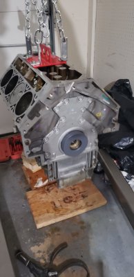

Spent tonight doing
1) Installed cam phaser limiter
2) Installed new cam retaining plate
3) Installed the new TTY VVT cam bolt
I really took my time with the cam bolt because it is difficult to line up the pin and the torque specs are insane. On first try, I screwed up lining the pin up. The nice thing about having the heads off is I can look at the camshaft while I am tightening the bolt. Luckily, I caught that the camshaft was moving but the crankshaft wasn't, so I knew the pin wasn't properly seated in the sprocket.
Tomorrow I will tackle the final part of the block rebuild and that's just the front/rear covers/seals + the oil pan gasket.
Thurs/Fri will be installation.

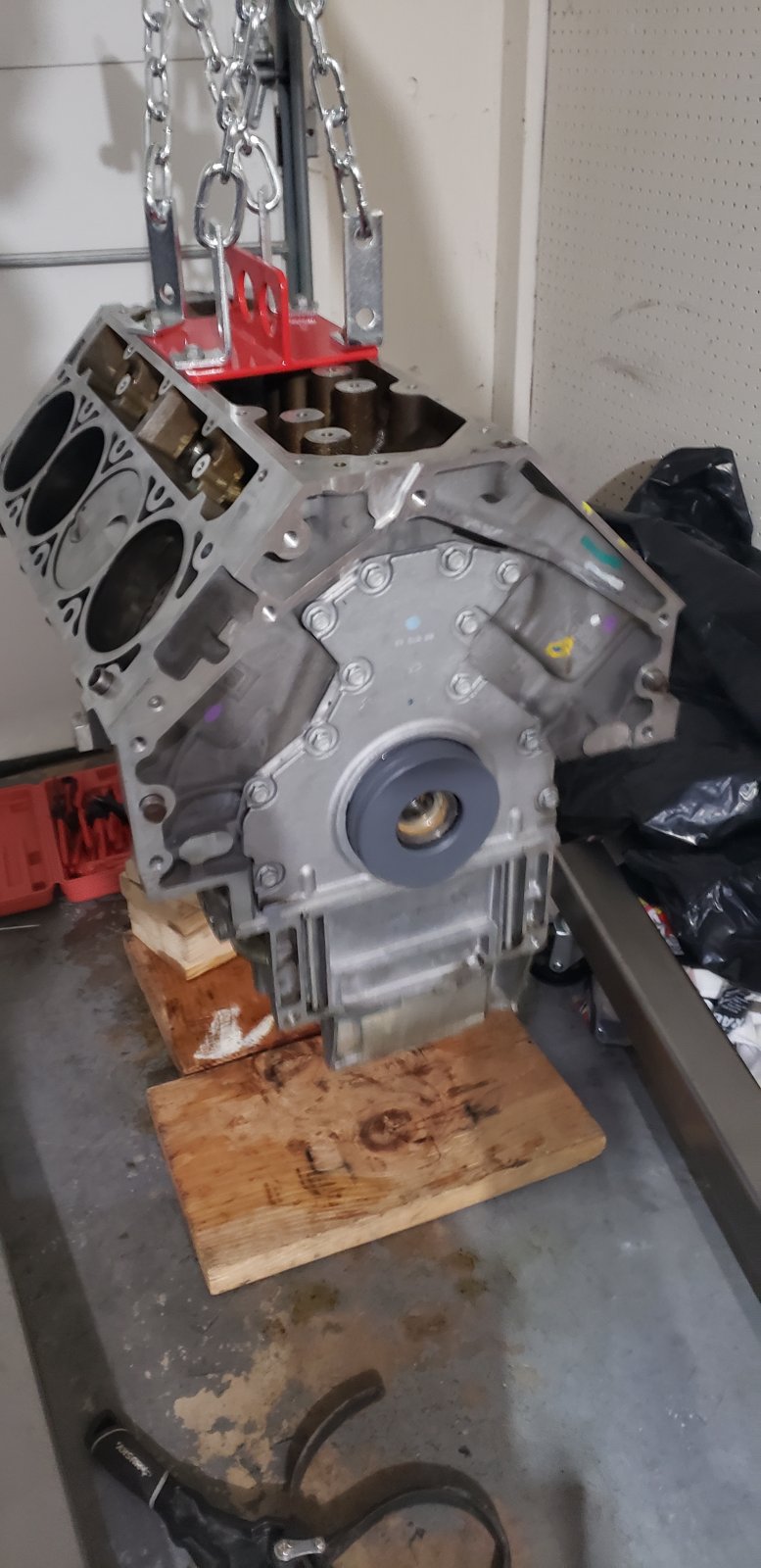

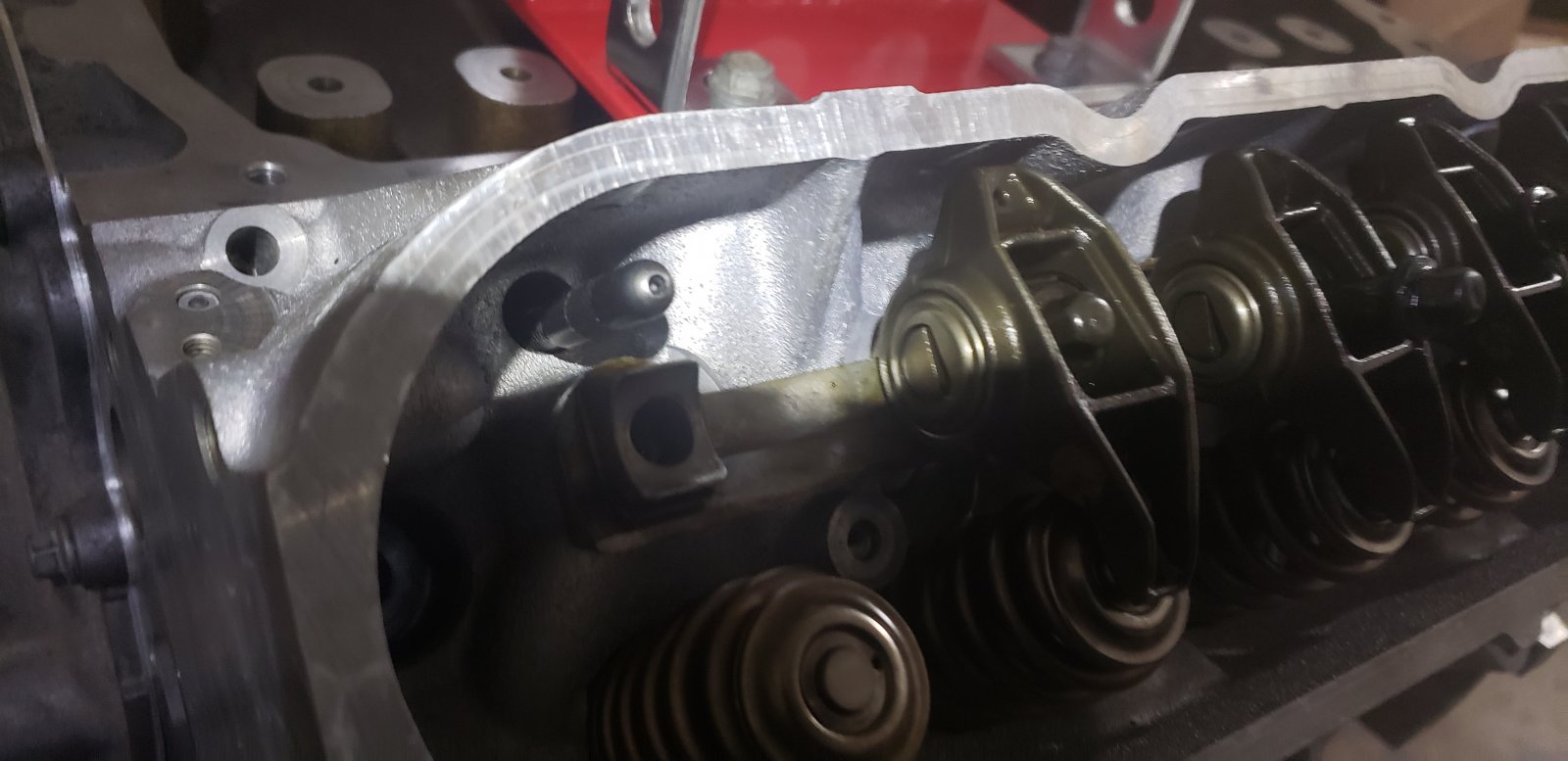

Tonight's progress.
-Front and rear covers with oil pan gasket. Used the Mr Gasket alignment tools.
-New front/rear seals
-New barbell oil plug and new freeze plugs in every location. I only left the one behind the front cover alone, didn't want to mess with getting that out since it's pressed in tight.
-Installed all 16 Johnson lifters
-Measured for pushrod length with no head gakset. Came out to 7.225". 7.225 + .040" gasket + .045" recommended preload = 7.310" pushrods. I have a set of 7.325" laying around, so I will use those to put me at .060" which is still within the plunger range. I will remeasure once the heads are on and torqued down. Worst case, I will overnight a set.
Tomorrow I will begin pulling the old engine out. Sucks my torque converter delivery missed, it will suck if it doesn't get delivered until late tomorrow.

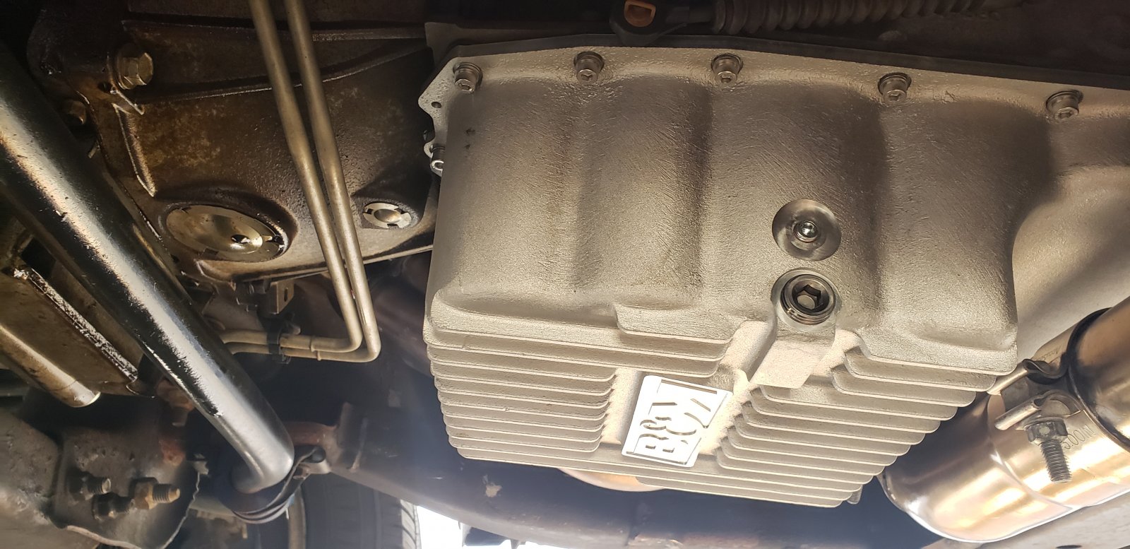

So since my torque converter still hasn't delivered, I decided to just tackle what I thought was a simple transmission pan swap. I didnt want to start my engine teardown then the torque converter gets lost or something. No idea whats going on at Fedex keeps saying being delivered then an exception but I am home all day. I am going to have it dropped at a walgreens.
Anyway, so I go to swap the b&m pan on. Everything is going well. Got the old fluid out without making a mess.
I go to torque the pan on.
Problem #1. Missing one of the bolts.
Problem #2. The bolts they provide are way too long. They were bottoming out way before the washer hit the pan.
Problem #3. The stock bolts cannot be used! They are too wide.
Problem #4. My Yukon is my only vehicle while wife is at work.
Problem #5. My Kooks y pipe had no clearance.
So I hopped on my nice Trek bike and went to the hardware store. They didnt have any button head bolts, so I picked up 36 washers. I then tripled up the washers on the b&m bolts and just left one hole empty. Its not leaking so far but first thing tomorrow I will go get some new bolts and replace them.
The Kooks midpipe problem was a ***** because theyre slipfit and were the biggest PITA to separate. I spent an hour with a torch and peneteating oil and finally got them apart.
Then I went to get my exhaust expander and the oring that holds it together broke lol. So I could not expand the exhaust to make it easier. I ended up just cleaning it as best I can and applied grease to the connections then I just forced them back together. I was able to get the clearance I needed which was a relief. I was thinking maybe the pan was only designed for stock but luckily it clears.
Its a real nice piece I just wish they sent the correct hardware.
