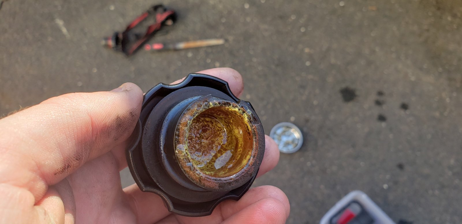

Also, I am leaking oil like crazy. Its either the oil cooler lines or the oil pan gasket. Also the oil cap was very milky, I hope its not coolant getting in the oil. The truck has mainly only been used to drop my son off at school and I havent changed the oil in a while since im doing the 6.2 swap soon anyway. Im wondering if maybe its just old oil combined with truck not running hot enough on regular basis.
Do not like. Good thing you’re already swapping that motor!

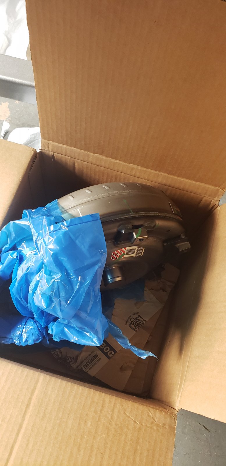

Doing my first converter install. Apparently there are possible shims I may need to put in?

Ok saw some videos about the torque converter spacing. Makes sense.
Anyone know a good source for shims I can get quickly in case I find I need them?
45,014
My Circle D converter came with two thicknesses of shims (washers) and one of the two sizes was just right. They're just washers of a good quality that are consistent in thickness. You should be able to find what you need at a well-stocked hardware store. Different grades and materials of washers will be different thicknesses. A digital caliper is your friend here. I used a drop of hot glue to hold the washer to the end of a drill bit so I could position it until I got the bolt started. You gotta use thread locker on the bolts, so plan ahead.
