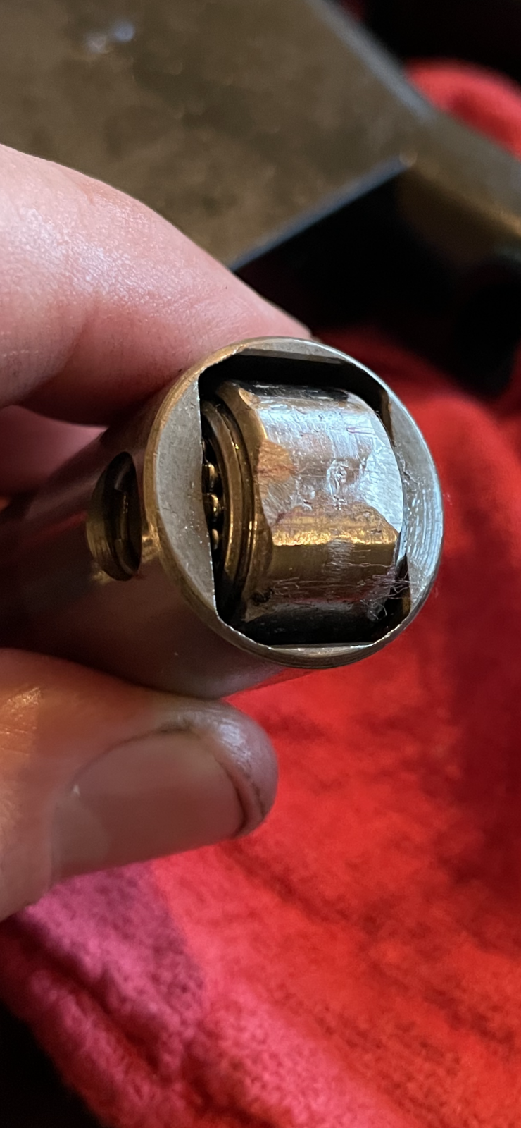

We have our smoking gun. This lifter is from the #2 cylinder and was starting to fail the exact same way that the Vinci lifter failed on the first cam swap. I believe what’s happening is I made the mistake of reusing the lifter trays from Vinci, and they do not hold the lifter well enough to keep it from rotating slightly as it moves. You can see the chipping damage which is present on the complete circumference of the lifter wheel. I have new Chevrolet Performance trays on the way, but unfortunately the cam will have to come out. Moral of the story: use OEM lifter trays.
Do you think the lifter trays were the original problem, even with the Vinci hardware?
That’s a good question, thanks for asking. But it’s starting to look that way, unfortunately. From everything I can find, that type of lift or roller damage is from sliding along the cam at an angle.
I hope you don’t mind that I haven’t gone back to reread the early days, but did he ever bring up the trays as a possible source of the failure?
No. I raised it to him as a possibility given the unique damage signature but he was convinced it was a piece of debris that did it. Funny thing is that it’s easier to twist a lifter in that particular tray slot than it is the others, too.

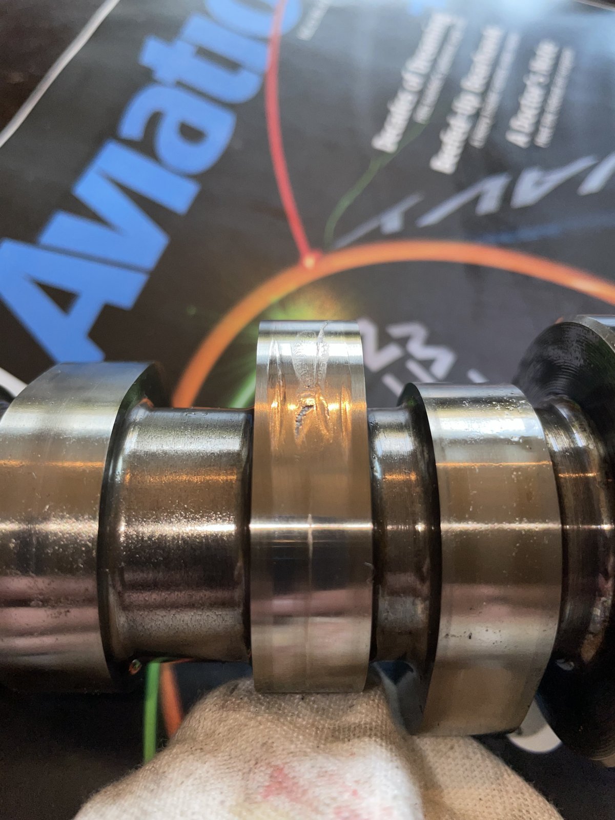

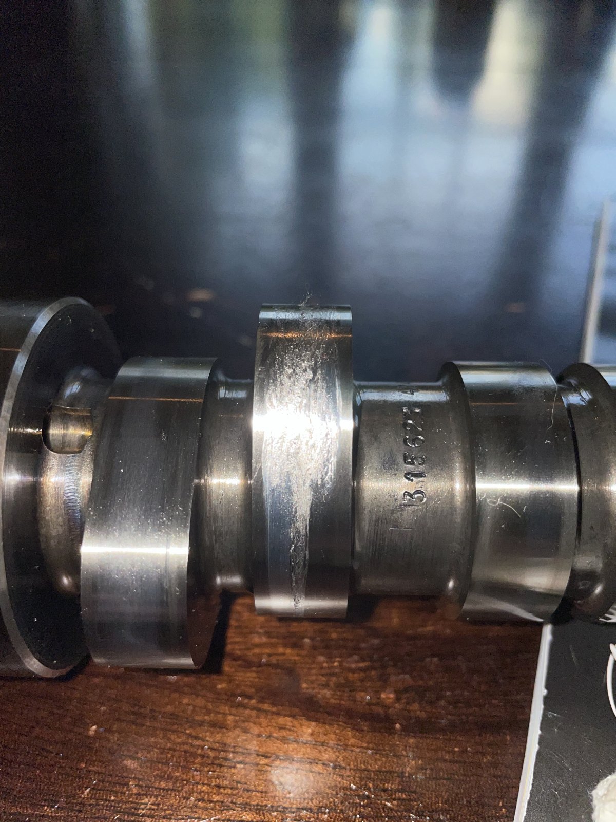

Got the cam out this afternoon. Only that one lifter showed any damage, except one of them that had a small circumferential scratch around the roller, but hardly noticeable. However it corresponded with a second lobe that had considerable damage - looks to be from a piece of debris - possibly one of the chips from the failed lifter. Cam bearings look good.
Lobe with the damaged lifter:
Lobe with the fod damage:
Now I’m worried about debris in the rest of the engine. Whadda y’all think?
