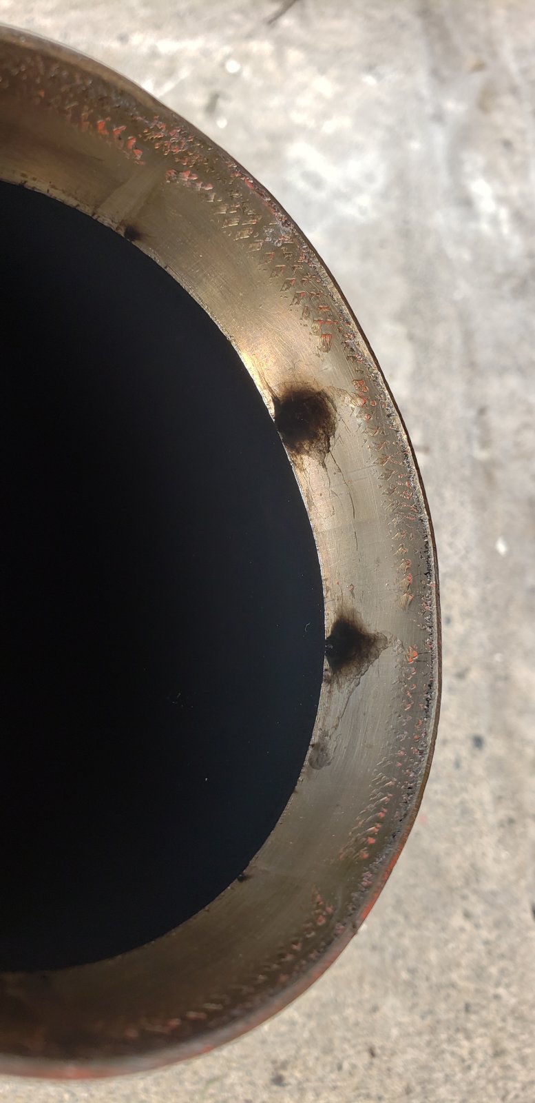

I am still waiting on my camshaft, probably another 2 weeks, so I figured I would try one more time to seal my y-pipe. I can see why it leaks and I took a picture. There are deep ridges all over where it is supposed to seal. This would be impossible to seal metal on metal. This is likely the source of the annoying noises in the cabin under load. It already fails the vacuum + soap spray test. I can only imagine when real exhaust is going past it. Probably flying out.
You'd think after spending this much money, the exhaust wouldn't leak. Disappointing.
Whose headers are those? Both sets of ARH I bought didn’t have that.
Kooks 1 7/8". I sanded the ridges down a bit by hand. I just put it back together and did the vacuum test and and it's leaking at both ball sockets and each slip fit joint. When I do my engine, I am going to use Optimum Red RTV which is good to 750 degrees.

They have many. I tried rtv copper but it blew out.
I sent pics to Kooks and they think its a defect and are requesting i send the headers back.
Likely I will do so.
I was going to say they stand behind their stuff. I actually bought a brand new set of their 1 3/4” with non-catted y and couldn’t make them work without cutting on my bagged and bodied Silverado so I sold the headers. Still have the y if you know anybody that might want it. It’s in the classifieds.

Ok I'll check it out. The header ticking ruins the vehicle for me. Definitely adds power, but it's a part throttle type vehicle. I don't want to go WOT all the time to enjoy it. I've owned a few LS cars and don't recall ever hearing the headers this much in the cabin. I think it's because the Y pipe connection is right by the firewall instead of further back if it were a car. Its fairly quiet outside, but you really hear it when the windows are up and A/C is low/off.

Header noise is less pronounced after i sanded the areas. Im confident Kooks will be able to fix it and ill be set.
When I do the swap ill put on my stock exhaust and ship them out to them.
