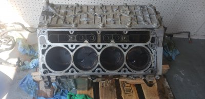

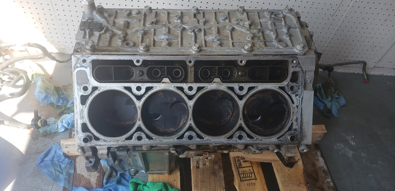

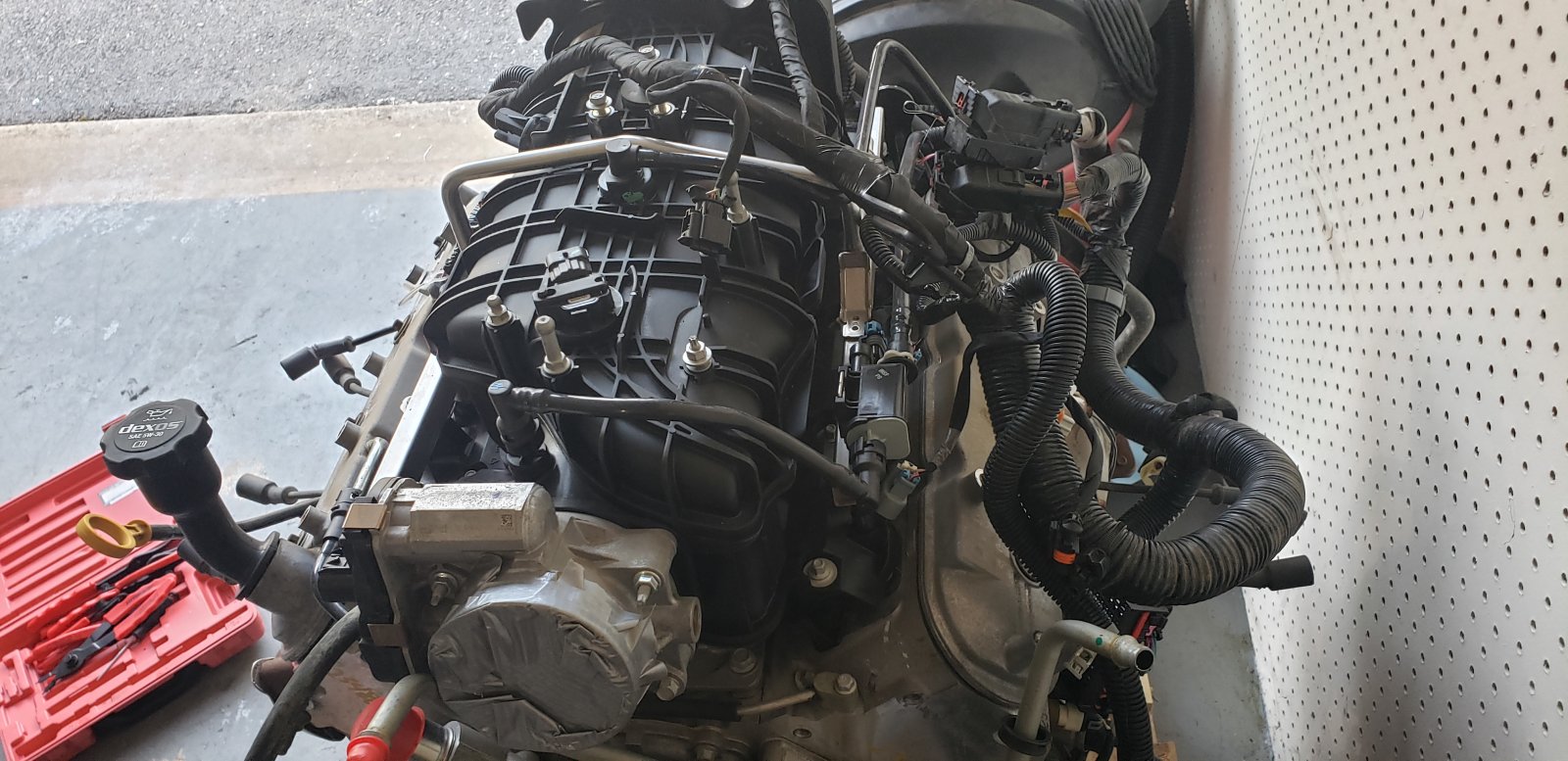

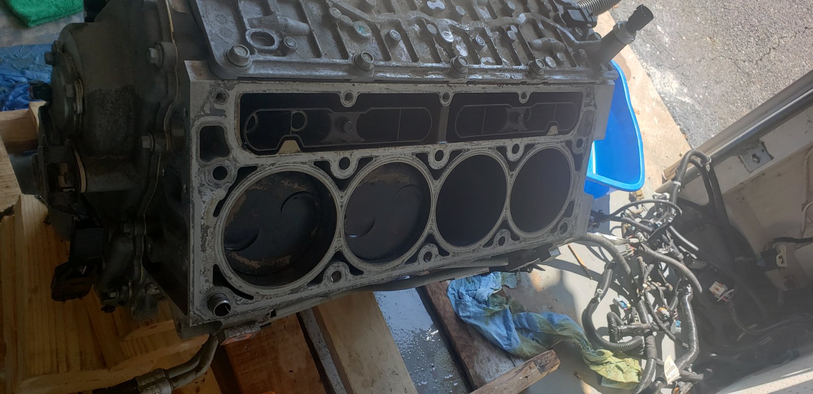

Today I began tearing down the engine. Still need to buy an engine stand and a hoist, but for now I just tore it down ontop of the crate it came on. I removed the topend as well as the wiring harness.
It came with an engine block heater, so I need to figure out what to do with that.
I also spun the engine over by hand and it seemed scratchier than other LS motors ive spun over when I pulled the heads, but all of those were inside the vehicle which may have hid some of the noise IDK.
I took a quick video after doing some initial cleaning/lubrication of the cyl walls

lookin good! it should be a strong runner with that cam...keep us updated

Today removed the flexplate. Engine now spins over silently. False alarm on the scratching noise.
