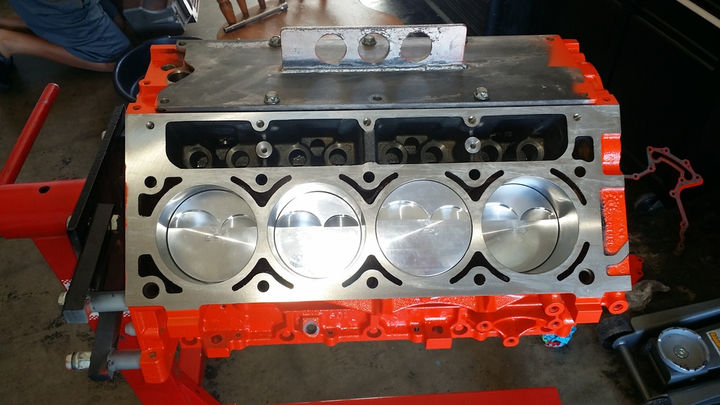

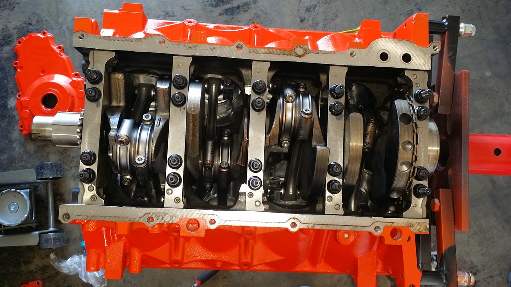

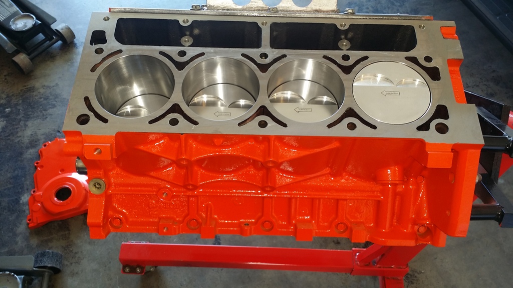

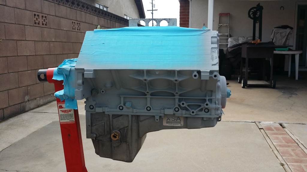

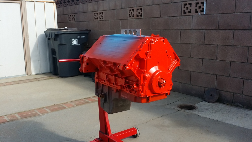

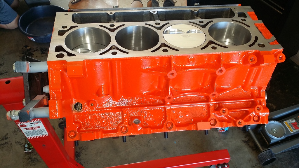

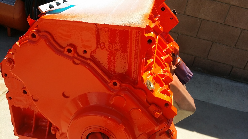

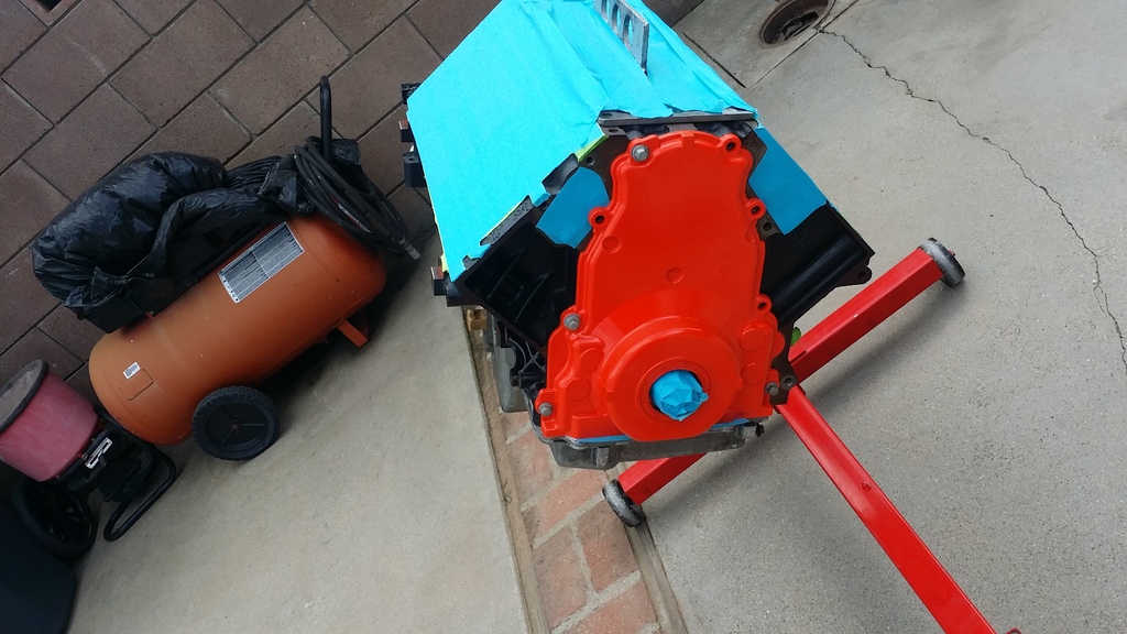

So I finally picked up the short block and did some painting I think it came out very good.

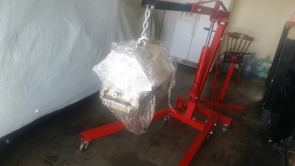

This is how I pickled up the motor all wrapped up for me

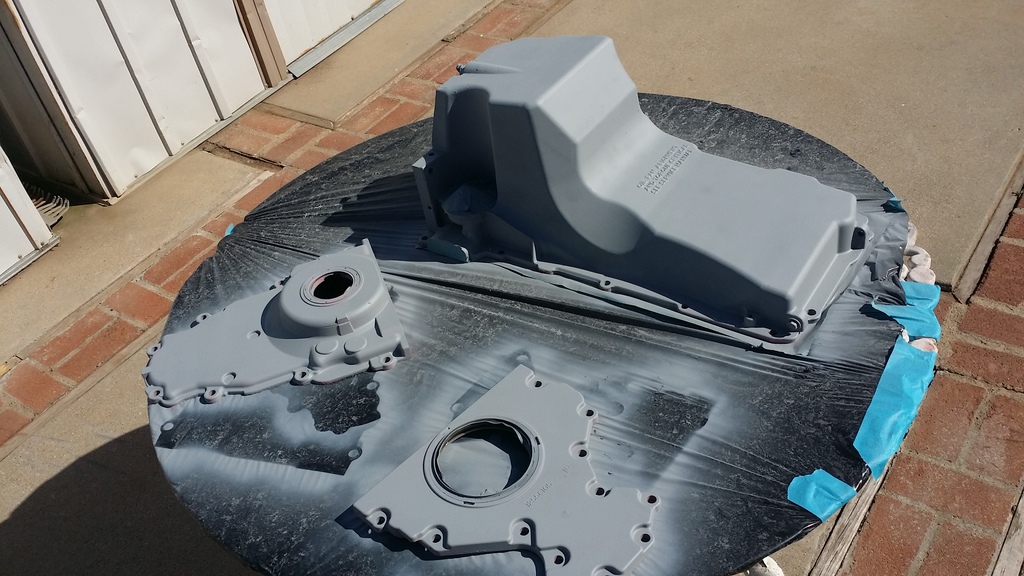

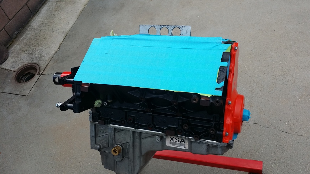

Spend about 1 hour making sure I masked everything and about 3 rolls of painters tapes, Wanted to make sure their wasn't any over spray inside the engine. It was easier for me to put the rear and front covers on I didn't feel like mocking up a cardboard template, so I went this route. The front and rear Covers are gonna get painted black to add some contrast
Here are the pics
3 coats of primer
2 light coats and one medium coat
then 3 coasts of Chevy Orange

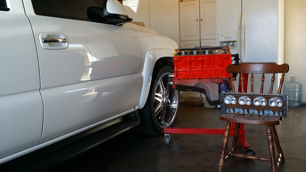

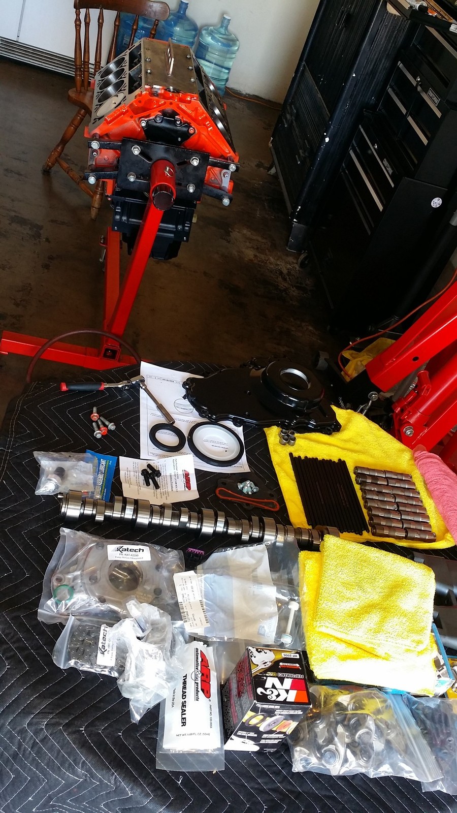

Waiting on the new heart Transplant
the goods
This is were I left off, Tomorrow hopefully if i have some spare time I will paint the oil pan black.

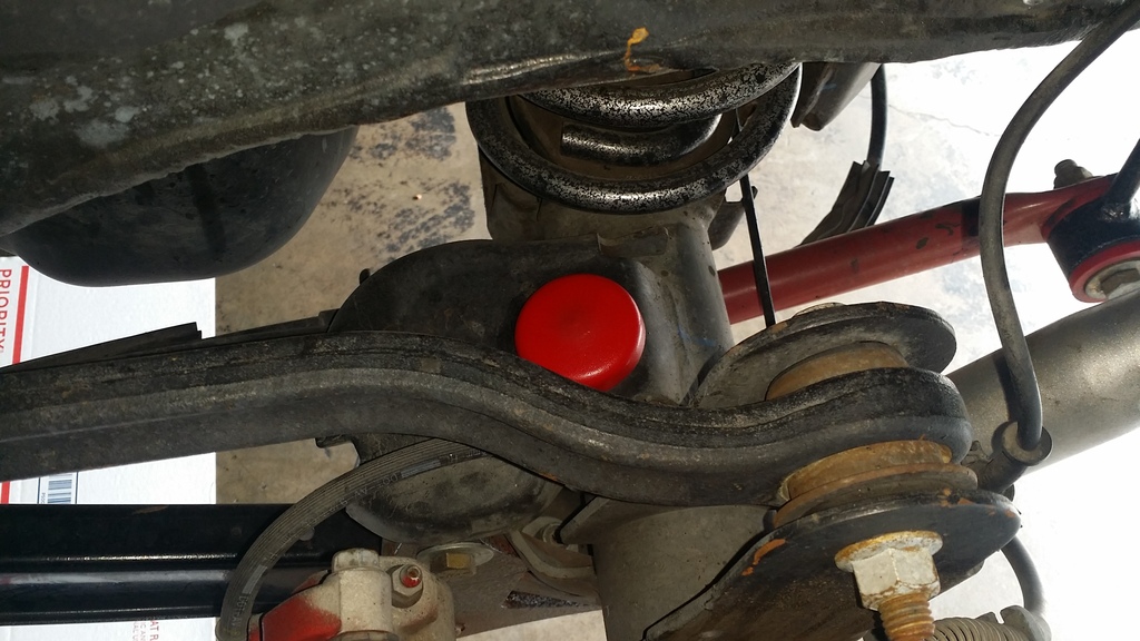

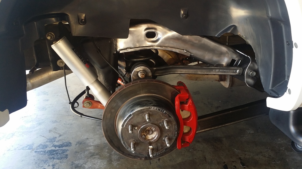

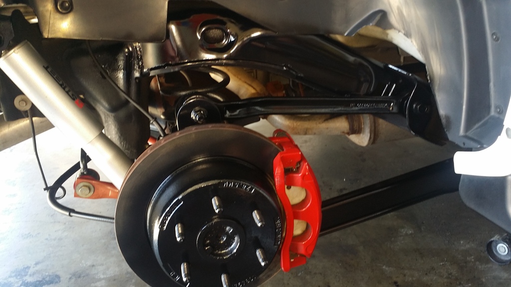

I also worked on the rear end just wasn't happy with how I left it last time
What paint did you use on the calipers?

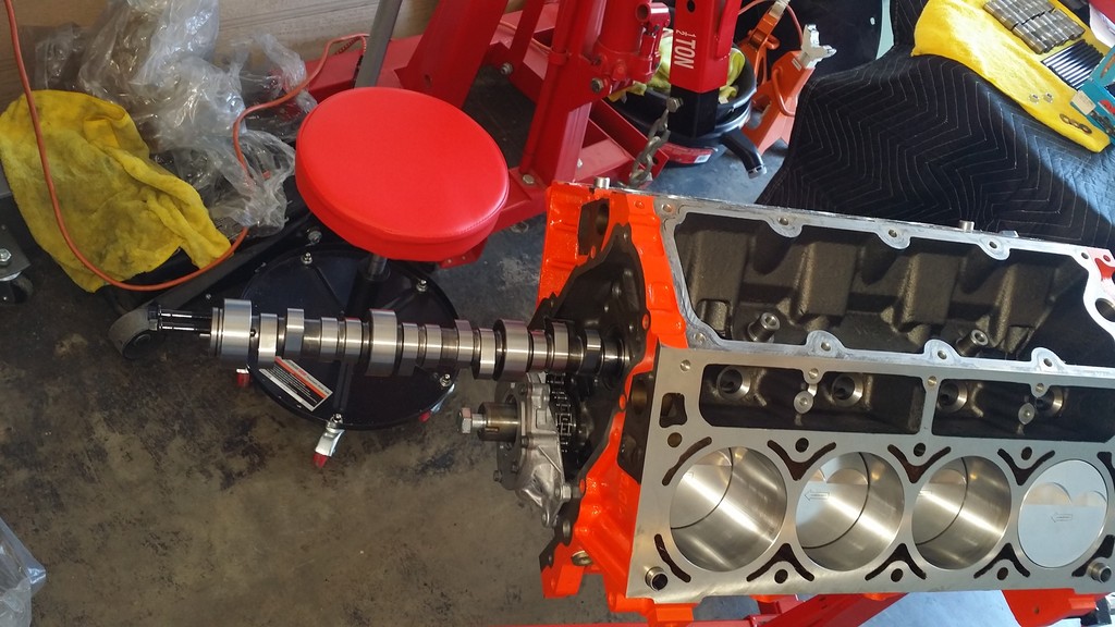

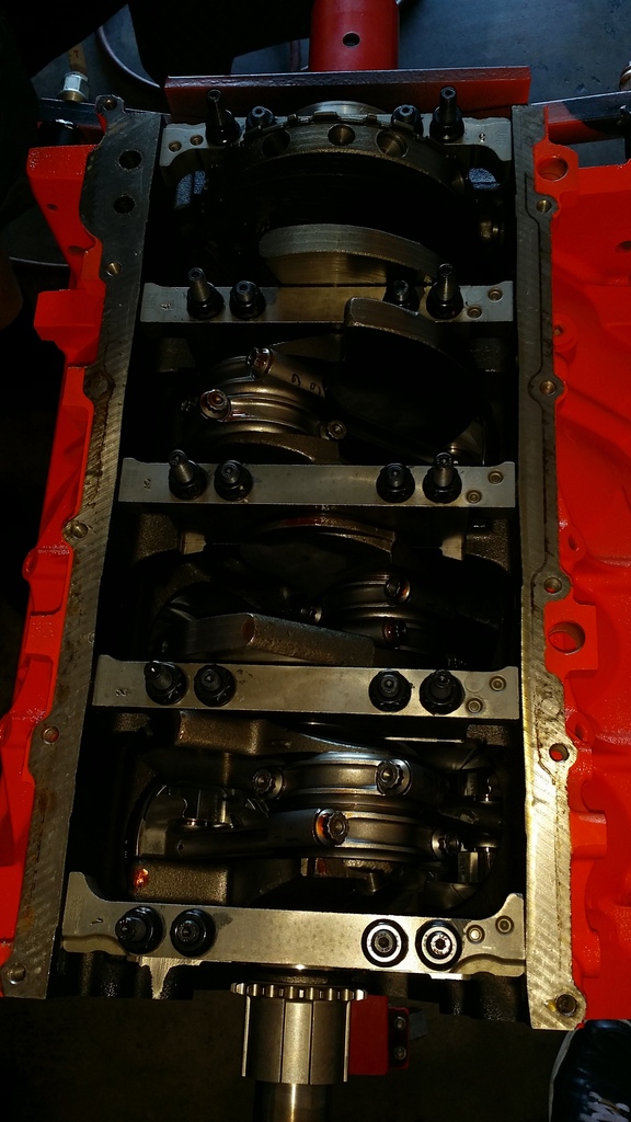

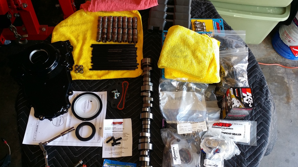

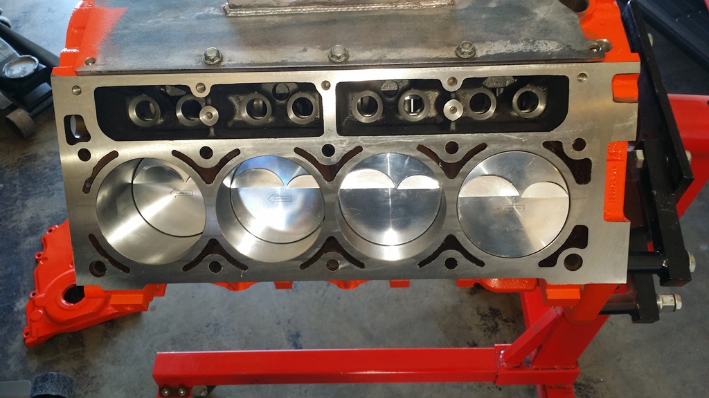

I Haven't posted here for a while been real busy with life and work, anyways here is an update of what was done this saturday to the short block finally buttoned up

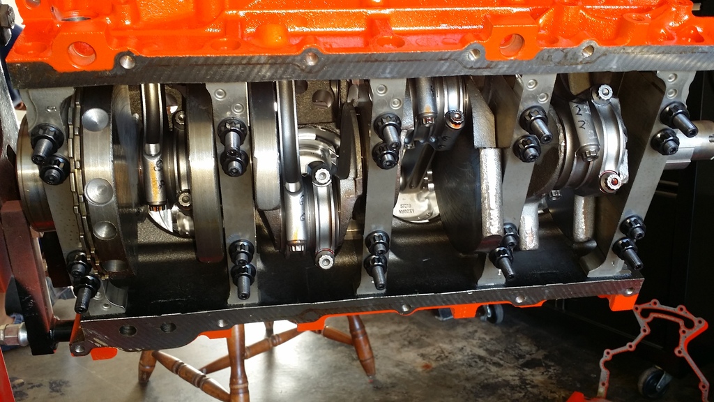

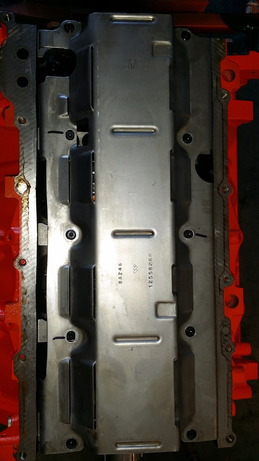

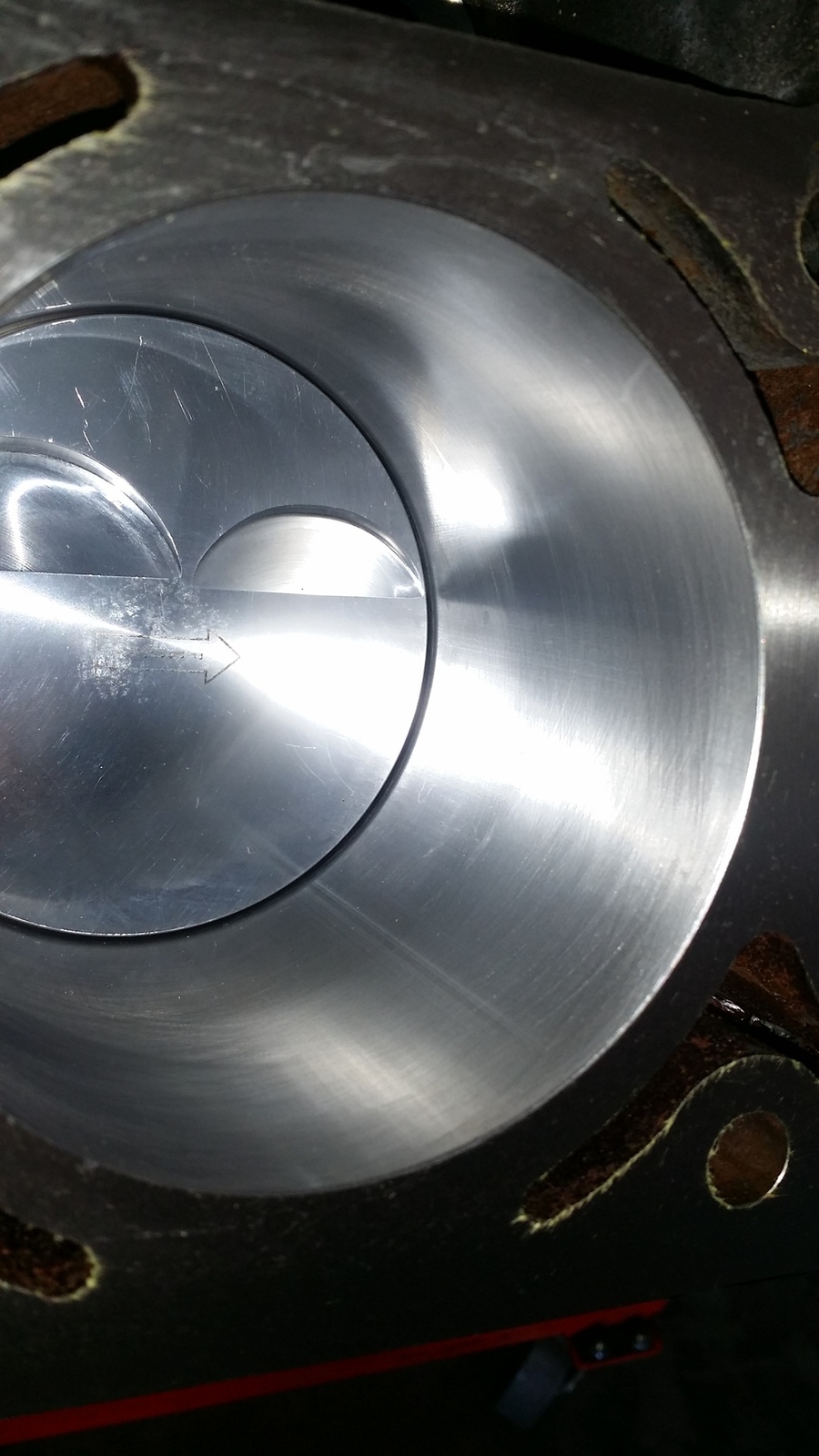

Ran into some issues with the Windage tray, Weren't lining up with the Oversized ARP main Studs so I had to break out the Drill and make the holes a little bigger.

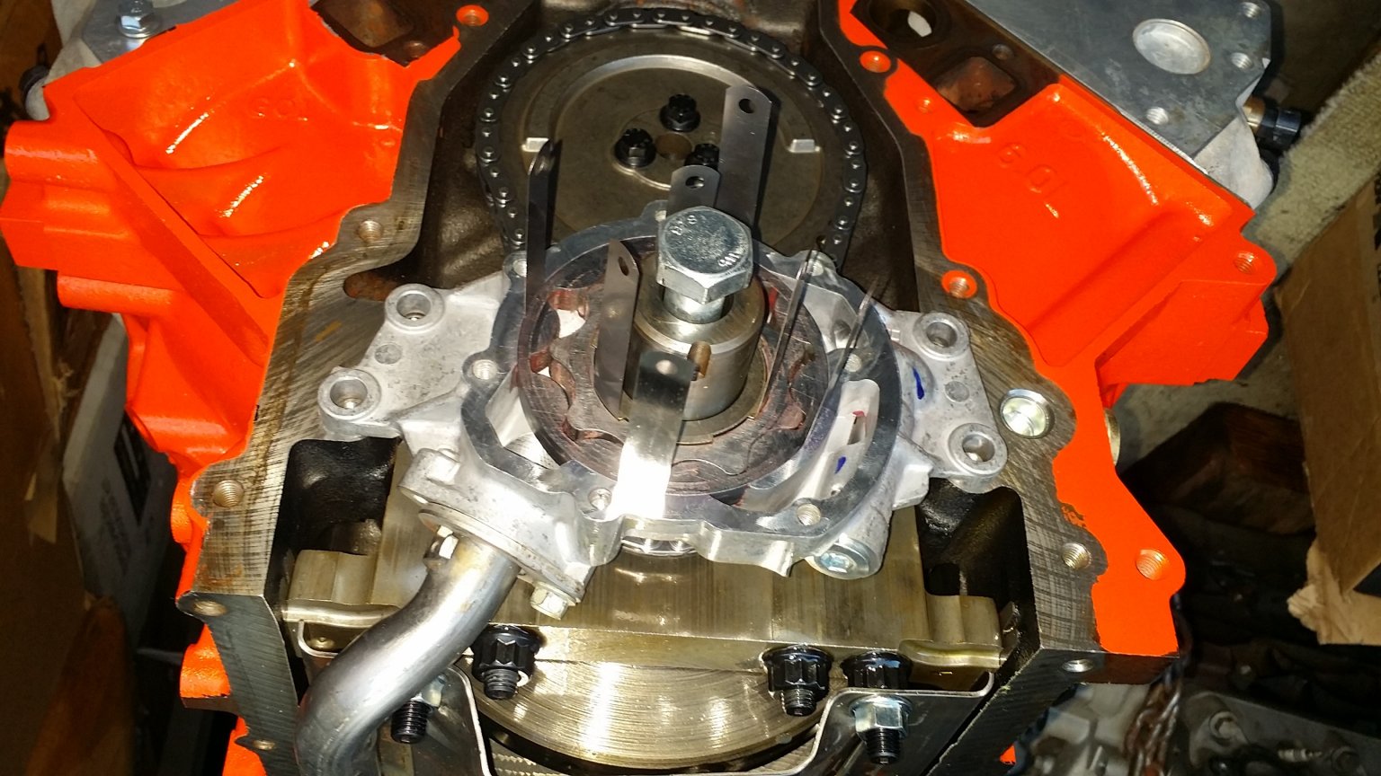

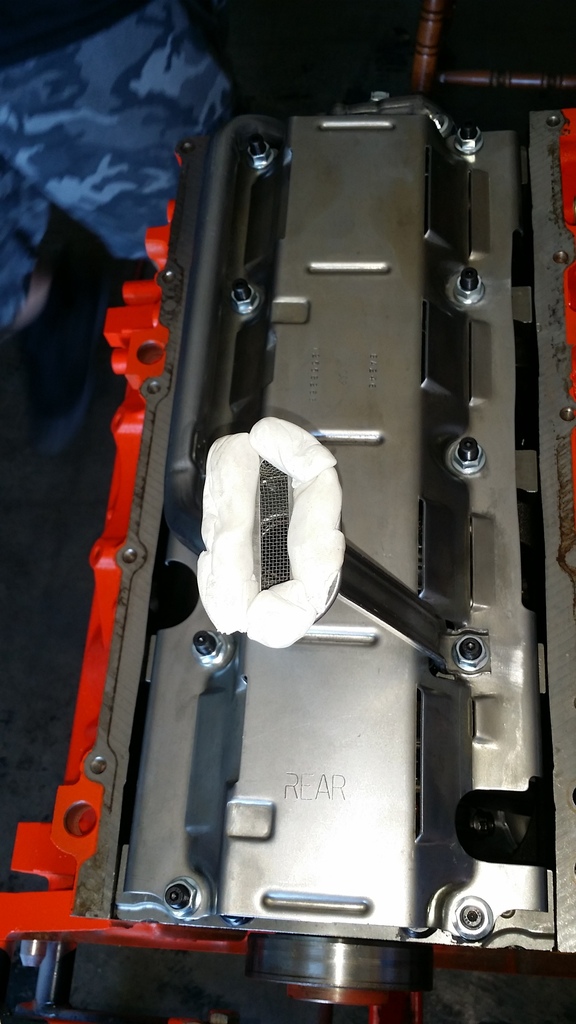

got the clay out and measure how far the oil pick up tube was from the bottom of oil pan
Magic stick going in lol

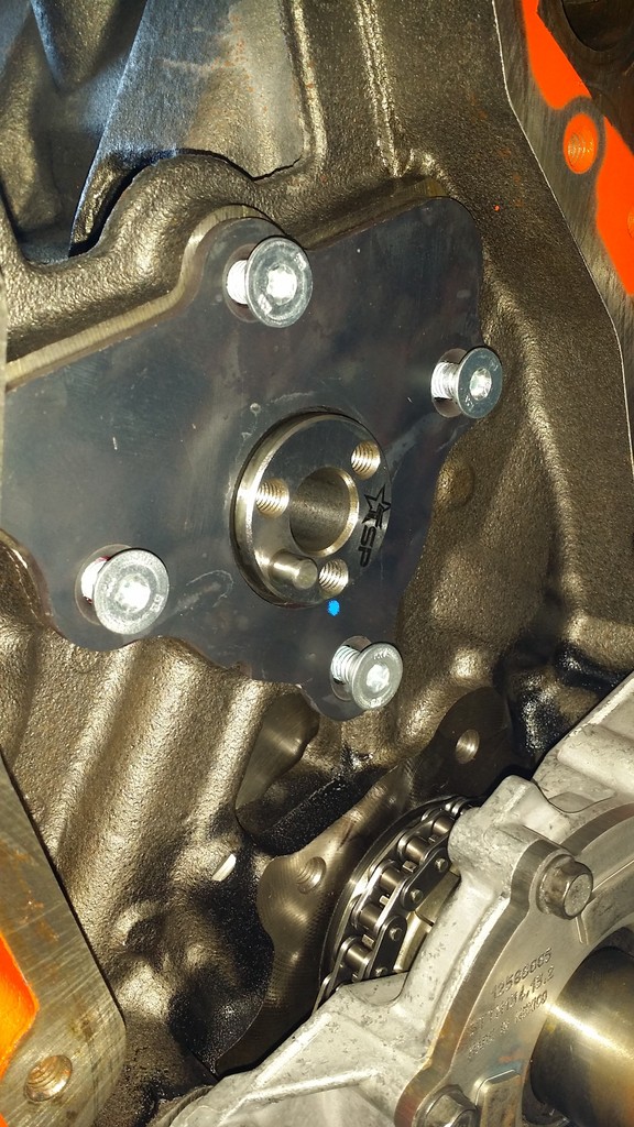

New CAM RETAINER with new style bolts going in all buttoned up

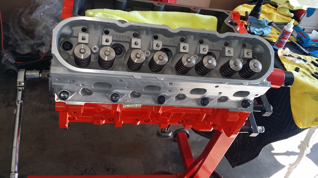

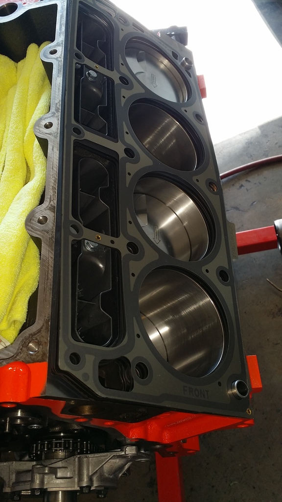

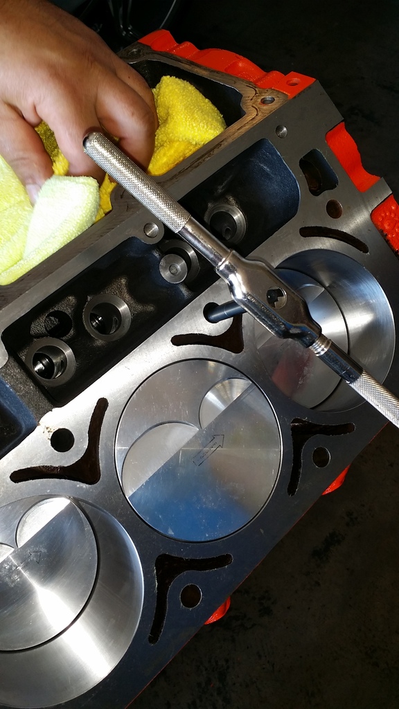

Chase the head bolts, Did about a total of 4 total passes

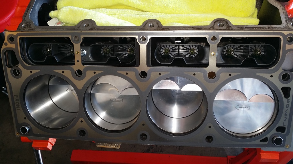

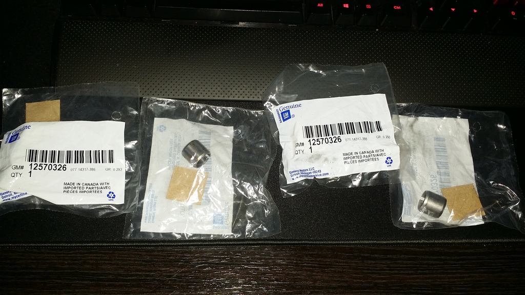

new CYLINDER HEAD DOWELS

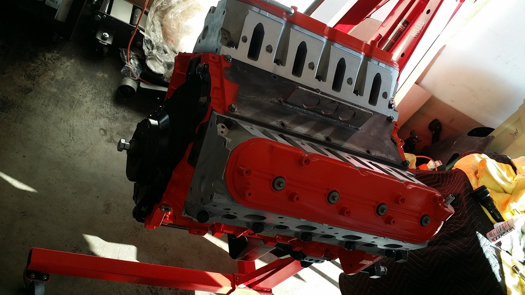

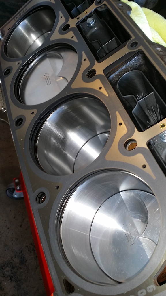

LS9 Head Gaskets seated with brand
Heads on torqued to spec in three sequences

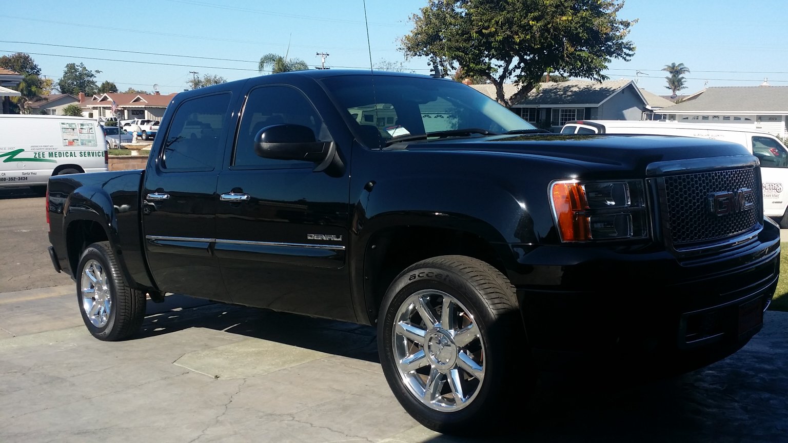

So I had some time off today and decided to work on the truck a little bit since I have some down time and waiting on the motor figure I would do something productive, Nothing big just routine maintenance
Covered all Plugs getting ready to Pressure wash the engine Compartment there was transmission fluid all over the place.
Done not noticeable difference in picture but in real life big difference.
Took the ***** out on my driveway so she could dry and get some sun, Since all it knows is being in the garage

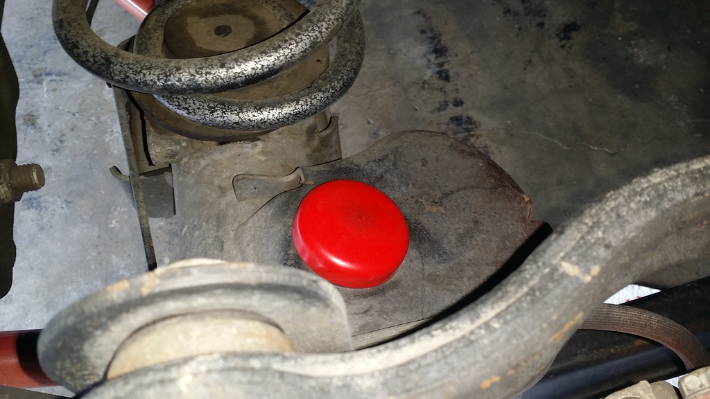

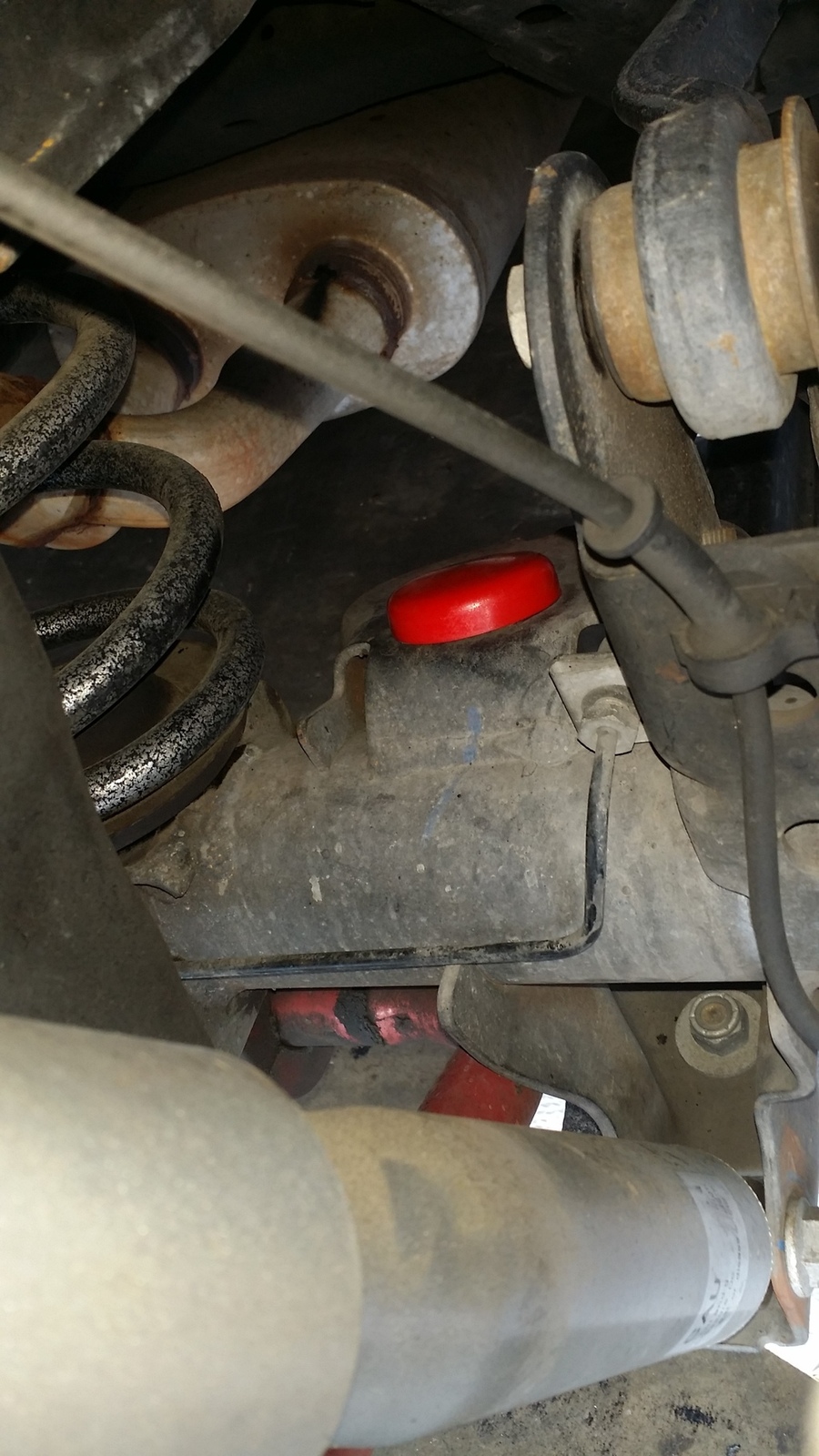

I also went ahead and finally put my bumpstops that I had for more then 3 years and finally now decided to put on, lol Thanks to @Fosscore
This thing is looking great! What pancake bumpstops are those?

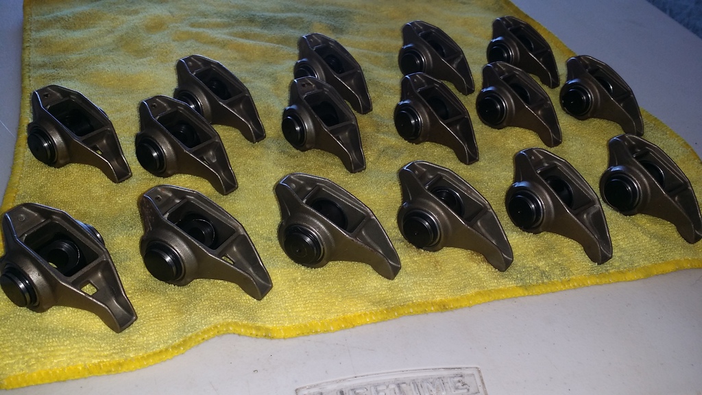

Not much of an update but finally installed my COMP Cams Trunnions
Nerve wrecking and time consuming process making sure bearings in right. U have to have done this to appreciate it lol..at least a step in the right direction. Everything went fast after this for me..
Git er done!!
Git er done!!
Sent from my SAMSUNG-SM-G900A using Tapatalk
this is true, It took alot of my time, but I made sure all the bearings were seated and flushed, Rocker shafts moves freely in there, so I'm very happy.. definitely lots of time and work.

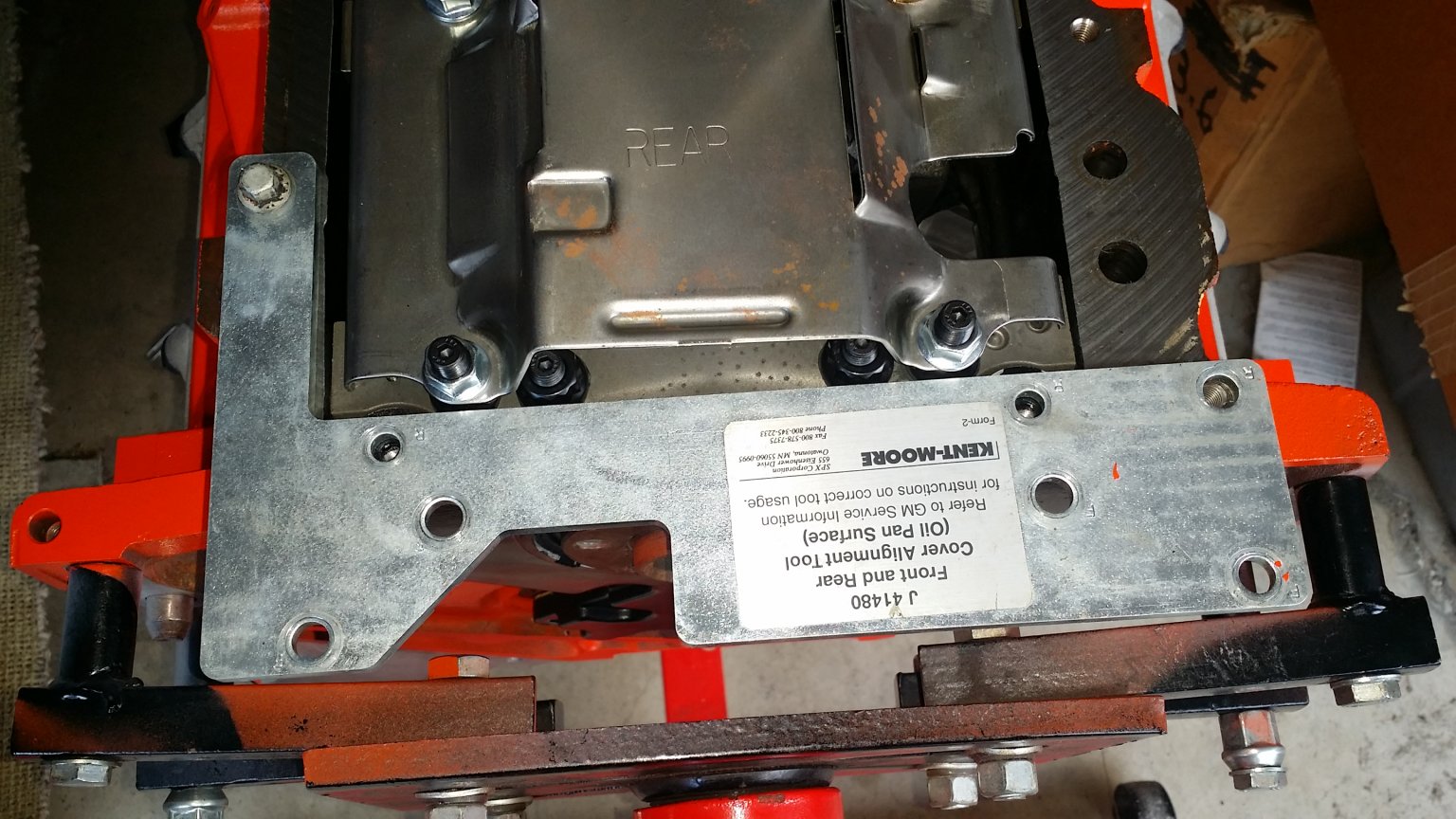

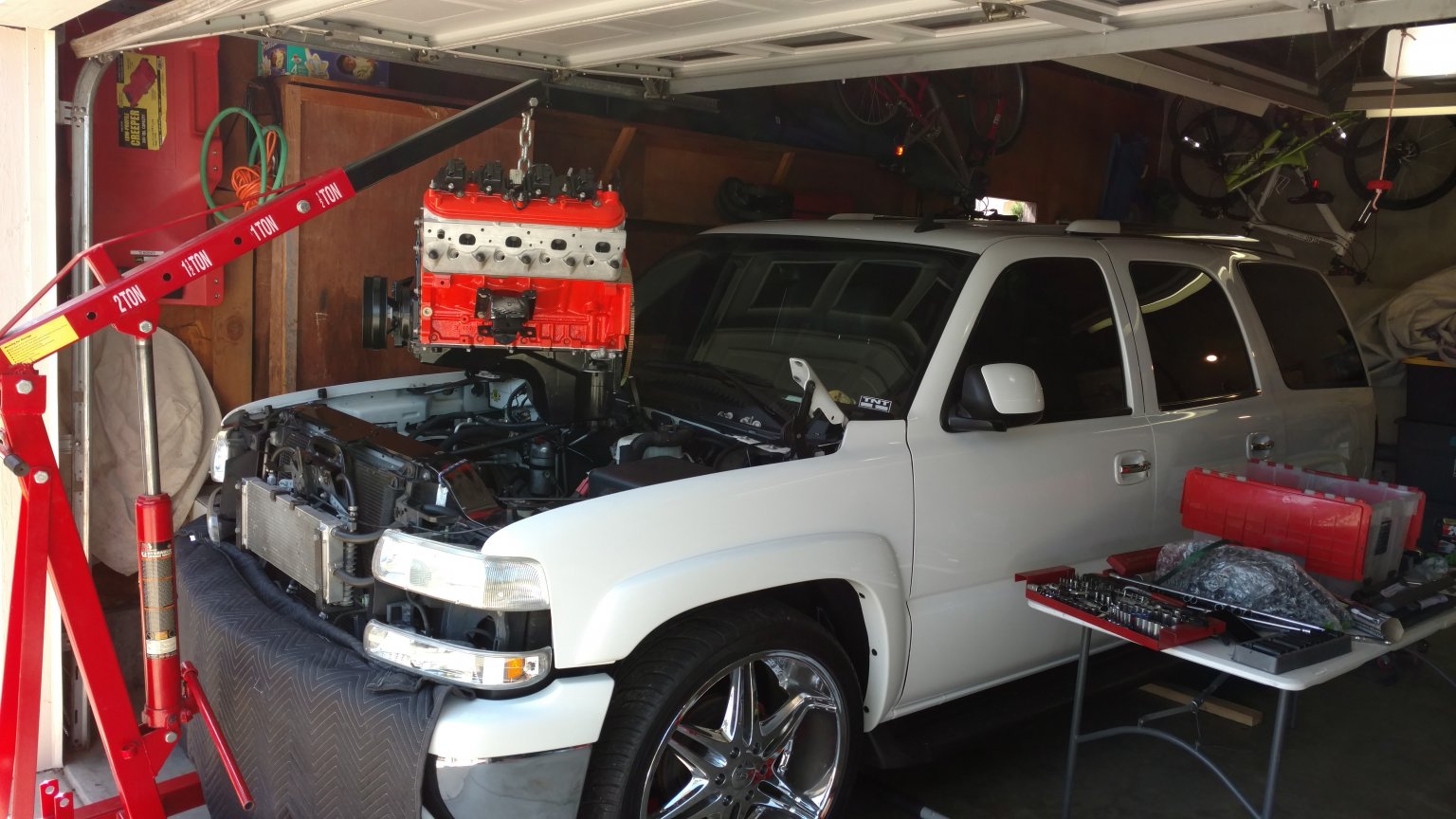

I know it's been long due for a update, Been so busy with life, I just finally had the time to work on the truck this past weekend here are a few pictures

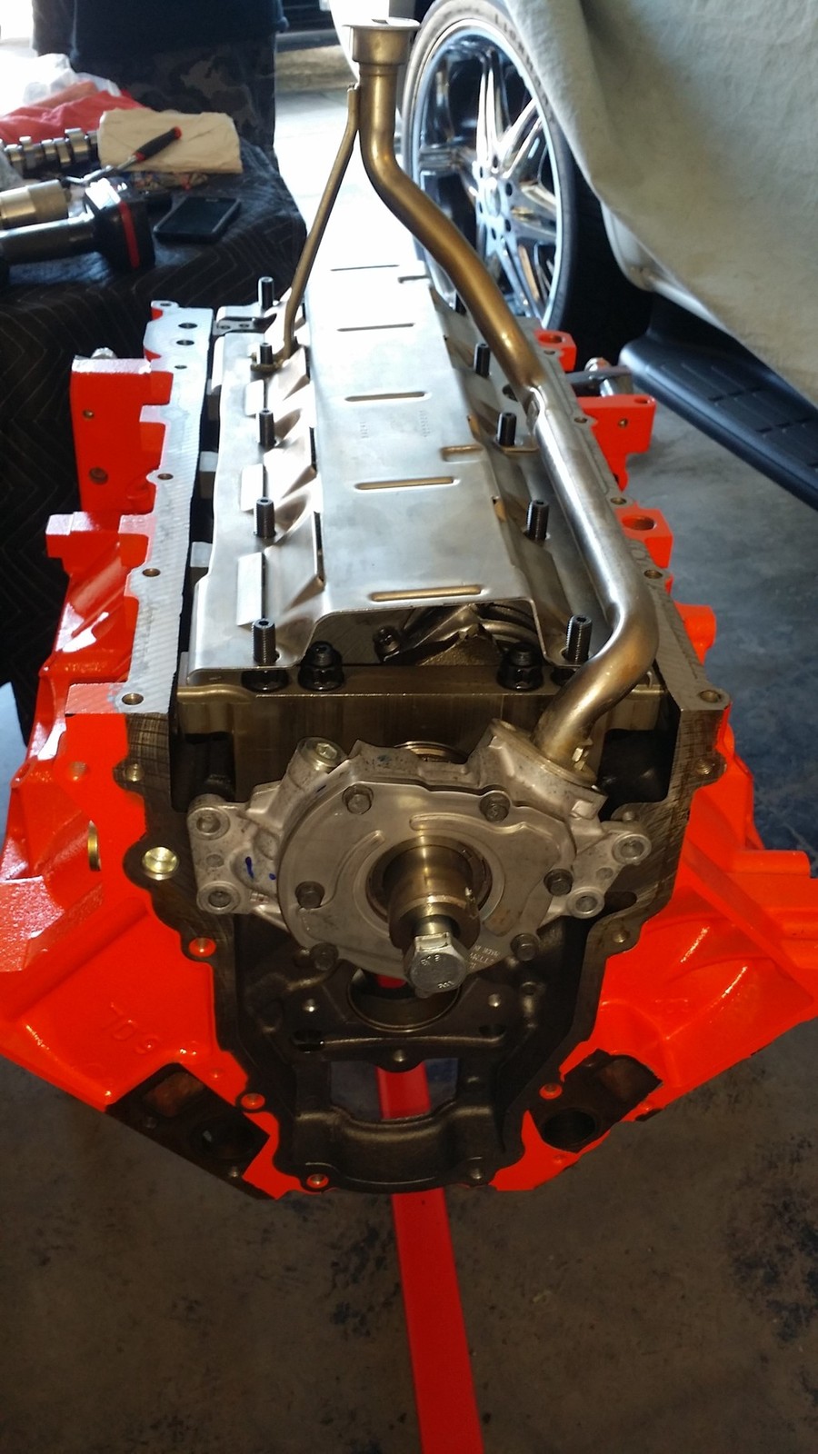

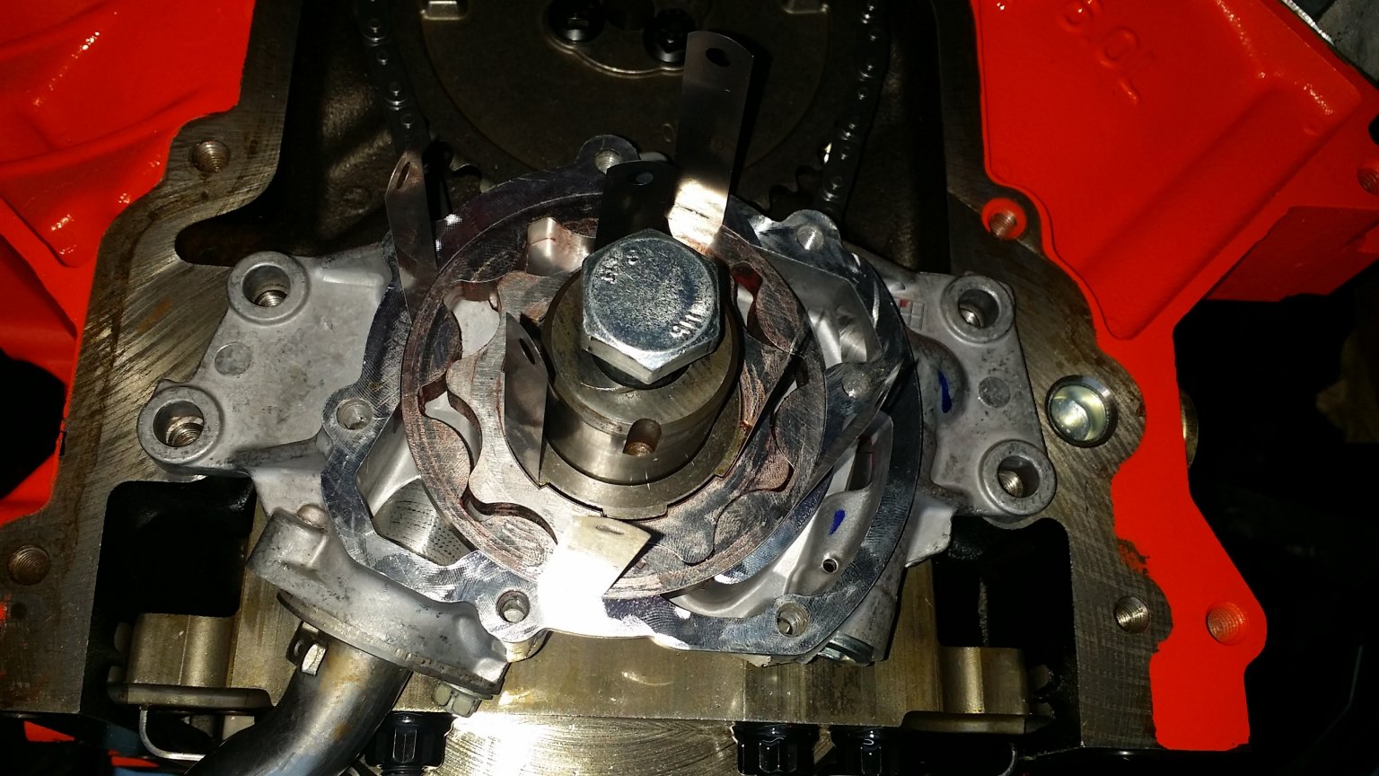

got the Katech oil pump lined up with ARP Bolts
Oil Pan Lined up
Shimming the oil pan
Lugging everything from the machine shop and borrowing a couple of tools to drop in the engine
