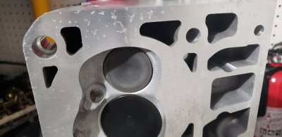

I don't like the way my heads look, so I sent an email to advanced inductions to have them check it out. Other than that, I ordered a cam degree kit so I can ensure the VVT advance in the parked position is correct. There is a lot of misleading information on the internet and I want to make sure it installs dot to dot at +7 and not like +14 or something insane. Only way to know for sure is to degree the cam.
Been spending the last 2 days cleaning up the engine block getting all the carbon off. It's a lot of work lol.
Attached a picture of the heads. There are white specs all over it after milling/cleaning.

Look closely at that valve seat, from what I see in the picture there is a crack. I just lost my L9H due to a valve seat breaking off and destroyed the piston..

Not seeing it? Can you MS paint the picture and mark where?

If you're talking about the two feint vertical lines, I looked as close as I could see clearly and they looked like just light scratch marks to me.
