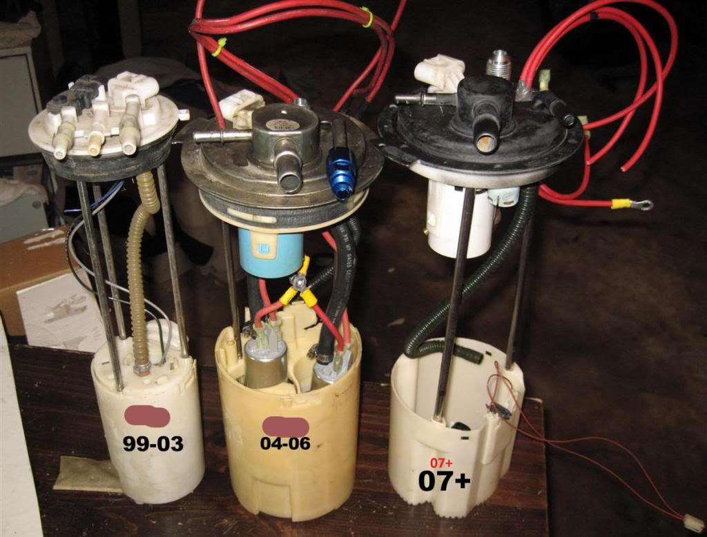

Atomic has a write up if the differences between the buckets.

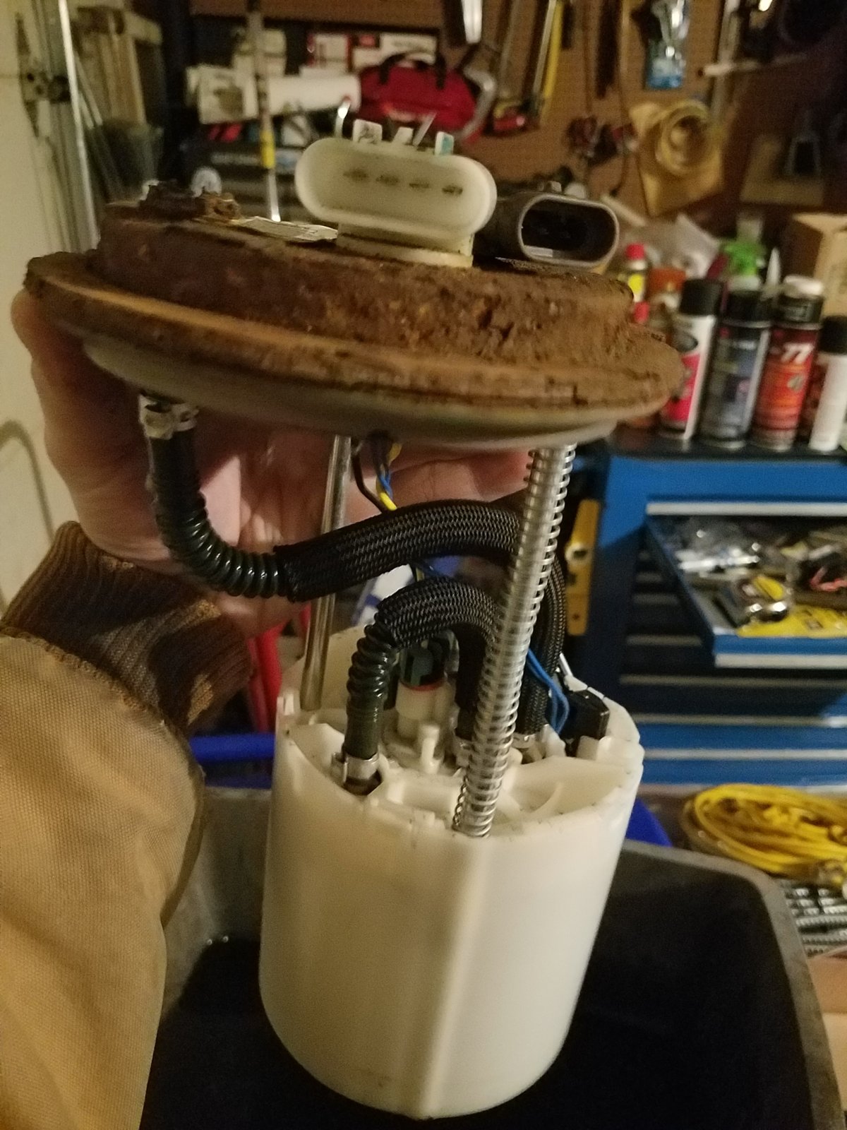

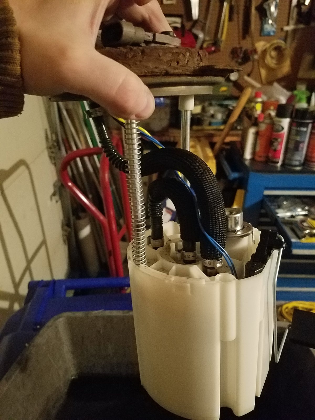

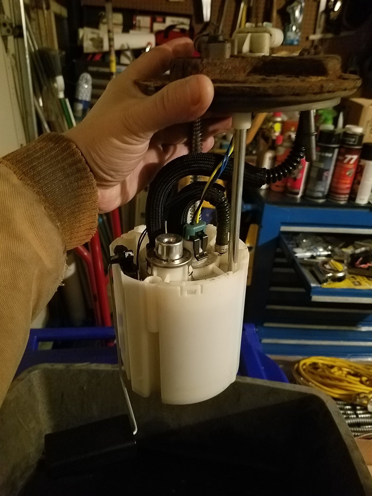

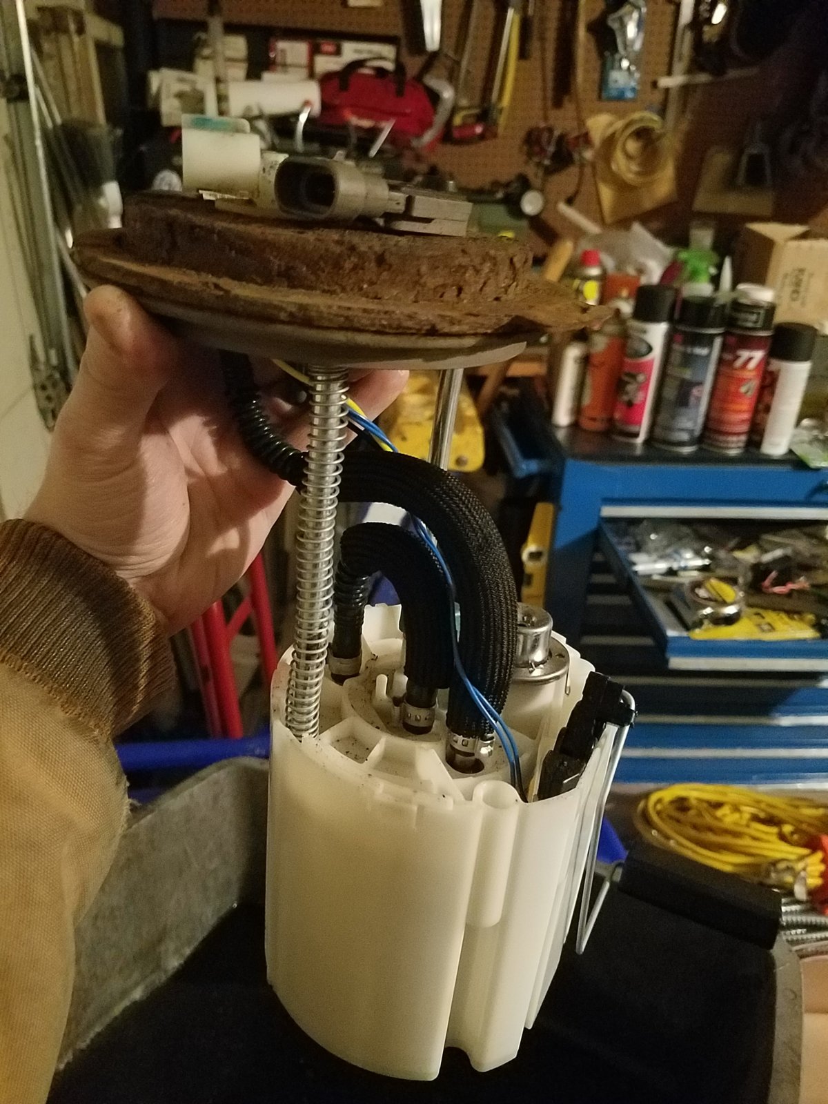

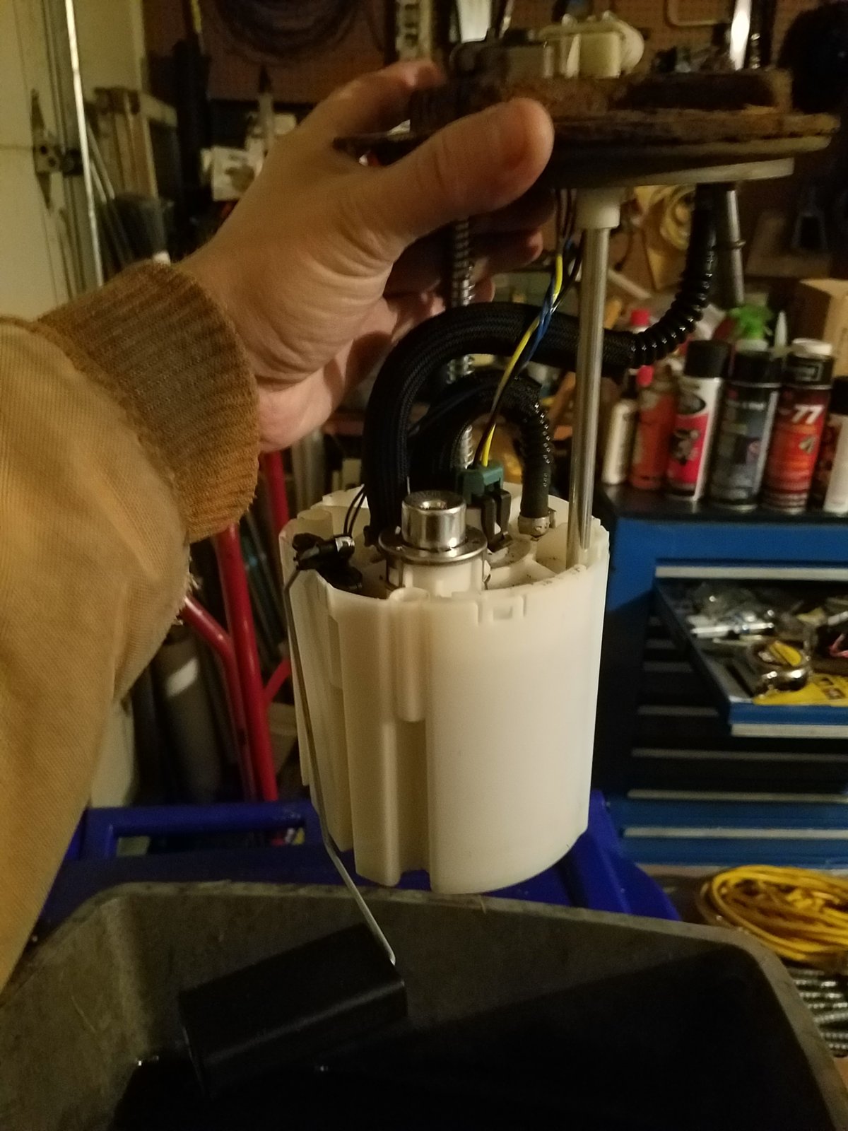

So looks like the 04-06 pump is the way to go, I wonder if my pump looks like this or if its different because its flex fuel anyone has a picture of a flexfuel pump that's a 04-06?
