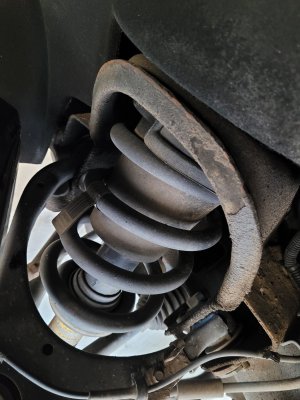

fitment, not so much...that will be overall size.
the wheel diameter can have an effect on rubbing issues if tolerances are close. i wi;; post a pic of the upper a arm of a 17 bubr with a 22 ' wheel and 285 tire...if this were an 18" with the same you can see how addition flex may contact the arm itself.
20210131_164421.jpg leading edge of pic is tire sidewall...if it were a smaller wheel, the buble of the tire would be slightly closer to the arm ( bottom left in pic) and could flex more causing some rub

Don't disagree when you are speaking to potential control arm rubbing. My initial comments were related to "fender" rubbing.
