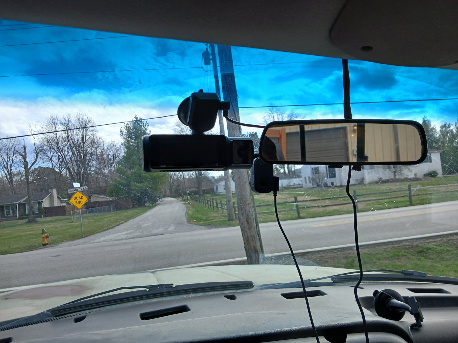

The third vehicle used was a 1996 Dodge Ram 1500. Power came from an ‘ignition on’ cigarette lighter socket. It was placed next to another camera from another company that was permanently installed. It makes for a rather crowded windshield but placed under the rear view mirror, visibility is fairly clear.
One issue appeared early on. The truck is used off road at times and has been modified through the years. The testing occurred in Indiana during the winter. Hitting pot holes sometimes tripped the G meter reacting as if a collision had occurred. The G meter can be adjusted in the settings menu but doing so might keep the camera from automatically tripping when you DO have a crash.
