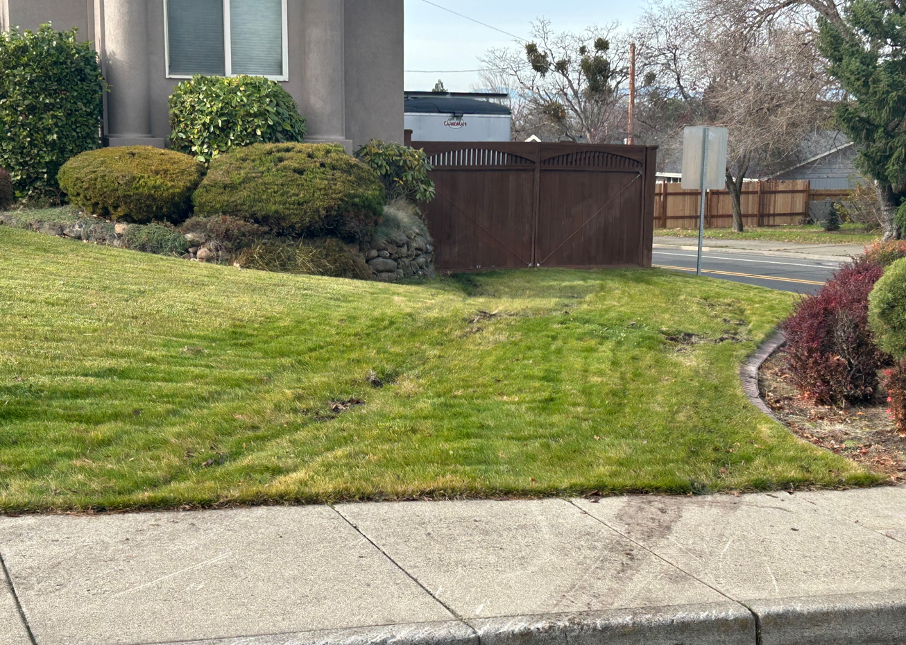

First time I tried it was backing a trailer into a camp spot in the snow. The 2wd was slipping, so tried 4wd low, but... I got horrible sounds (kind of tight steering wheel turns) and just went 4wd Hi.
Second time was recently - here's my post in another thread....
For what it's worth, I've had 3 4WD Tahoes and 1 4wd F150 - all of them acted this way in 4 low. 4 low is meant for low traction situations where you need max torque. Be careful using it in situations with high traction as you can damage the system.
Yep, that's what I'm finding out. I pull a 5500lb trailer over my front lawn out to the street. I have a 'grass driveway' with 9" stone and those plastic grids with 1-2" dirt/grass on top. Slight uphill to the street.
Normally I just 2WD over the grass to the street but due to tons of rain, the left rear tire slipped in the grass->mud and I wasn't moving. Put in 4WD-Low and slipping (left rear) tire spun a bit -> 'clunky engage' -> more clunks -> general spinning / could not move forward and tore up the grass a bit more.
Put in 4WD-Hi and pulled right across the lawn to the street.
To me (the layman) it seems like 4wd low would be perfect for maximum traction at 2mph on muddy lawn but 4wd hi was the better choice.
I'm not posting to complain, just interested in....
1) Why all the noise on tight turns such as 3 point turn-around in snow - it sounds horrible! and someone posted that I could damage the vehicle.
2) Why is 4wd hi better for moderate mud that 4wd low? - why was 4wd low so clunky and actually made things worse?
3) What am I missing in my thinking....

Based on your picture I would say the issue is simply traction, not the 4wd system
if you just need to get moving off the grass or from a slippery spot then a couple sets of traction mat's or recovery boards are easy to just throw down, get out of the spot, throw them back in the truck and keep on moving. a lot easier and a lot less work than cables or chains.
As far as driving forward - yes.
My question is not so much traction but how the 4wd lo works. I was surprised that 4wd lo failed to help me move forward whereas the 4wd hi worked smoothly.
I was stuck due to left rear spinning in 2wd. Backed up a bit but when it hit the same spot, the left rear spun and I was stalled again. Choose 4wd lo, and gave it light gas. The slipping wheel (left rear) spun/then clunked in a 'rough manner' and then one or more other wheel(s) spun (did not get traction) and I was still stuck but it tore up more yard. The mechanical operation was rough - not smooth.
And as others describe, 4wd lo is max torque but this was not a case of needing extra torque - and maybe the extra torque actually caused my failure to move as the power to the wheels was so strong on even a little bit of gas it just spun in the grass?
Whereas when I switched 4wd hi, backed up a yard and moved forward smoothly out to the street. This is what I was expecting from 4wd lo.
I'm trying to learn more about this.... maybe it's as someone suggested the 'clunking' was lack of gear engagement and I should have done reverse a bit and then it might have moved forward smoothly? Someone else seemed to suggest I should have done L1 manually?
Functionally - 4wd lo failed but 4wd hi worked in this case and I'm just trying to understand why as I suspect I used it incorrectly.
When you engaged 4 Lo, did you feel a lurch forward when going into drive?
If not then you weren’t in 4Lo and were stuck in between modes.
A 5500 lb hanging on the back likely complicated the shift in the transfer case.
To get into 4Lo: stop totally and completely. Engage neutral. Then hit 4 lo. Let system engage ( you will feel and hear clunking). Then engage drive. Then release brake pedal and move forward or rearward. There should be a das indicator and some messages about traction control being turned off as well.
When engaging drive you will feel a big surge forward.
Some systems need some coaxing while engaging the low gear in transfer case , it helps to take foot off brake. This is in in level ground.
With suv at an incline and with a large mass in back of it it may take a couple of attempts.
So you go into 4 hi and move forward a bit . If you can’t then go rearward. Try again.
You are trying to get the internal synchronizer to engage the teeth in the low gear.
You might check your fluid level in the transfer case as well.

that area pictured is pretty flat, nothing like a boat ramp and he had wheel spin on wet grass, all that is needed is traction.
4lo can be useful for a incline yes, but nobody is towing there boat around in 4lo if you are then you need a bigger truck.

To recap one aspect that's becoming clearer to me....
4lo gives significantly more torque to the wheels compared to 4hi with the trade-off of lower speeds. And one reason for this extra torque that under steep enough conditions (for example) 4hi (the rig) doesn't have enough torque to move the wheels/vehicle forward? where the extra 4lo torque can overcome this.
*I guess I was thinking (not very well) that 4lo gave a different kind of traction control and didn't even think about the torque aspect as I assumed the rig was 'all powerful' in any mode.
So in my front yard, minimal slope, 4hi is fine / no need for extreme torque to move forward. In fact, the extra torque + clunk/engage might have been why the wheels broke free/spun on the grass and actually caused me to fail.
