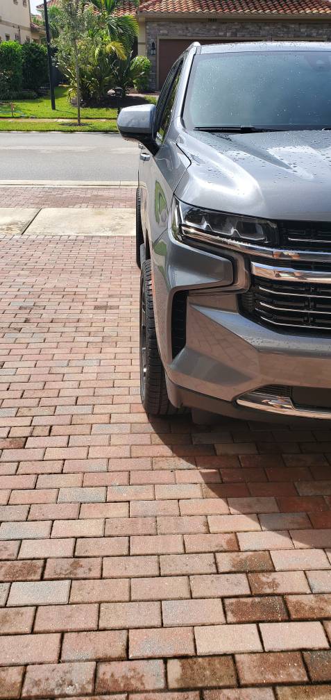

Thanks for the heads up. Having it done at the dealership. The Z71 comes stock with 275/60/20 which is a 33” tire. I am only increasing .6 inches. Hopefully there won’t be an issue.
Several companies make a 275-65-20, a 34" tire that is stock width and in the 900s and K2s, requires no trimming even on stock ride height vehicles. So they say!

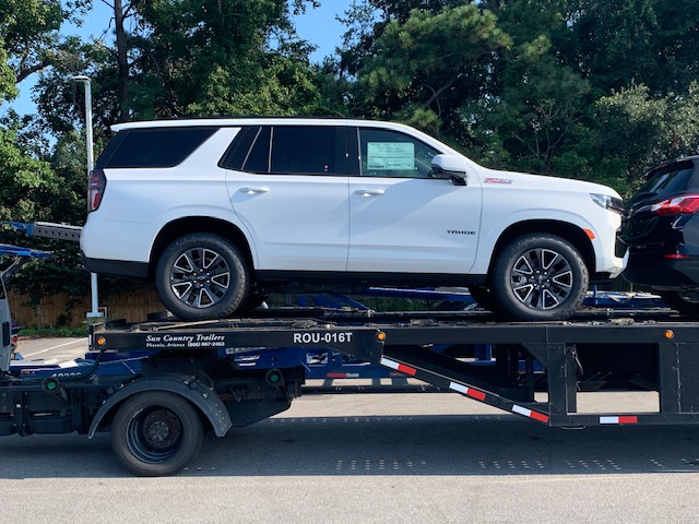

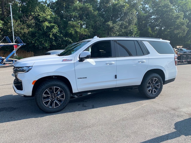

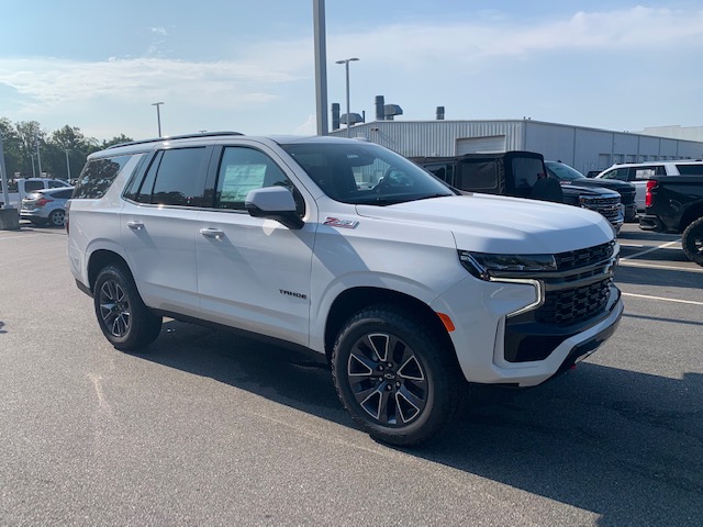

Wheels and Tires go on next week!

Did this one come with a 3.42 rear axle?
3.42...or supposed to anyway. Max Trailering package. Looked thru my documents but don't even have sticker as it came off the truck to me.
Optons in addition to the Z71 standards on mine are:
Z71 Signature Package
2nd row bucket seats.
GreyStone
Feb 18, 2020
896
995

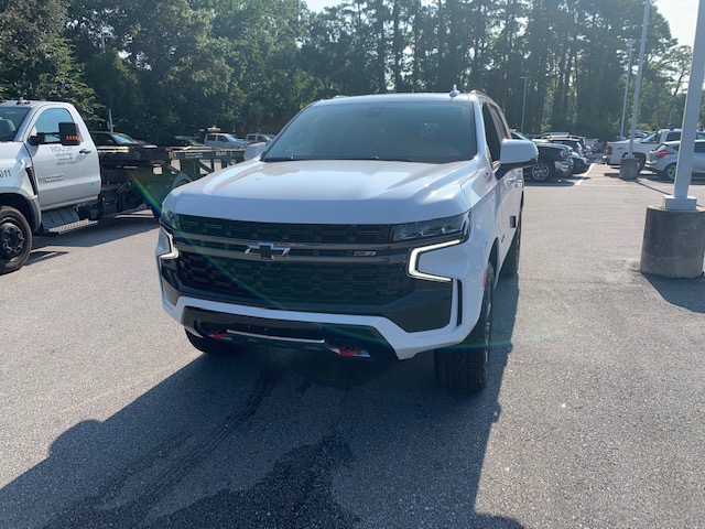

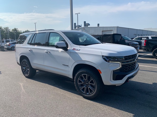

It's a good looking truck - I like the running board delete - I hate those things.

Thanks I agree, although it seems a tad hire than previous years. They were not on it when delivered and just told them to leave them off.

Yeah - I noticed not much rake in the stance - almost looks leveled out of the box.

It’s actually a bit less than previous years but also believe the wheel wells are a bit different front to back. Planned on putting a 2” level on this week with new wheels and bigger tires, but might leave as stock if tire clear. Have seen a few leveled on internet that look a tad high in front leveled.

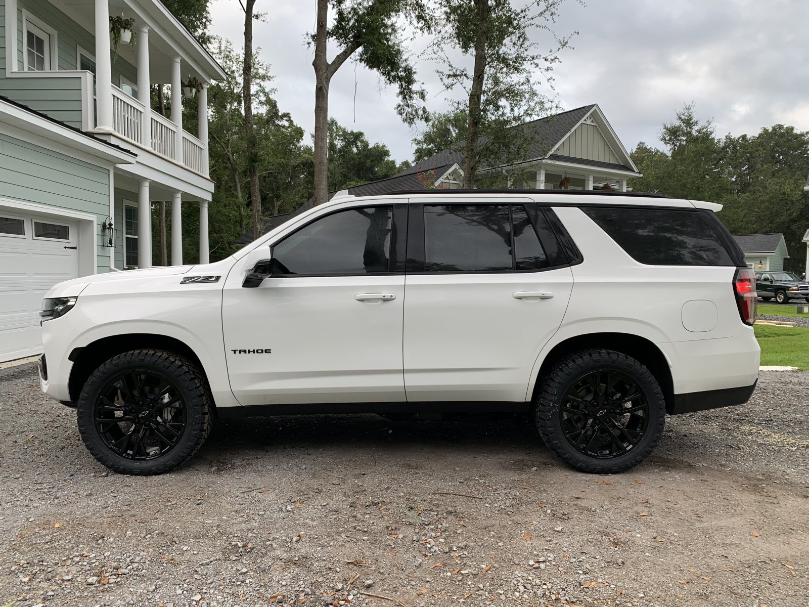

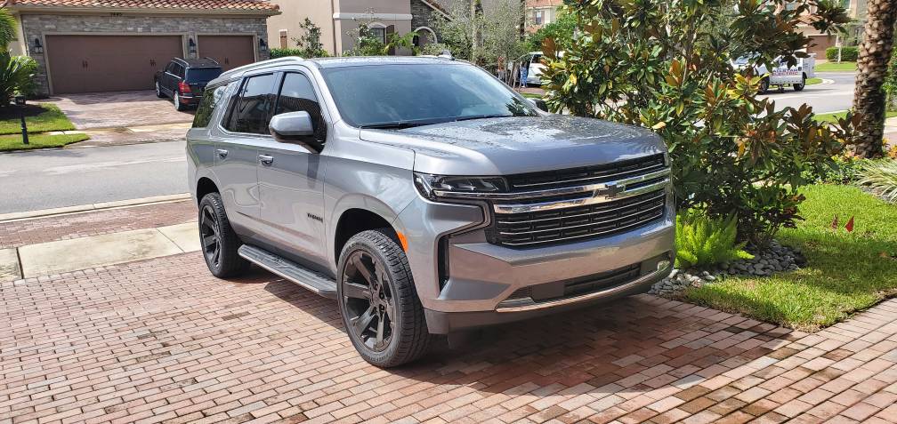

New wheel/tire setup on:
Wheels 22x9 +24 offset, 285/50r22 Nitto Ridge Grapplers. No noticed rubbing yet. Clears by 1/2” on front so did not install level at this point. May add at later date still deciding.

those wheels look great! are they aftermarket as it looks like I see a bowtie?

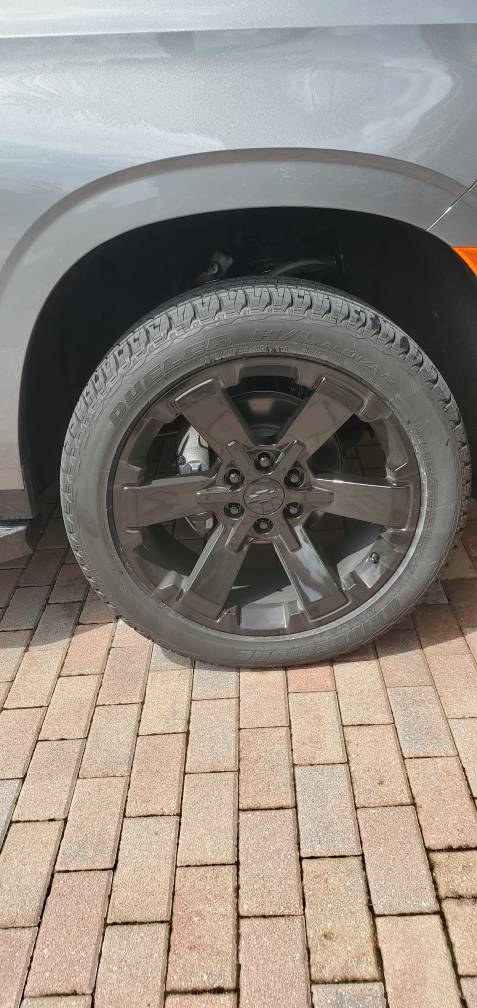

Does the leveling lot drop the rear or raise the front? I measured 6" gap in the front 6-1/2" gap in the rear with 285/45/22

Raises the front. Best way to measure is from ground to fender well above the tire.
