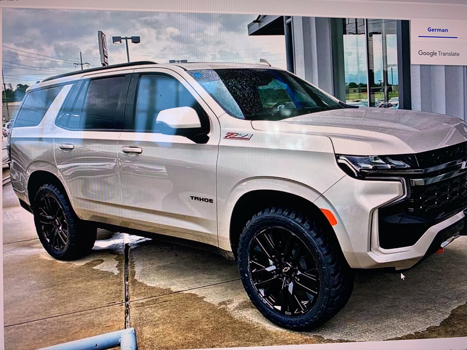

Looks great!
That what I’m running.
[/QUOTE]
So did you have to do any trimming on that or is it all stock I have my 22 Tahoe Z71 being built next week was looking for 22” Black Honey Comb wheel but hearing all different sizes for tires 33x12.5R22 then i just seen yours 285/55/22 just wasn’t sure what’s my best bet

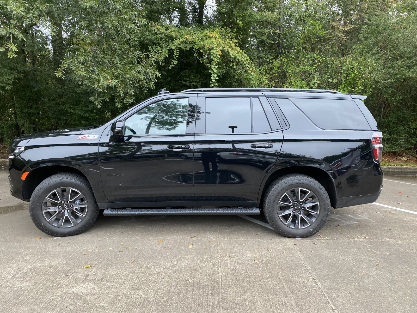

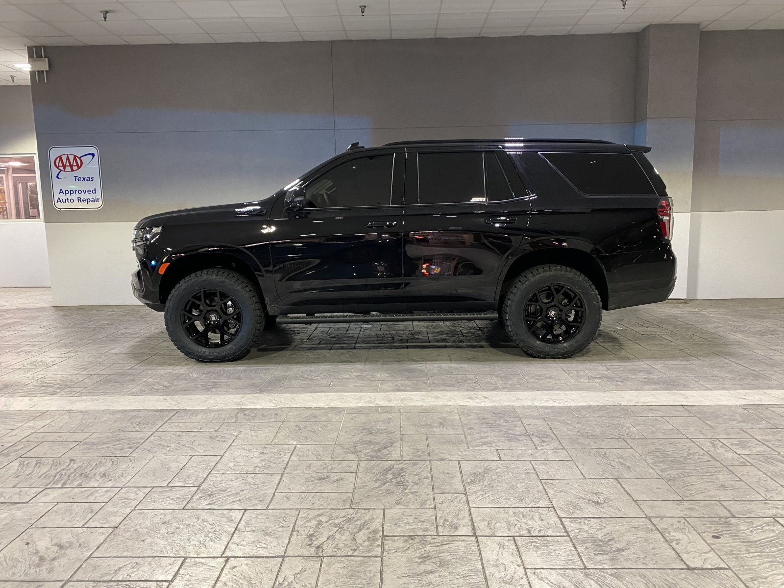

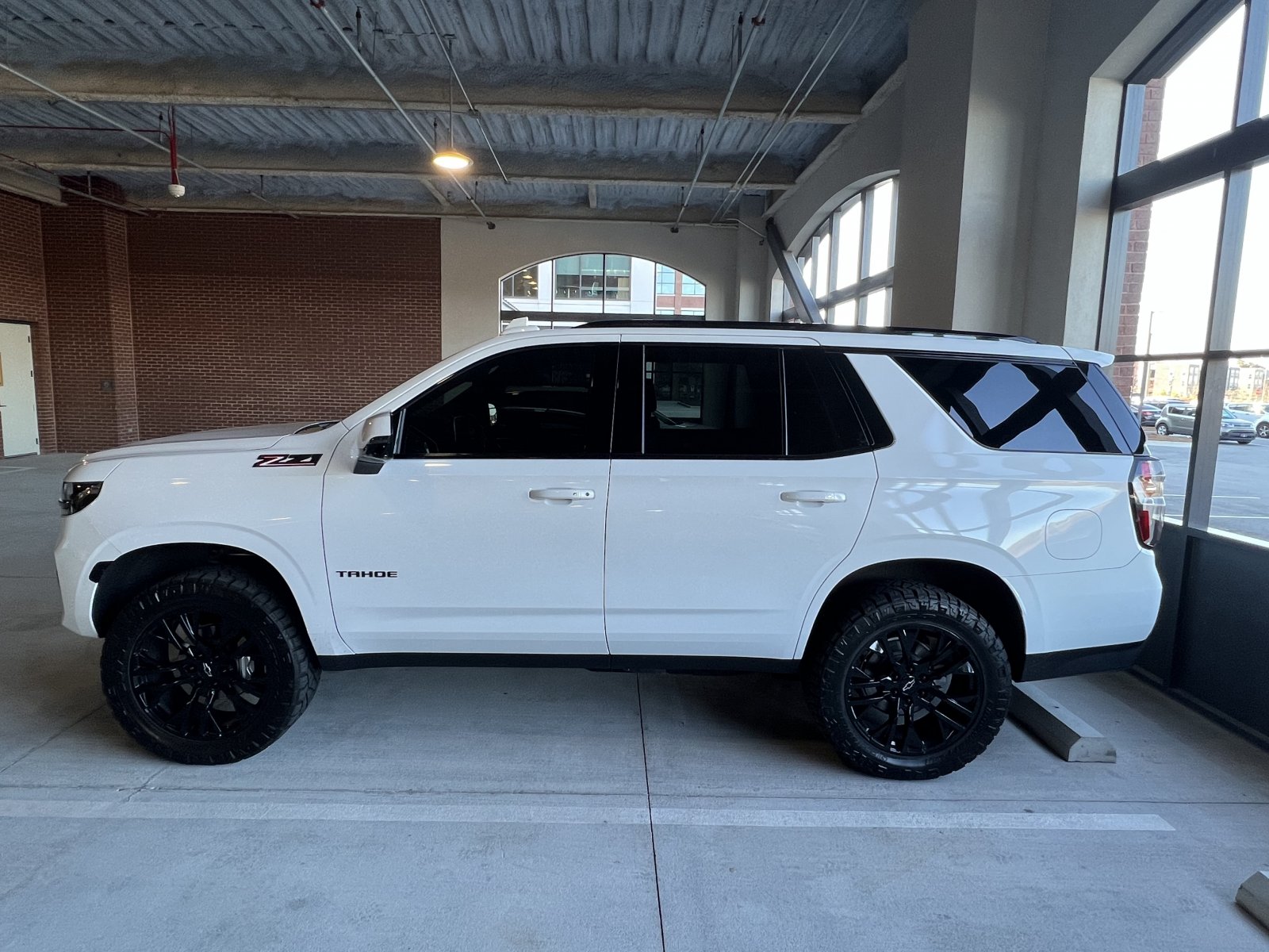

Here is some before and after. 2022 Tahoe Z71 with Rough Country Level Lift, Black Rhino Wheels 20x9 0 offset and 295/60/20 Nitto Recon Grapplers (33.94x11.7). I also replace the ugly grill and fender emblems with black ones. Slight rub at full lock on both sides near the rear of the fender well, fixed with minor cutting. Slight rub on driver side at the front of fender well, fixed with minor cutting behind the felt. Rubbing only occurred at full lock out. Hope this helps those trying to plan a build!!

How far do the tires stick out on this bad ass hoe??
Msmart123
Nov 11, 2022
that looks really good. Are the spacers needed to keep them from rubbing?
Did you have any issues with installing the rough country 2 inch lift kit on Z71 Tahoe. It says on Rough country website it won’t work with Z71

How did the ride change? Planning this on our Z71, but the wife dislikes changes to ride quality. She tolerates it, but I'd like the preempt with your experience. Here is our 22 factory height with 33s.

Is this the 2" RC lift?
