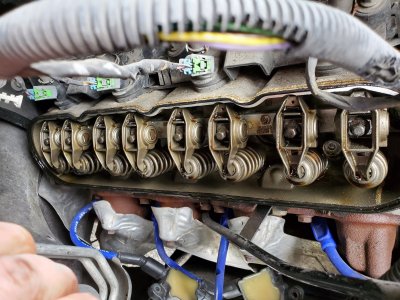

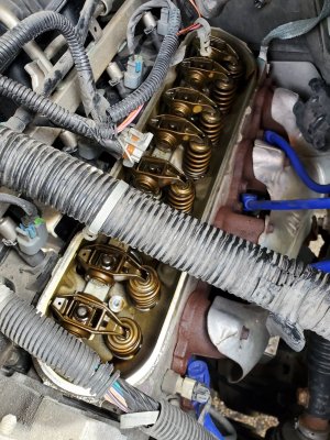

Valve train looks good. Nothing out of place. Time to look underneath....

Is there a way to upload a quick video? I just tried a 10 sec video and it was denied (too large) Definitely sounds like a mechanical tic, with a mechanical popping a few times. It sounds the same on both sides of the engine.
If a lifter or two broke, How bad ($$) of a repair do you folks think it is? Just lifters, or the whole enchilada? IE cam, lifters, push rods, and so on....

Ummm.....Yeah. That sounds like a likely collapsed lifter.
When you had the valve covers off, did you happen to try and turn the motor over by hand by putting a socket and breaker bar on the harmonic bolt?? If so, did all the rockers move?
