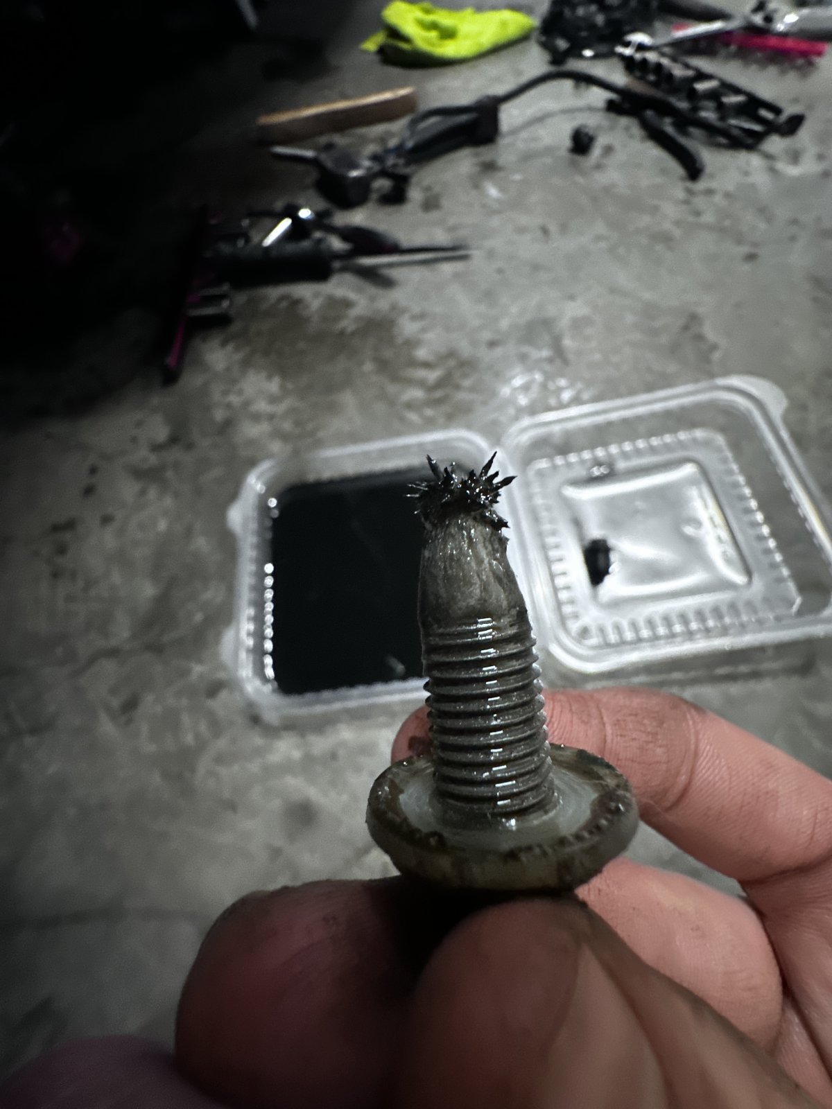

The front diff is leaking on the driver side axle seal. I refilled the diff fluid a few weeks ago and saw a decent amount of metal shavings.
(Could I possibly be a bad bearing by the outer seal?)

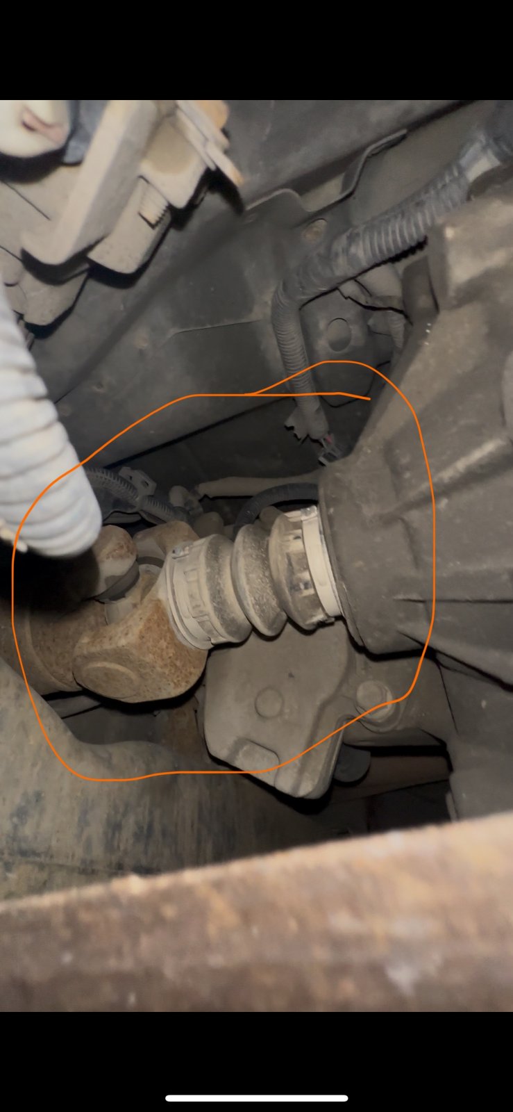

I can’t attach videos here, but I grabbed a screenshot of the front driveshaft. There’s no play at the transfer case, but I do feel a clunk if I push the driveshaft up/down or twist it.

It looks to me like you need to replace the front differential. Used ones are common and fairly cheap.

Carrier bearings in the front diff are known to go bad. really, it's the adjuster lock tabs letting the adjusters walk and then bearing preload changes.
I've rebuilt a bunch of these front diffs that had WAY worse metal on the magnets only to find rollers on the carrier bearings pitted.
these trucks are also known for transferase chain stretch that can rub thru the case. I would do a drain and fill on the t-case and check the status of the case.
