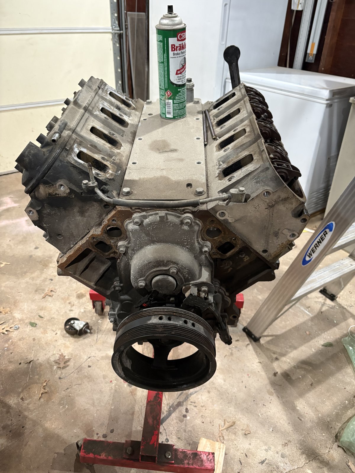

At first glance, here’s the push rod at the very front rocker arm. Wedged between the arm.
This is the engine loaded into the van, I didn’t have a cherry picker yet so I had no plan on getting it out lol. Luckily the van is so low to the ground, I was able to slide it close enough to the edge and bolt it into an engine stand then kind of wrestled it out of the van.
Couple days go by before I even touch the engine. First thing I do is pull out the wedged push rod… well it’s bent pretty bad. Has me wondering if the lifter is damaged now. It didn’t take me long to see through the intake port that the valve stem was gone. At this point, the heads come off and I find a damaged piston. So I just started tearing into it

The valve really beat that piston up, almost pushed all the way through.
I would like some opinions and feedback. I’m not sure where to go next. Do I just buy a piston, rings, valve, spring, push rod, lifter and the associated gaskets and then send it.
the engine SUPPOSEDLY has 90k on it so still young IMO. But is there a way to check if the oil pump is still good before I swap the engine? What else should I look for?
And what are some absolute “must do’s” while I’m in there? Should I replace all the springs or just the Broken one? Do I replace all the push rods? All the lifters? Valve seals?
