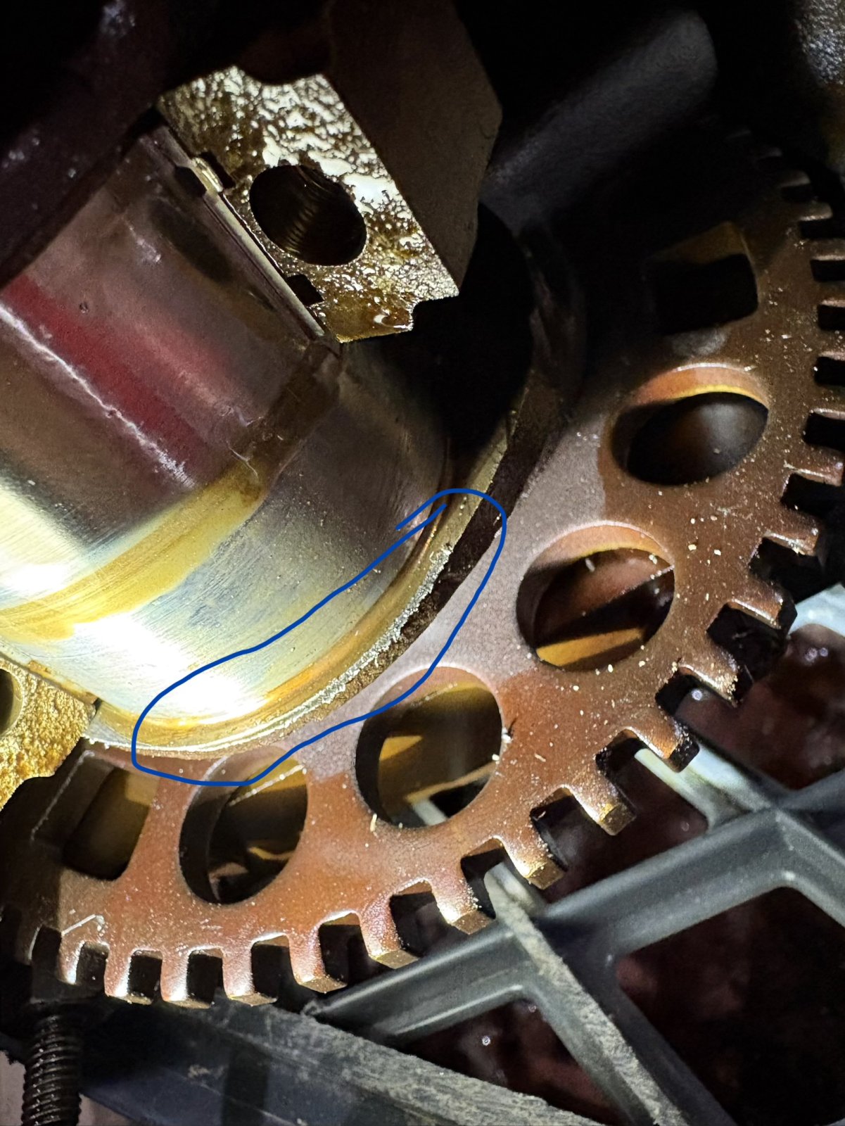

Pretty bummed out to be typing this. I think I have accepted that I just don’t have the time to dedicate, patience, skill, or proper tools to rebuild engines to this depth.
I made a couple whoopsies tonight when I was reinstalling the pistons. When I started to torque down the connecting rod caps at some point I realized I couldn’t turn the crank anymore. Wasn’t sure if this was just because of new bearings and pistons rings but google told me something was wrong so i started unbolting the rod caps. Found one of the connection rod bearings weren’t seated properly and now I damaged that bearing. Also between taking the cap off and on again I somehow scratched up the crank.
Idk how severe that is but everything I read online is pretty much “if it isn’t perfect, then it needs to be replaced” blah blah blah
Last but not Least. I somehow mixed up the caps and also found out that that’s a big no no. Once you torque down the wrong cap, it’s damaged? So I’m looking at new connecting rods now I guess
All in all I have some decisions to make

Sucks to hear, but you learned some things. Are those rods fractured? I assume so. If thats the case and you havent torqued them, should be pretty easy to get some back in order. They will only fit one rod, then the crack completely disappears.
Not sure I'd be very concerned with that little bit of scoring on the "Non-bearing" surface of the crank. Dont give up yet my man
I’m not exactly sure what that means lol
I did torque them then I realized I couldn’t spin the crank by hand anymore. Did some googling and I came across a few threads that pretty much said once they’re torqued, I’ve damaged them and I’d need to replace the rods. Maybe they’re overacting idk but so far I’ve ruined 1 cam bearing and 1 crank bearing so I have to buy them again lol

Ls engines have "fractured rods", meaning they are cast as one piece, then they break them. This creates a perfect piece. When they are assembled, you can't tell they are broken because they fit together flawlessly.
Here's an example I found on from a google search
A set of stock rods shouldn't be very expensive. Again, just a lesson learned. That's how we learn the most, when it costs money. Hell, I may be able to round you up a set. Let me ask around.
Edit:there's a bunch on eBay for cheap. Research which gen you have so you get the correct ones

well I know it’s a gen iv 6.0
Very interesting, I had no clue that they were 1 piece when they’re brand new. that explains a lot.
