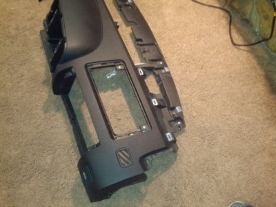

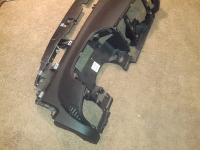

45,014
There's several problem areas, not to mention it wraps down at each end to the fuse box areas. I don't see it happening like I said. If you do it, I'd be interested to see how it comes out.
View attachment 199629 View attachment 199630
Those are the angles I haven't seen this dash from. Hmmm... It'll certainly be a challenge, but I'm still convinced it's doable. I didn't even use heat on the XJ headliner, other than the warmth it got from sitting in the sun.

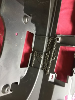

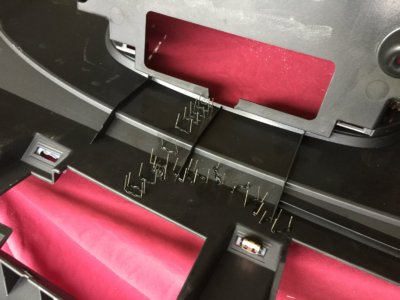

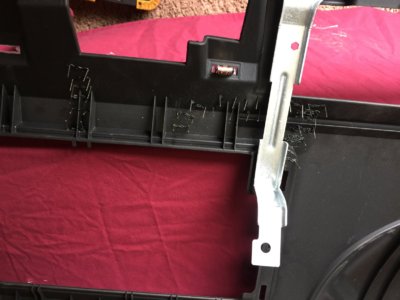

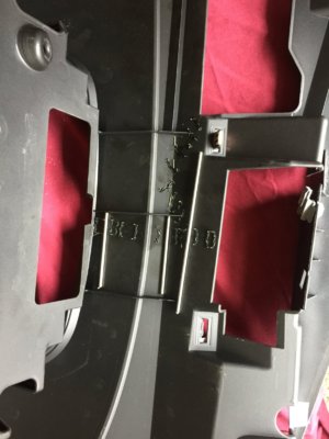

I repaired the main dash today. It didn't come out as good as the dude in the video did. But mine was broken to hell by the time it came out so I guess it's OK. I really needed another person to hold the cracks together as I stapled them. And the front flat dash piece is kinda looking bad now because I tried some different stuff to try and hide the cracks and made it worse. I'm thinking I might be able to fill or not fill the cracks and use adhesion promoter and paint it. Anyway, today's progress. I'll probably end up getting new pieces, these will drive me nuts I'm sure. We'll see how it looks once it's installed. Also, like I said, I'm going to experiment with filling and painting.
52,954
Not bad tho
Agreed. Pretty good for what you're dealing with, I'd say.
Agreed, just not what I was originally thinking when I watched the video. But then when I was removing it and it kept breaking I wondered if I would be able to save it at all. It's still better than the cracks it originally had.
