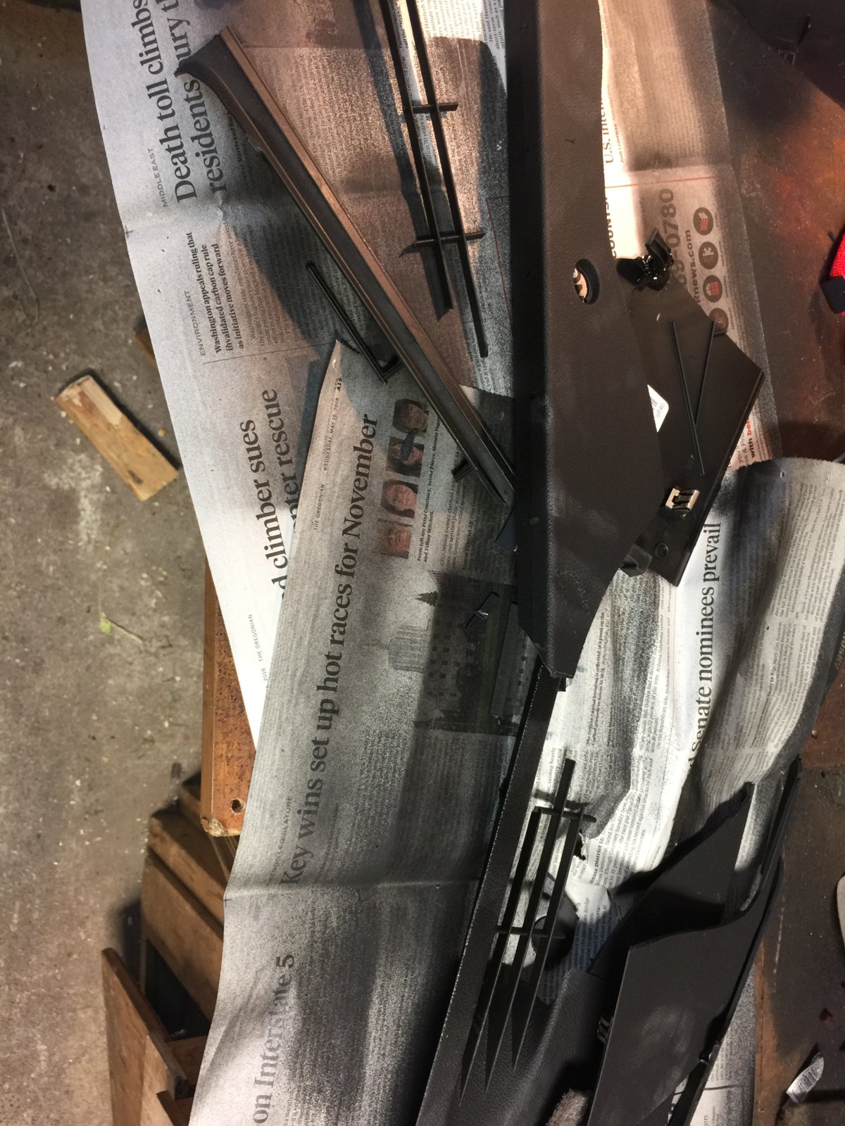

Well I tried the SEM texture spray and it was looking ok even though I would have had to do the entire dash, both pieces. And then spray them. I tried it on the flat piece that goes up against the windshield. It kept lifting in little areas, probably didn’t prep it right. But that piece had many problems and it kept getting worse. It was so brittle it kept breaking, first all the parts that hold the clips, then the grill by the vent, then the hooks that help hold it down. Then this happened. Whoopsy.

That plastic just gets brittle from sitting under the windshield. Those little vent grills are usually the first things to go. Can't save those.

Yeah there was no saving that piece. Terrible quality of plastic. And of course they know they have you by the balls on that part; my dealer wanted over $450 for it. I got it for $260 ish. Ridiculous.

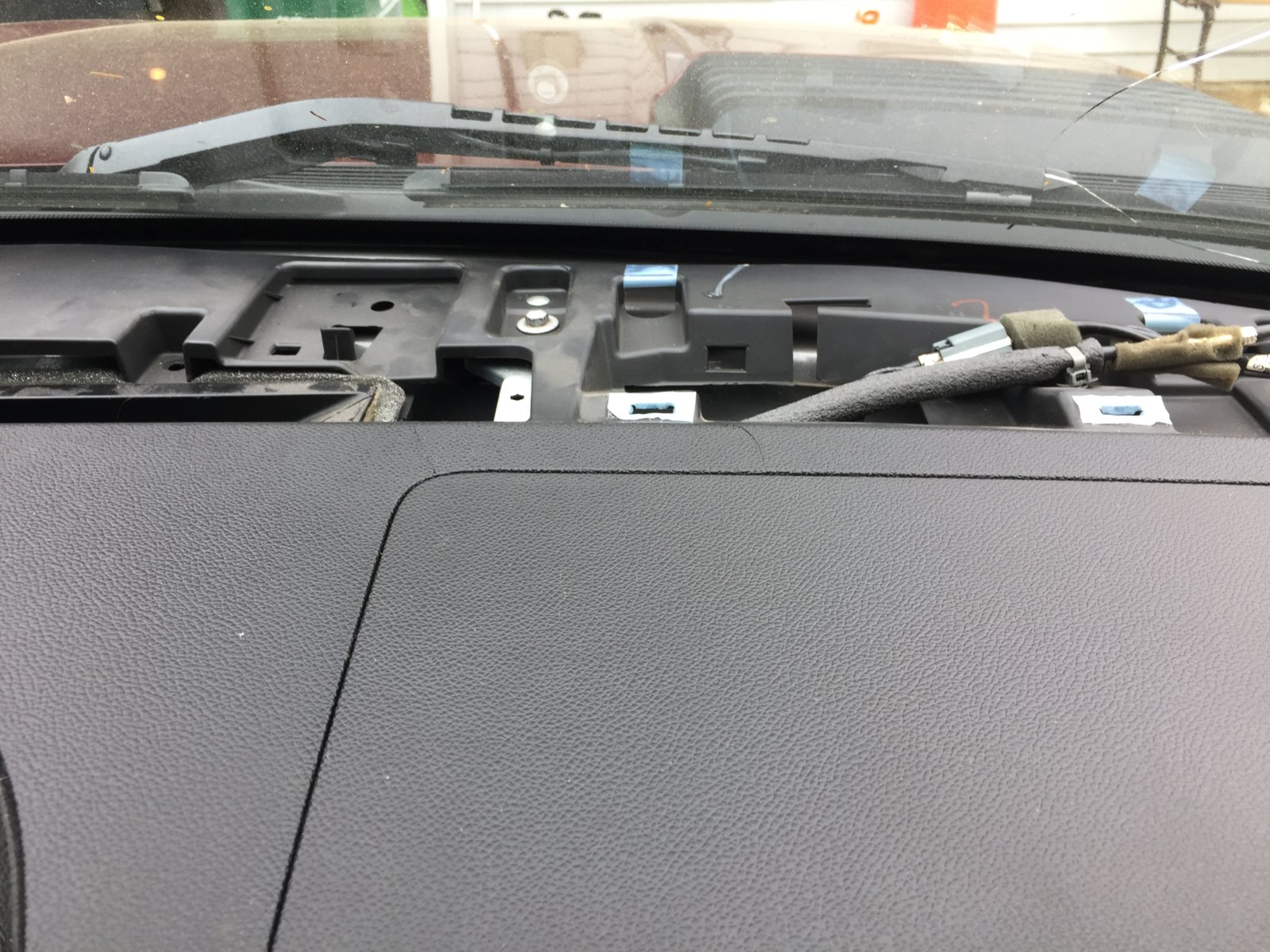

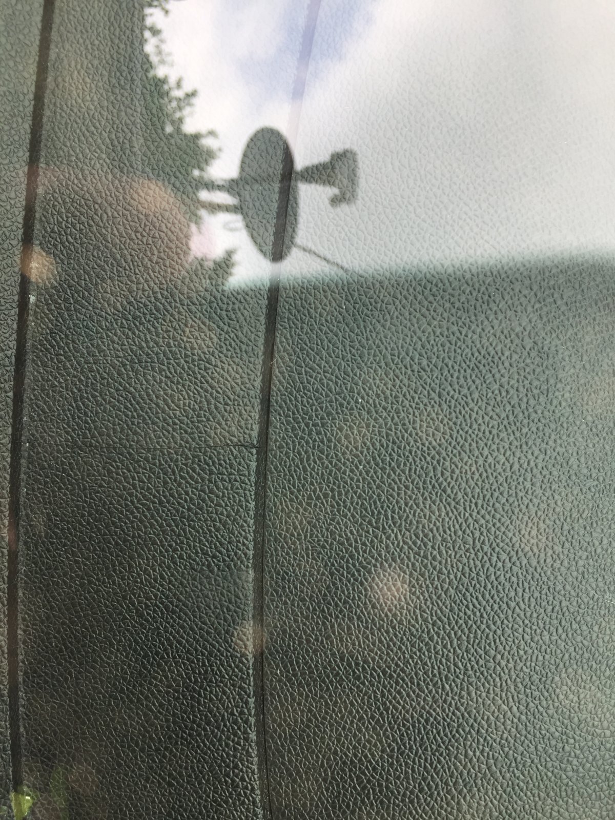

Well that was a lot of damn work, just to end up with cracks that are more closed up but still noticeable. Plus instead of one by the airbag I have 2 now lol. Oh, plus it cost me an extra $250 for the front trim piece which is still on order. I sent the stapler back to Amazon because I don't plan on trying plastic repair again. If anybody wants one, there will soon be a deal in Amazon Warehouse Deals for one but it will be missing a lot of staples. Next time I'll just replace the main dash piece. It was a learning experience and it goes to show that no matter how much research a guy does, shit can and usually does still go wrong. If you pull the dash on a pickup, drop the steering column or you'll bust the dash trying to maneuver it around the steering wheel. I didn't find any videos on pulling a dash on a pickup so I didn't know. I'll be doing this again soon because these cracks will drive me crazy. I can probably replace the dash in 2-3 hours now that I've done it once.

Rack it up to experience. Still looks better than it did. Go run the beast up and down the block a few times and get smiling again.

lotta work man. nice job though. those dash's are notoriously cracked on that body style. my buddies Tahoe is the same, only worse. He just threw a nice dash pad on it.
And those OEM textured plastic pieces are a b*tch to prep to get really paint to stick on em.
