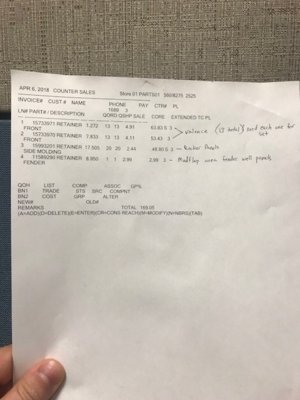

Couldn't Figure out the PM of a pic so I'll just post it.
The valence PN you need both clips. One is the retainer and one is the actual clip. 13 total for the whole valence.
The retainer side panels PN he said it is 20 total, but he wasn't positive it was 20 per side or 10 and 10.
The Retainer PN for the side molding he didn't give me a total, but I think those are easy to count. Just priced out 1.
Prices are listed as well. The valence ones are expensive from the dealership, but the clips from amazon didn't work so trying to find another set before biting the bullet for the dealership.

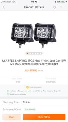

So after much searching, I finally found a website I had been looking for on the forums for awhile. You order lights from China. Seems fishy but I figured what the hell. I just order a small pair of lights to test it out. Only $15. Lets see how long shipping will take.
I am planning on replacing the stock Fog lights with LED cubes, but I didn't want to buy them just yet. I decided on these 12V 4 inch 18W work lights. Planning on mounting these under the rear bumper as aux reverse lights. I always have issues backing up at night with my 5% tint so these should be a big help.
Will keep the info updated to show how long ordering and receiving takes
Ordered-4/25
Update: Shipment Notification-4/26
Update: Received-4/27

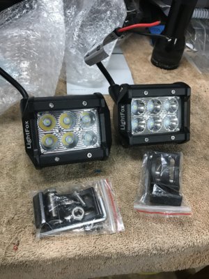

So I received the lights today. 2 day turn around so I highly doubt they were in China ha.
Lights look good. Small minor blemishes from a visual standpoint but I don’t need show quality. Looking forward to seeing how good they work
Hope to get them wire up tomorrow or next weekend.

I'd put some silicone around them. Just in case the gaskets are crap.

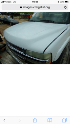

Finally found an HD hood. It's in my hometown so hoping my dad will make the drive and go pick it up for me! I think an HD hood in Bermuda Blue will look badass!

If it helps--it does fit in the back of the Hoe.
He has a truck. I’ll be driving through town at some point this month from TX so he’s going to pick it up and drop it off at the body shop for paint and any fixes it needs

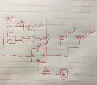

On my other Mod in the works, the Aux LED reverse lights. I'm trying to figure out if I have the right wiring circuit planned out. I have researched and watched videos so I think I have it diagrammed correctly. Any thoughts or obvious mistakes anyone sees?
I'm going to double check with the company that puts in all our police strobes and lights in our unmarked vehicles. They do a lot of wiring and I'm sure this is simple for them to double check my diagram and give any advice.
