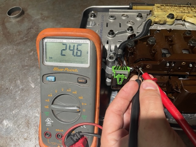

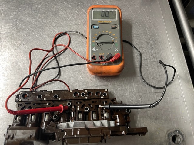

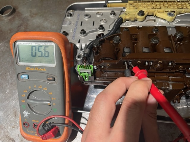

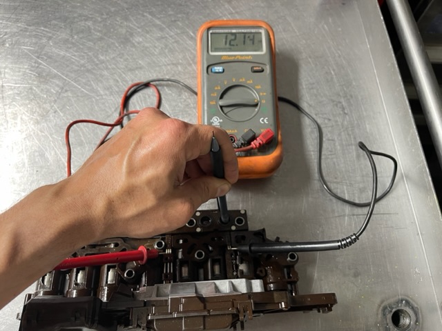

Quick primer on TEHCM resistance testing:
> Review this article for the TEHCM testing procedures.
> Using a multimeter to test resistance for shift and pressure control solenoids (shift solenoids: 20-40 ohms; line pressure/clutch pressure control solenoids: 3-8 ohms).
shift solenoid
Pressure switch resistance (closed circuit): .7-1.9 ohms ( this is pressure switch #1 which sends a signal to the TCM reporting the status of the 3-5-R clutch reg valve in the valve body)
Pressure switch resistance (open circuit, pressure applied to switch) 11.5-12.9 kohms
> Use pencil eraser to put pressure on switch to open circuit
> Pressure switch resistance should drop back to .7-1.9 ohms or so when circuit is closed again (may vary a bit but should not be significantly different).
If any of those pressure switches are not reading like the above when you do this test, then the TEHCM is bad and should be replaced!

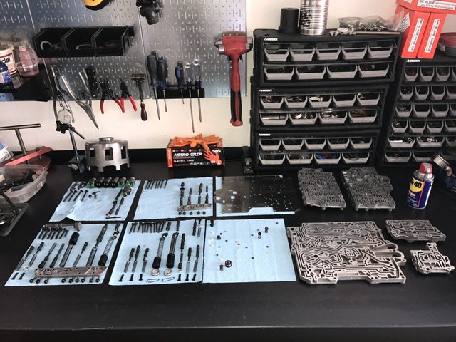

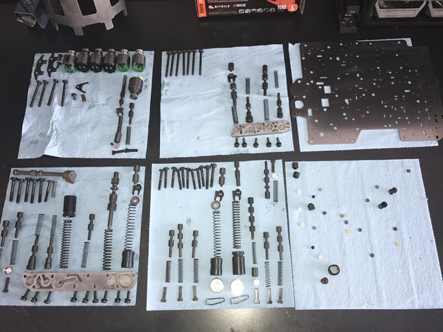

So I used Sonnax and Transgo parts to repair the regulator and upgrade the drum to a billet part. All new frictions, steels, bearings and seals.
I had no idea that the 6L80 was derived from a ZF design, but looking at the assemblies in the 6L80 from your video there are a lot of similarities. Thanks for sharing your knowledge - I’m grateful.

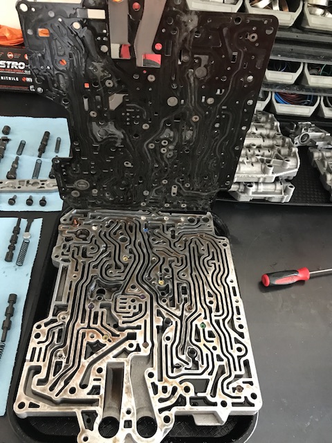

Nope, was referring to the valve body assembly in the ZF5HP19 - has literally 20 or 25 little restrictors that lie in their respective locations in the channel plate and will stick to the separator plate if you take it off without knowing to use a pick to unseat them so you know where they go. Each restrictor has a small orifice in the center and there's a bunch of different size orifices and would be damn near impossible to know where they went if you didn't keep track (unless you build those units every day).
Here's a few shots of the vb
Restrictors are at bottom right
Spacer plate lifted off channel plate to show all hydraulic circuit orifice restrictors
