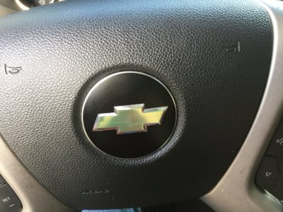

I got my steering wheel emblem today and cheated it on. I didn't want to pull and disassemble the airbag to install it so I poked a hole in the center of the old one and stuck a pick in and pulled it off so I didn't damage the airbag by prying around the edges. Then I cut the tabs short and made sure it pushed all the way on, then pulled it off and added a big blob of black RTV silicone in the center and pushed it back on. I could feel it squish the silicone so I know it won't come off. Total time to repair was less than 10 minutes.
