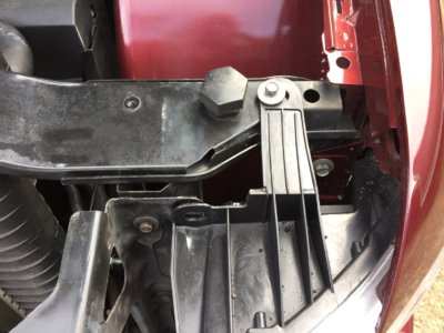

I got the headlights today but they were TYC not Depo. I bought them through Amazon but I looked up the third party seller on Google and called them. They told me they were temporarily out of the Depo and sent these instead and tried to tell me these were more expensive. I told him I was using them for retrofits and I knew the Depo's would work but wasn't sure about these. He checked and said he could send me the Depo so I printed out a return label he emailed me. He said as soon as the label is in the system he would ship the right lights. I hate companies that pull a switcheroo. Sneaky bastards.

I sent them back since I wasn't sure if the projectors would fit right. It's my first retrofit and I didn't want to chance it since I have no clue what I'm doing lol. He's supposed to ship the Depo's today.

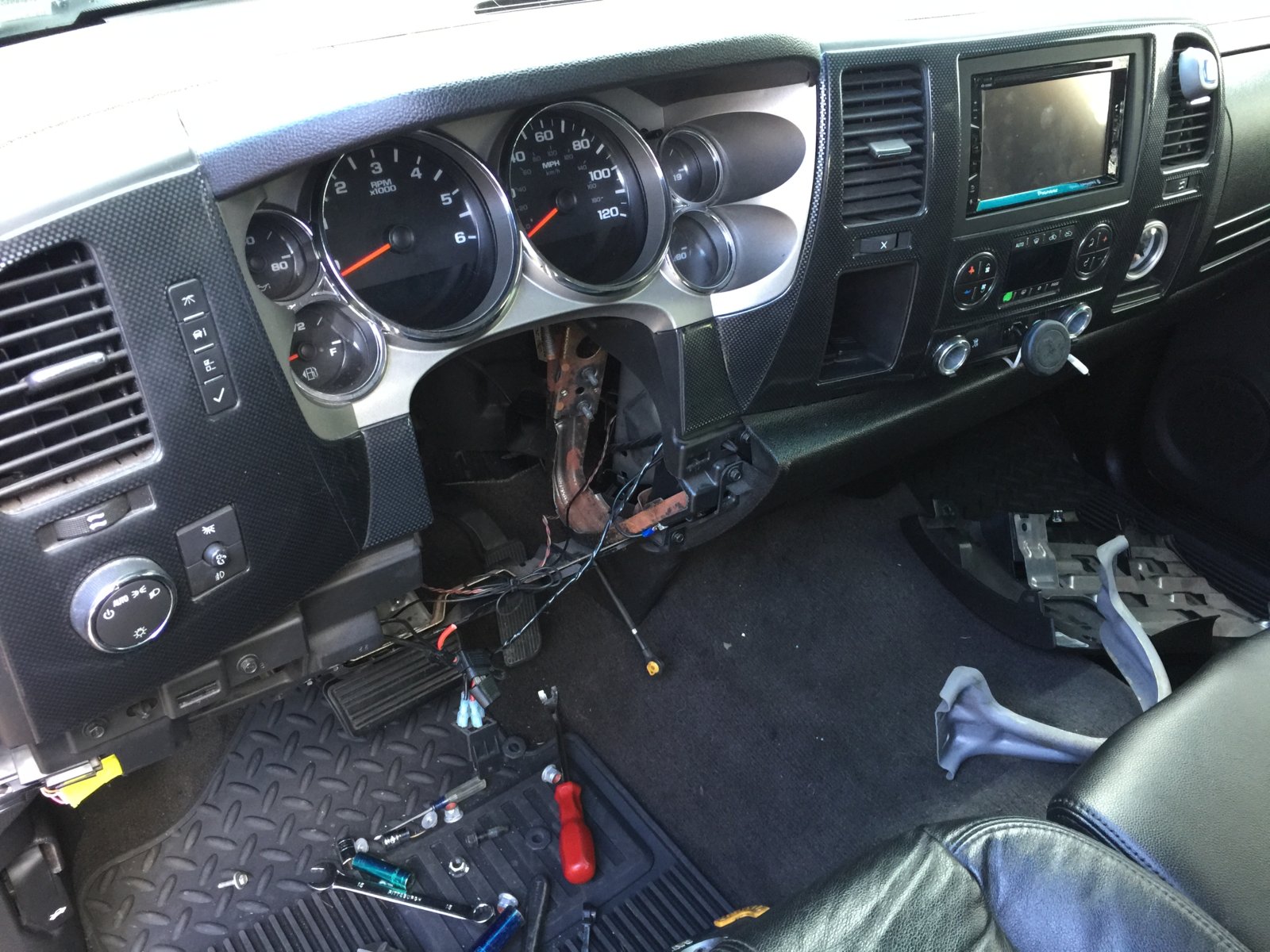

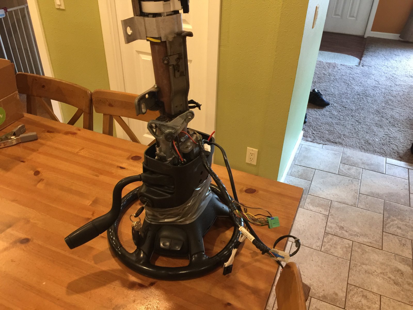

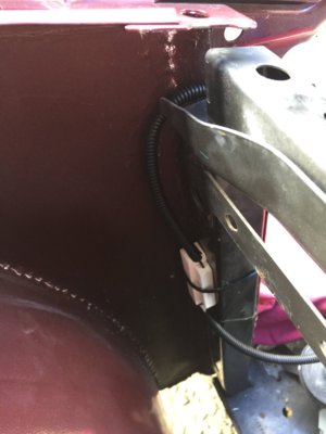

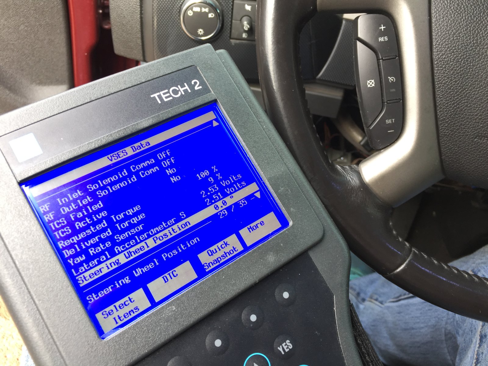

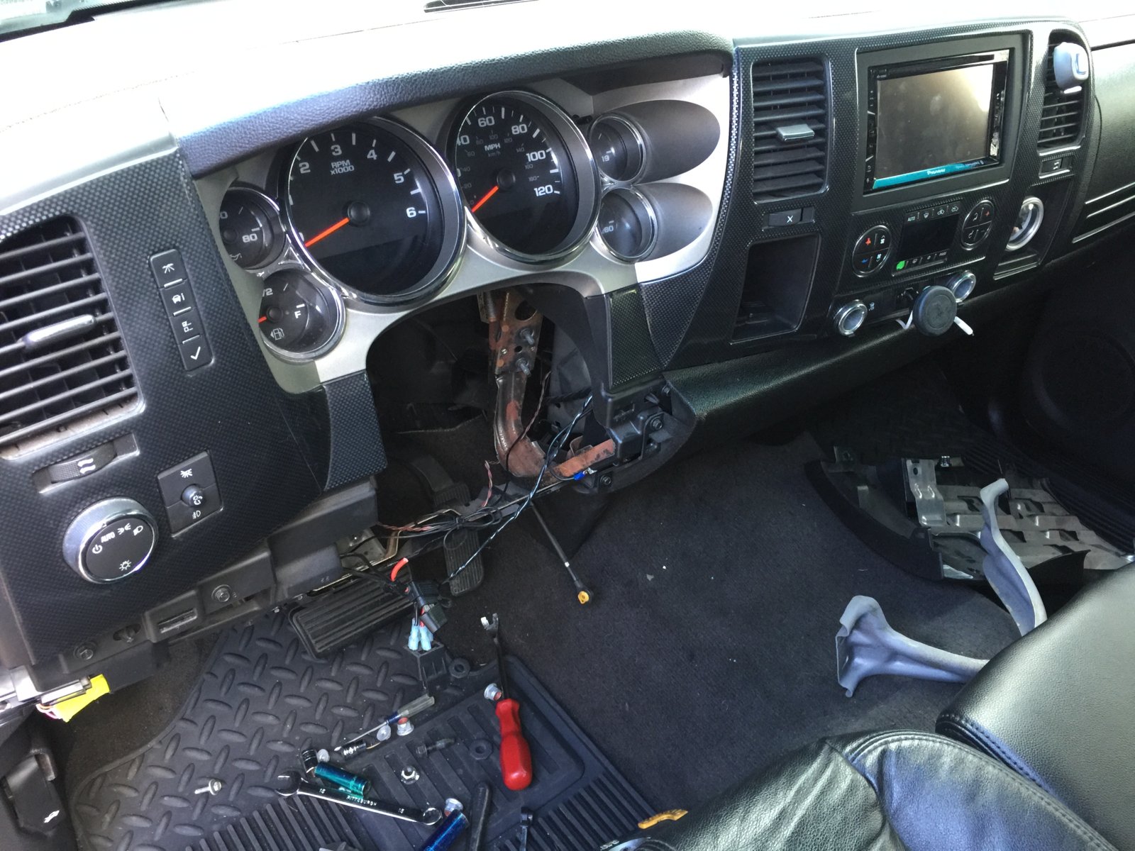

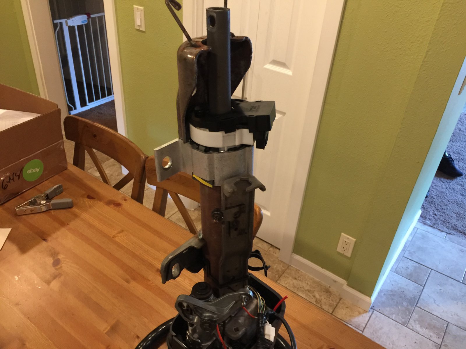

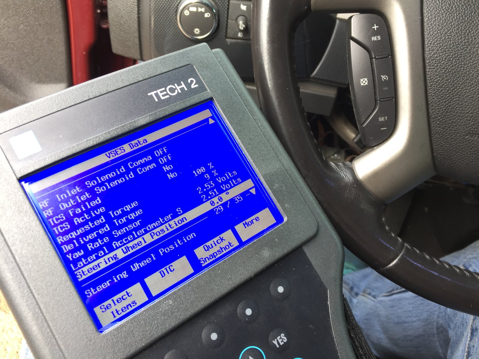

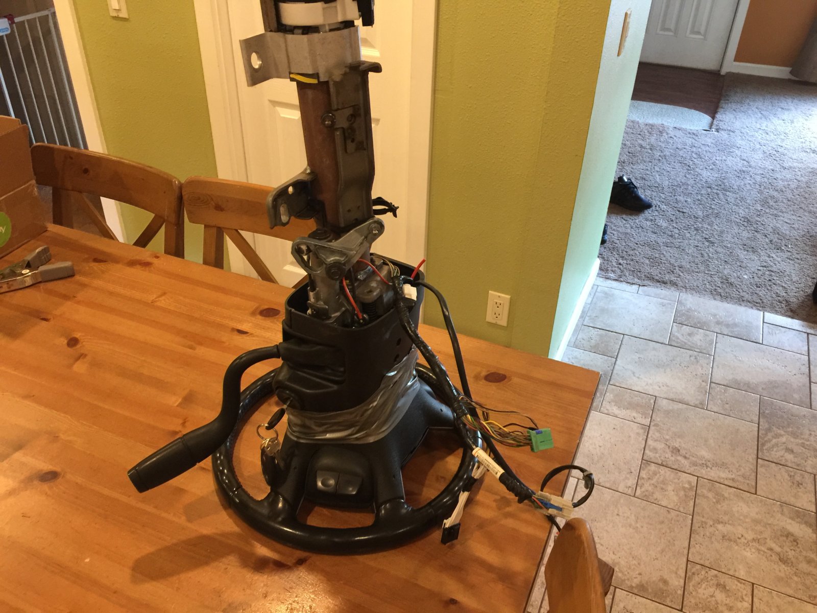

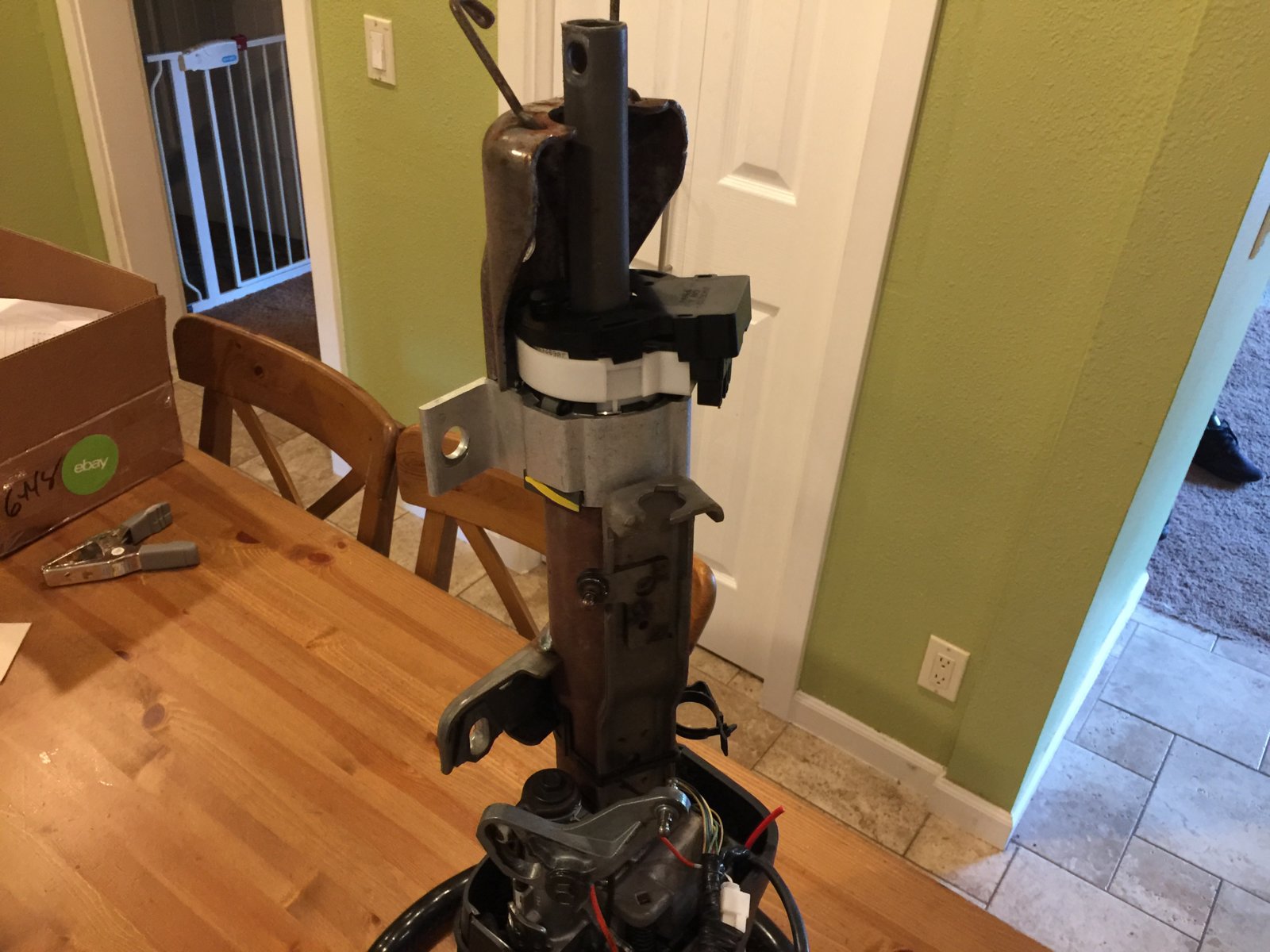

I just finished replacing my steering position sensor and for the first time since owning this truck, every single dash warning is gone. I can't actually believe it. That sensor fixed the stabilitrack and traction control. Sweeeeeeeet! That was a chore mostly because I'd never pulled a steering column before and my shoulder still hurts when I get into some of those positions. But it's done. Checked it with the Tech 2 afterwards and it reads correct. And yes I used duct tape instead of the stupid GM steering wheel lock tool since I didn't have it.
View attachment 193854 View attachment 193855 View attachment 193856 View attachment 193857 View attachment 193858
Hell yeah red, thats impressive [emoji106]

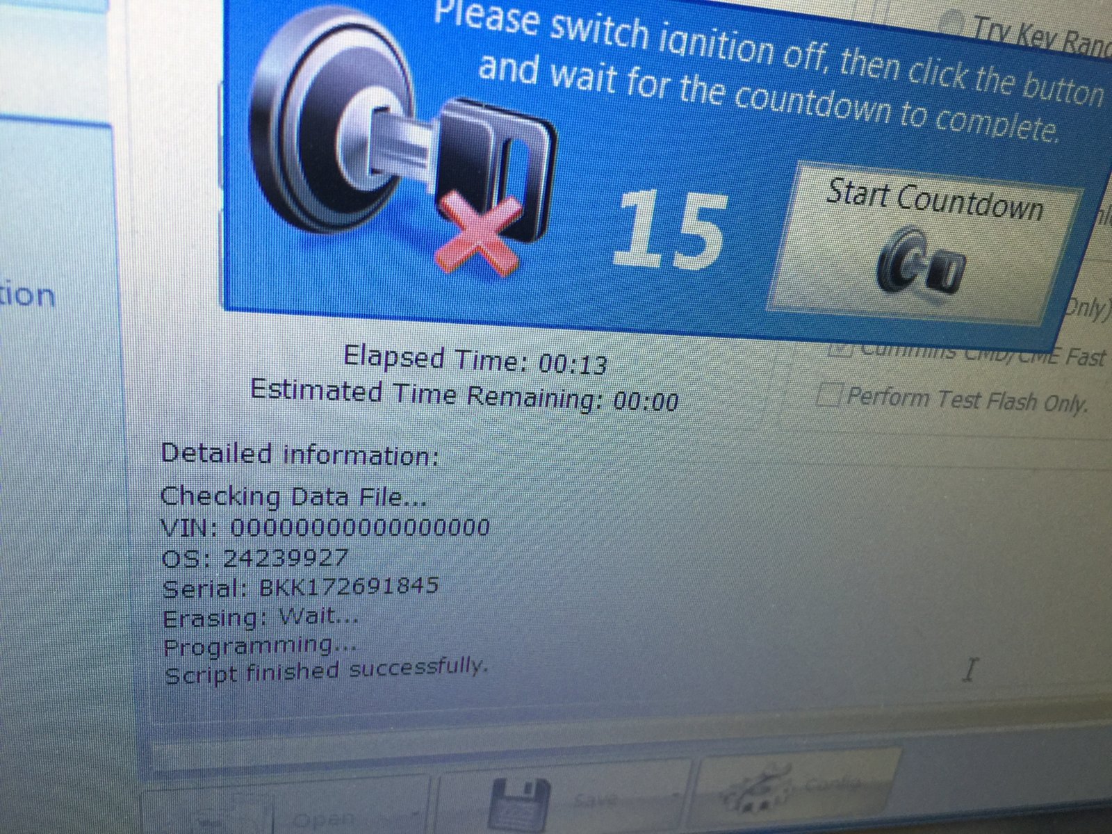

Dammit. I figured since I'm on a roll, I'd try programming my transmission tune again. I downloaded the setup files again from my e-mail, figuring maybe something was wrong the first time. I re-ran setup which erased the tune files in the autocal and replaced them with the fresh ones from setup again. I went out and loaded the modified TCM files. Trans went into limp mode again. Traction control and stabilitrack warnings back on but this time it's because there's no communication with the trans. I know now the modified TCM tune file is bad. So I loaded the stock TCM tune file back in....trans is still in limp mode, no communication with TCM according to the Tech 2. AAArrrrgggghhhhhh! The stock TCM file is bad now too. I must have a corrupted quick setup file from my e-mail. I called BlackBear and asked them to look into it. I sent them an e-mail 2 days ago about the modified file but not it's more urgent since both files for the trans are bad. Hopefully I don't need a new TCM although they're only about $80 and I have a Tech 2 to program it to my VIN with.

A big shout-out to Justin @BlackBearPerf ! I was ready to order a TCM, figuring mine was fried for some reason since the Tech 2 wouldn't communicate with it and the trans was in limp mode (no shift position indicator, service stabilitrack and traction control warnings lit up again) but he said it couldn't be dead from flashing the tune. He said I could use my laptop and "pass-through flash it". I actually had a used TCM ordered on Ebay and had given my VIN and CC info but called him back and cancelled. Justin sent me a file to use with my laptop along with instructions on how to do it. I had my laptop with the autocal connected to it and the truck, my tablet for reading the instructions, and my phone to take pictures of any messages in case there was trouble. That was a lot of stuff. All it said was good. Trans is back, warnings are gone again. Yay!

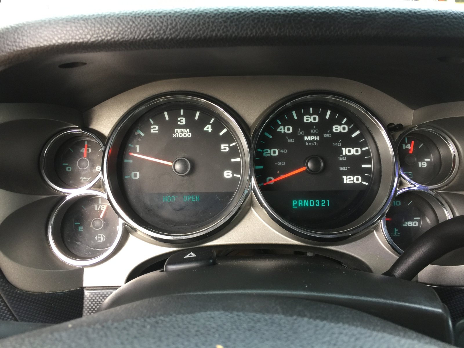

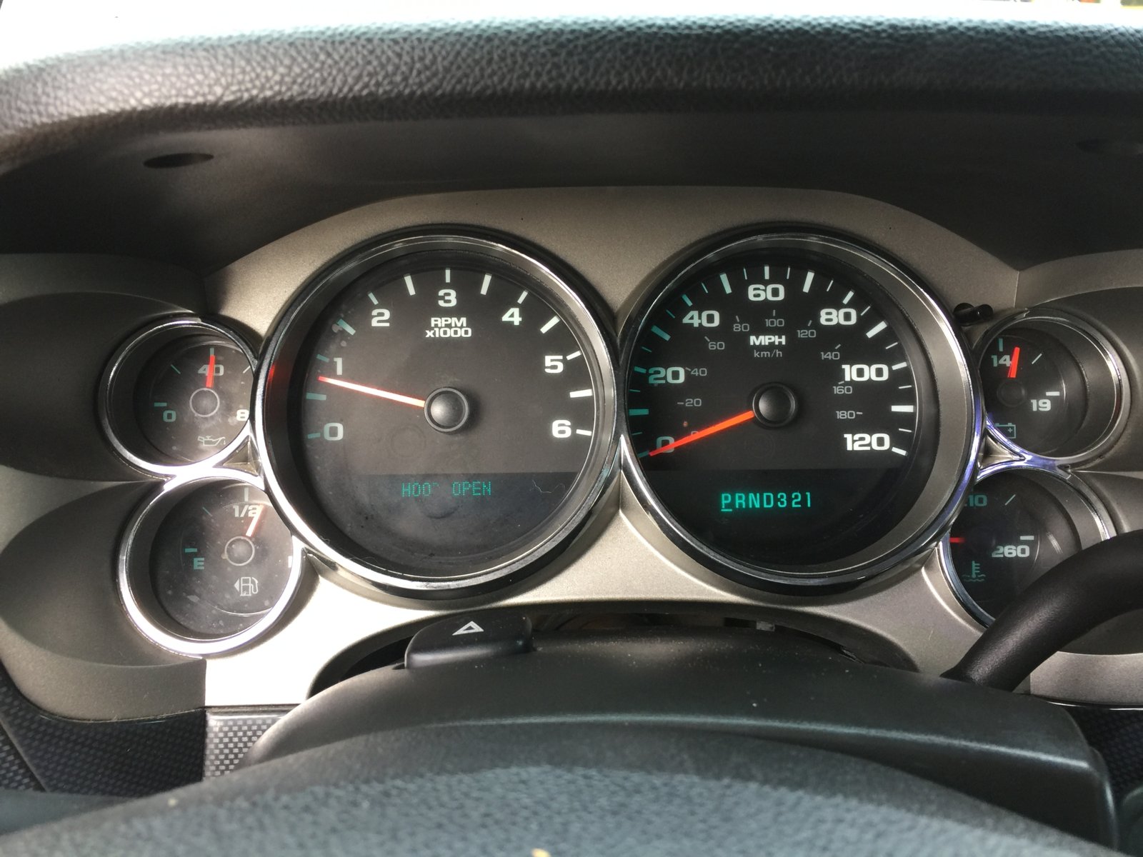

I was just out cleaning my gauges and installing a couple accessory plug covers in my dash. The engine was running and I was listening to the stereo enjoying no warning lights and suddenly the traction control light was on....momentary feeling of oh shit not again...then I remembered the button for it was right there by the accessory plugs...I had hit it by mistake. Idiot. I tell you, when you've been driving with those warnings on for what seems like forever (the PO had them for over a year) you get jumpy lol. I hate warning lights.

Warning lights are right up there with chrome! Lol

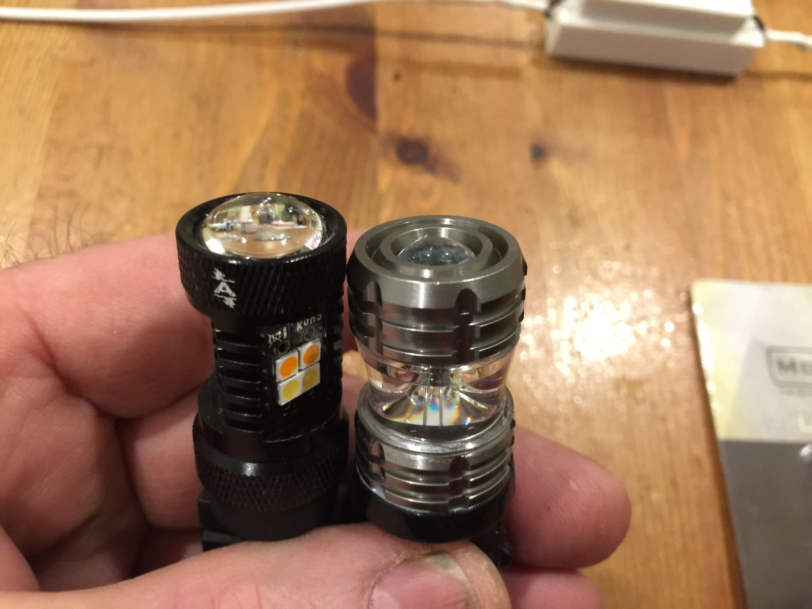

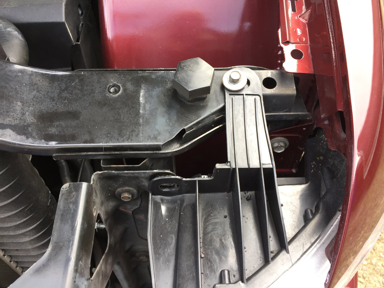

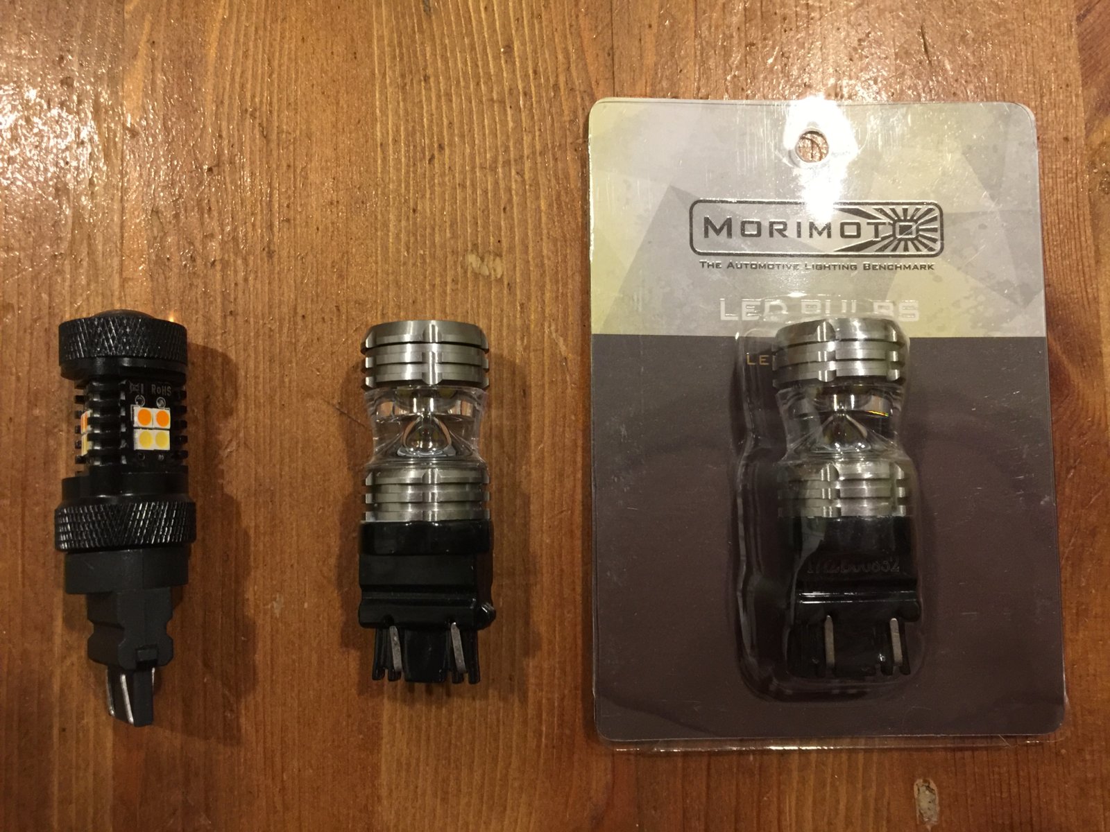

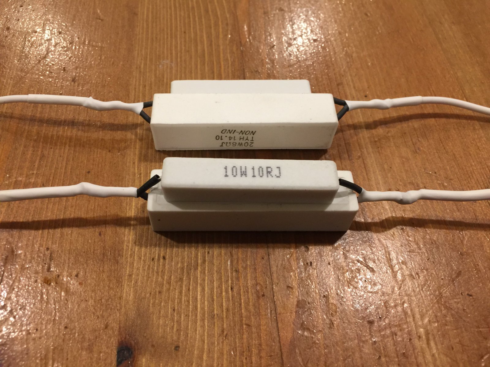

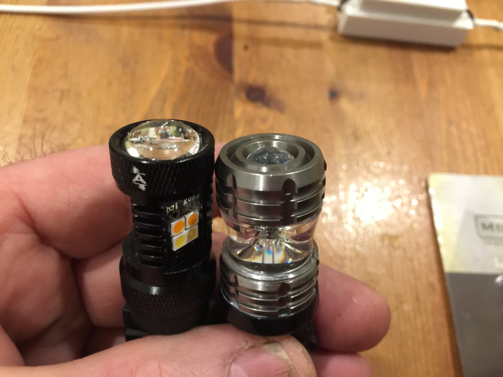

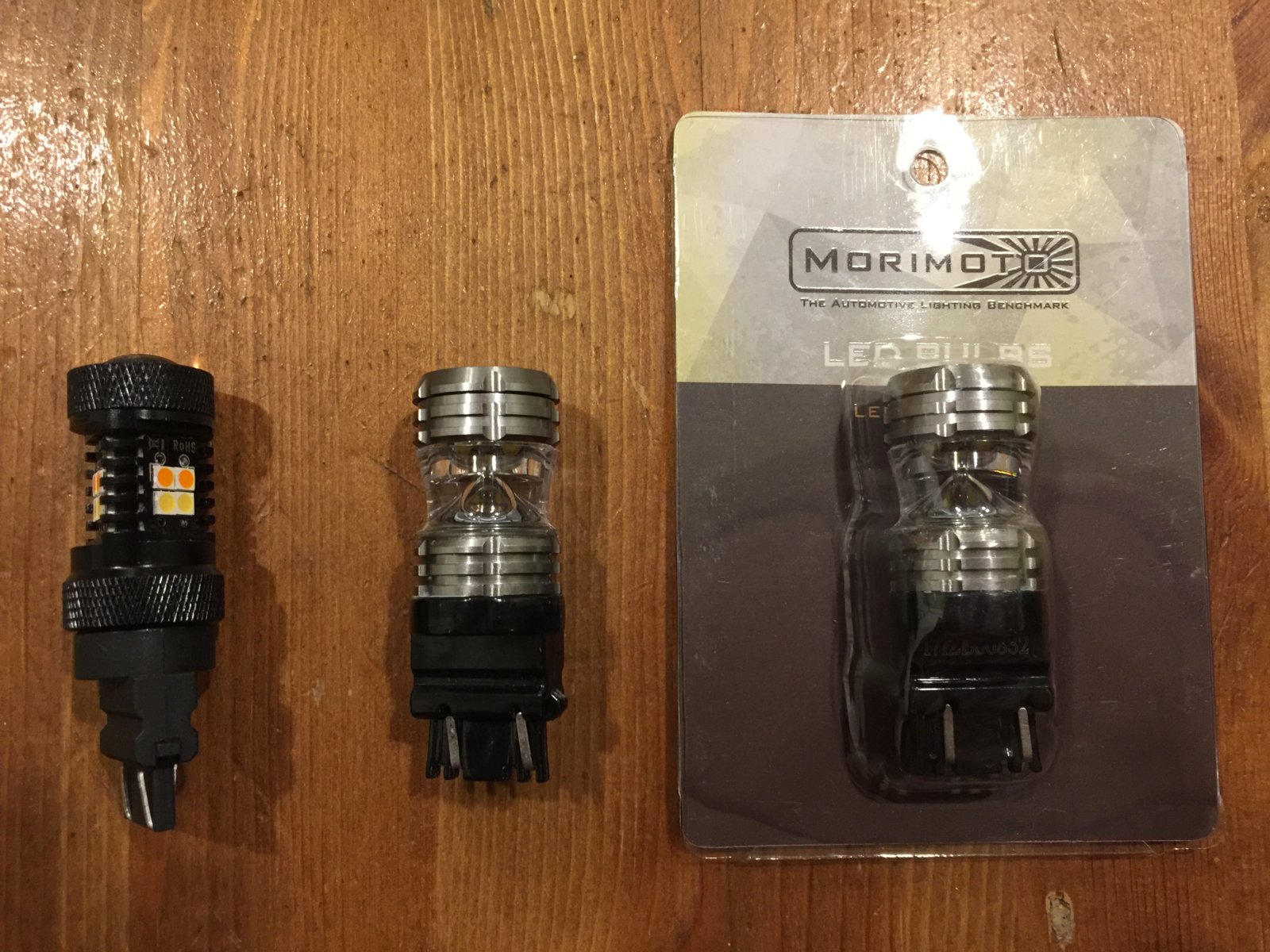

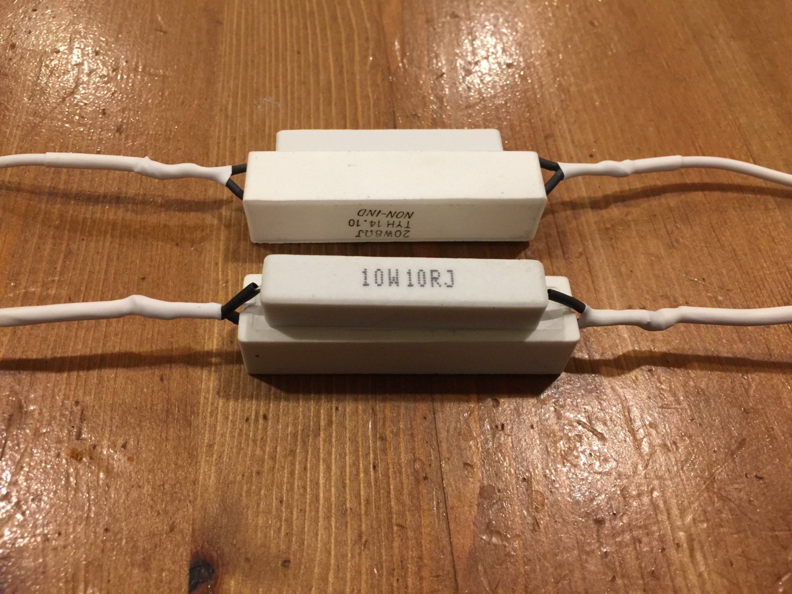

Gathering parts for the headlights. The TRS retrofit order will be here next Friday; they just shipped today. The Depo's will ship tomorrow so they should arrive about the same time. I made my resistor packs for the front switchbacks which came today. These Morimoto's are bad mf's but they should be for $45 a pair. The Acme's are cool too; both are aluminum housings and solid as hell. Oh, and the color match spray paint and adhesion promoter came yesterday.

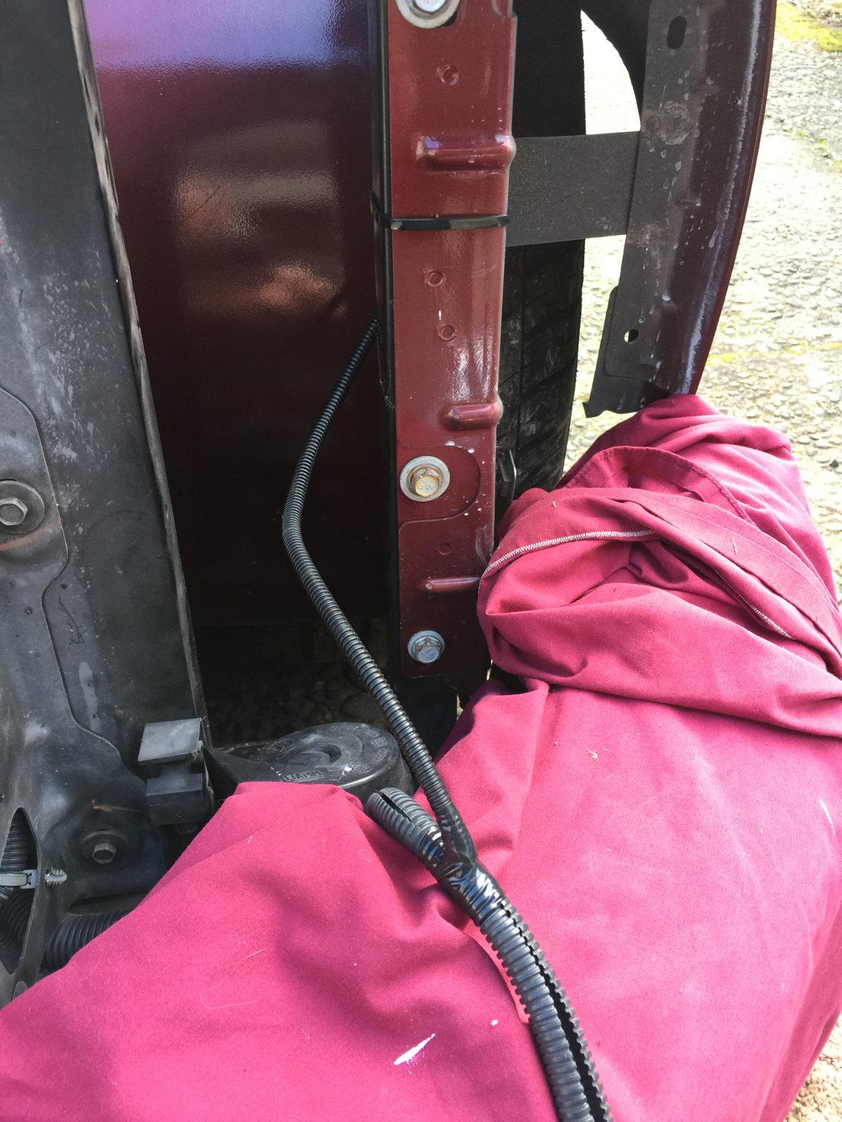

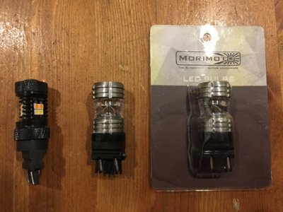

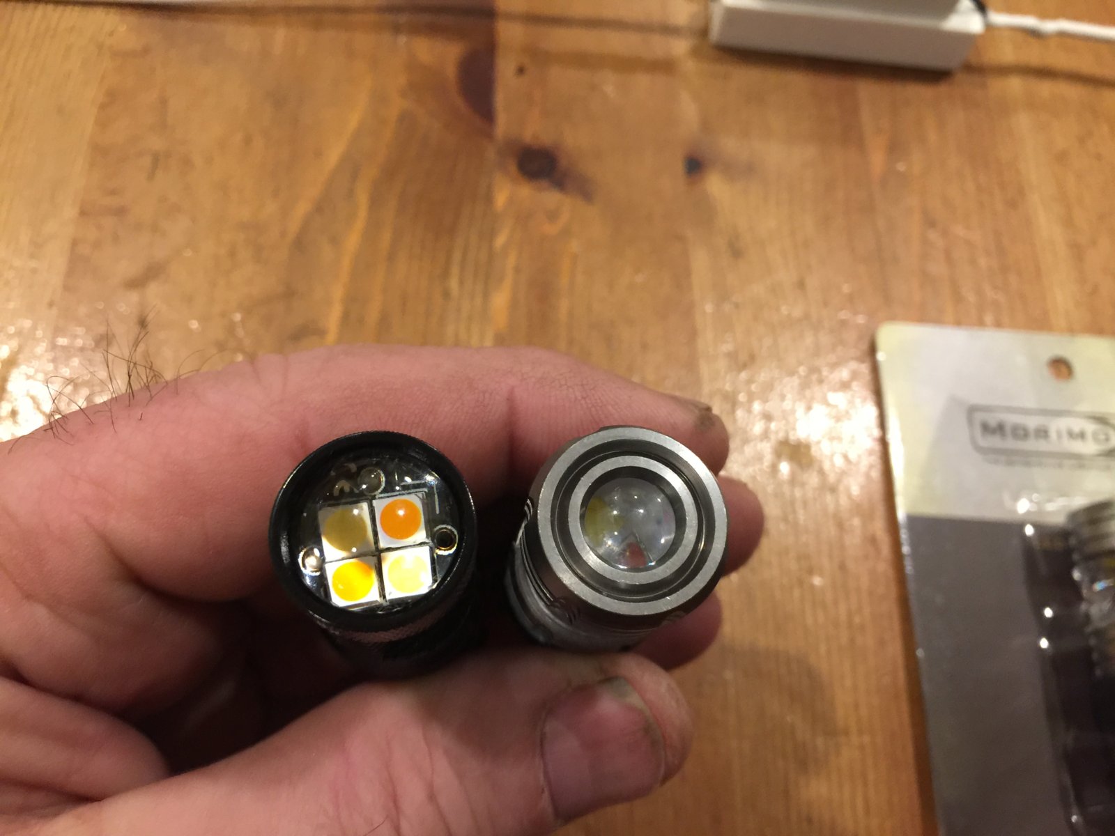

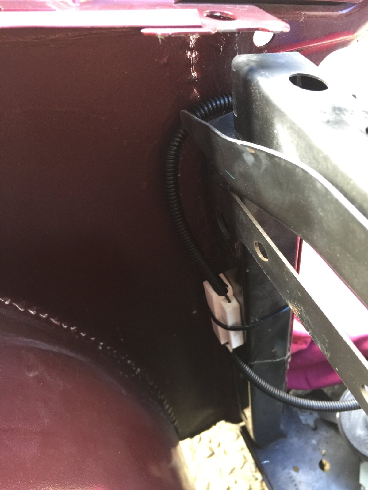

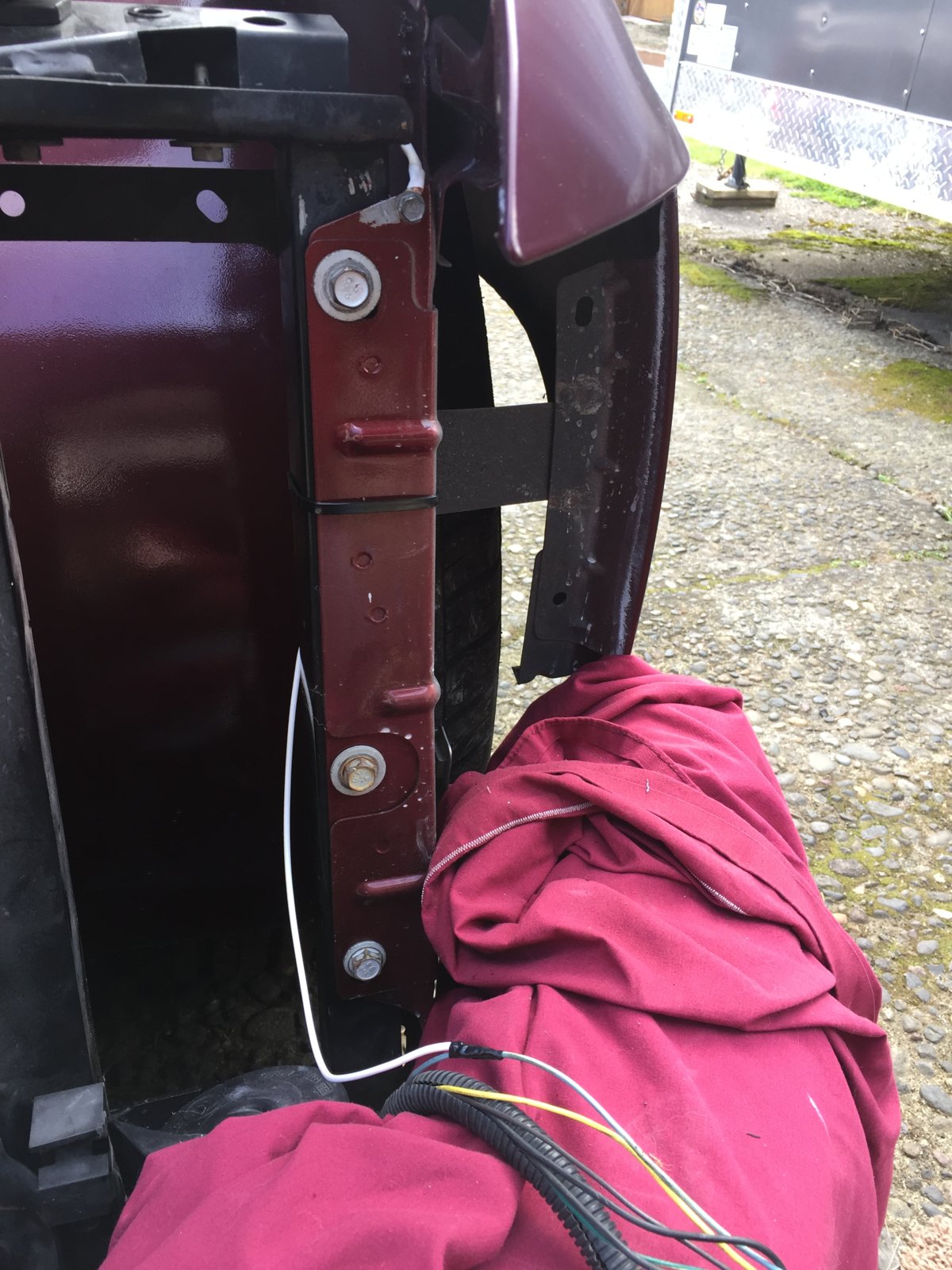

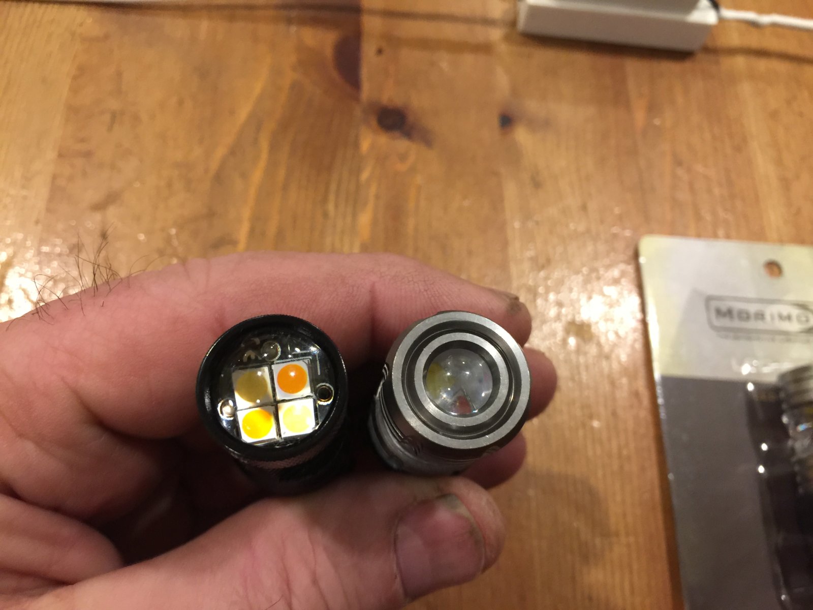

I did the front turn signal LED conversion today but ran into trouble trying to use both sets of switchbacks. I had to decide between the Morimoto's or the Acme's and guess which won. I ended up with the Morimoto's in the lower slot and white 3157 LED's in the upper slots. And funny thing is, if the key is turned on but the engine isn't running they still hyperflash. But with the engine running they don't. Unless I run 2 switchbacks on each side. Then they do no matter what. I tried to make the wiring look factory but it may actually look better. I'll get a nighttime vid later. The DS headlight only had one bolt holding it in. It was missing the one behind the grill and the one inside the inner fender. The passenger at least had 2 bolts.

Why do leds do that. I noticed my interior lights do same... well not hyperflash but if you hit the map light with no key its dim and flashy but if you turn knob for all it works fine without key. Works normally when running...i think @Fosscore mentioned that also... its just dumb...
