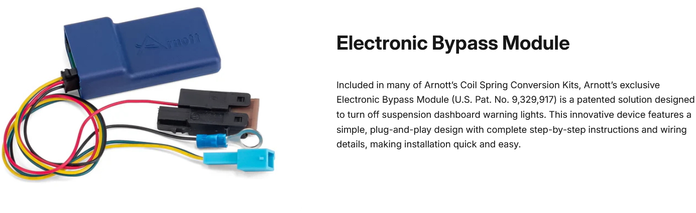

My '07 Escalade came with the RPO-Z55 air ride set-up. A prior owner either replaced or by-passed the rear air-ride stuff.
I just read that there are one piece bypass modules that will prevent the suspension warnings from showing on the dash. The truck drives ok, I'd just like to stop the warnings.
Do y'all have any help with this?
Thanks
Here's one example...

They say they don't sell the module by itself. Any ideas from y'all?
