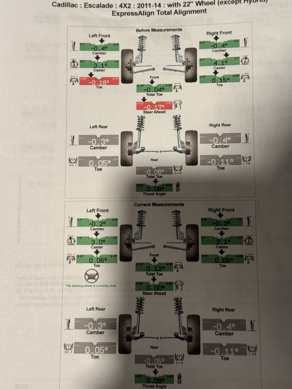

Here’s the last alignment.
I suppose I could try giving it more caster, I've never really tried that. Google's AI says:
"More caster, specifically more positive caster, generally improves a vehicle's straight-line stability and steering feel, making it more resistant to wandering at higher speeds and providing a more planted, confident driving experience. However, it can also increase steering effort, particularly at low speeds."
Too much toe in. Go to zero. My 2007 with 280k settled in from twitchy to chill when I went from .3 degree toe to zero. About a half turn of the tie rod, and Bob's your uncle. Cheers.

The 2020 I was thinking about going to look at this weekend sold, which is probably a good thing since I’ve been talking crap about them since 2016 and the suspension is so similar to the 900 that it might have the same issue I have here. I still can’t decide if I want to put more money into this truck to try and fix this or not. KBB private party value in excellent condition is only $12k now. That honestly makes me sick about how much money I’ve put into this truck because I kept saying it was cheaper than a new one. I am definitely buying something low mileage next that doesn’t need to be restored/rebuilt, whenever or whatever that ends up being.
If I do try more with this truck, I believe my options are:
Play with the alignment specs.
Replace steering gear with the new aftermarket.
Raise ride height to stock front and 2” rear drop.
Fox coilovers with GM non-Mag Ride rear air shocks.
The steering gear seems like the most likely culprit since it’s the only used part that’s on the truck, but aftermarket “replacement quality” parts are usually crap, in my experience, so I’m a little nervous to spend $600 on that.
Raising the ride height may or may not help, in theory, drop knuckles are supposed to maintain the stock from geometry, but who knows. Raising the ride height may be necessary to play with the alignment, though, because the tires will probably rub a lot more with a high caster alignment (due to their physical location in the wheel wells, they already rub now but I remember figuring out the current specs rub the least).
I’m not convinced the coilovers will help my issue but I found a good deal on them right now and they should give it a cushier ride that might be nice. I can swap these to a K2 if I bought one down the road (deleting the Mag ride would be one of the first two things I’d do to a K2 if I bought one since they ride so rough).
