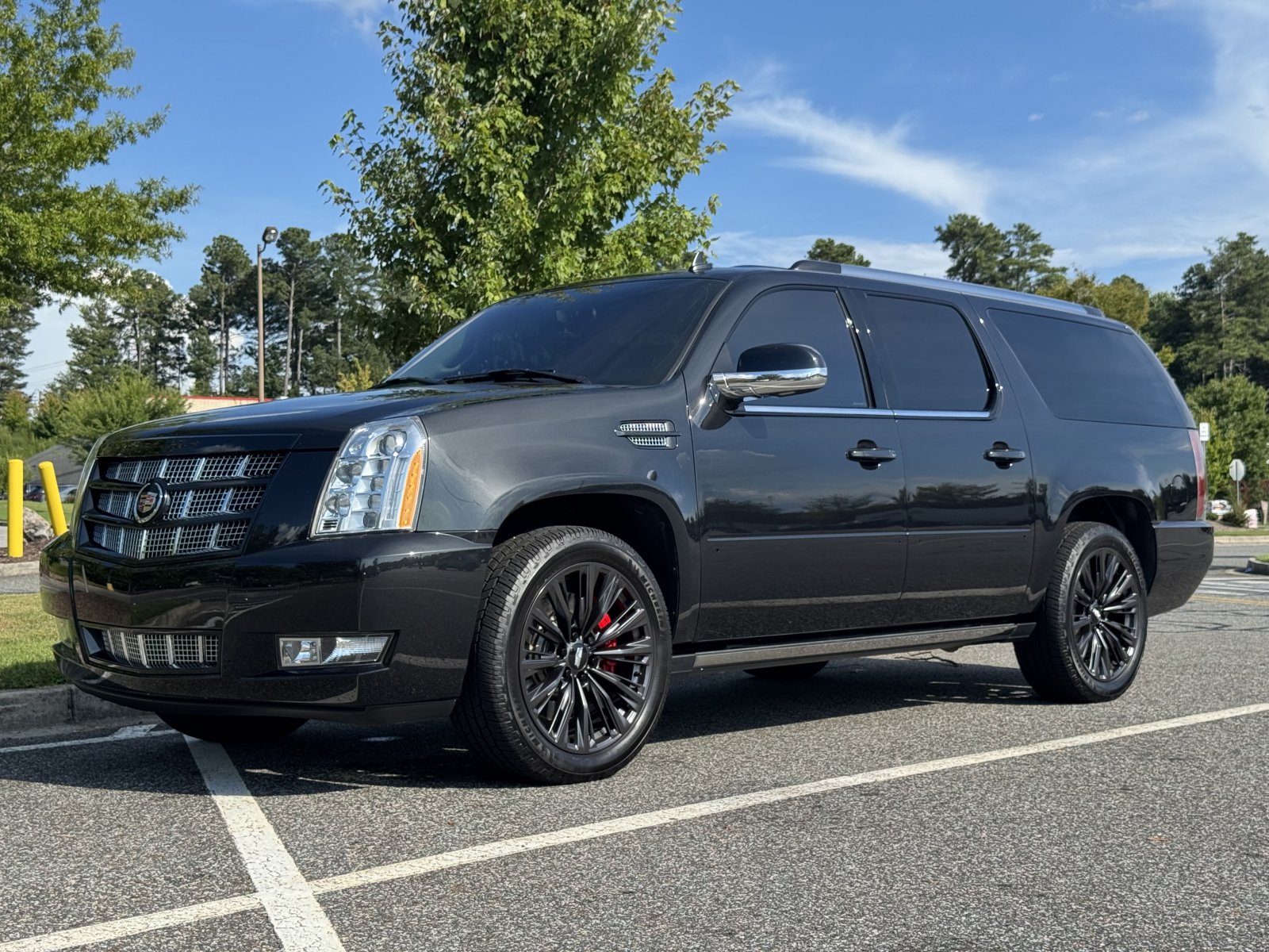

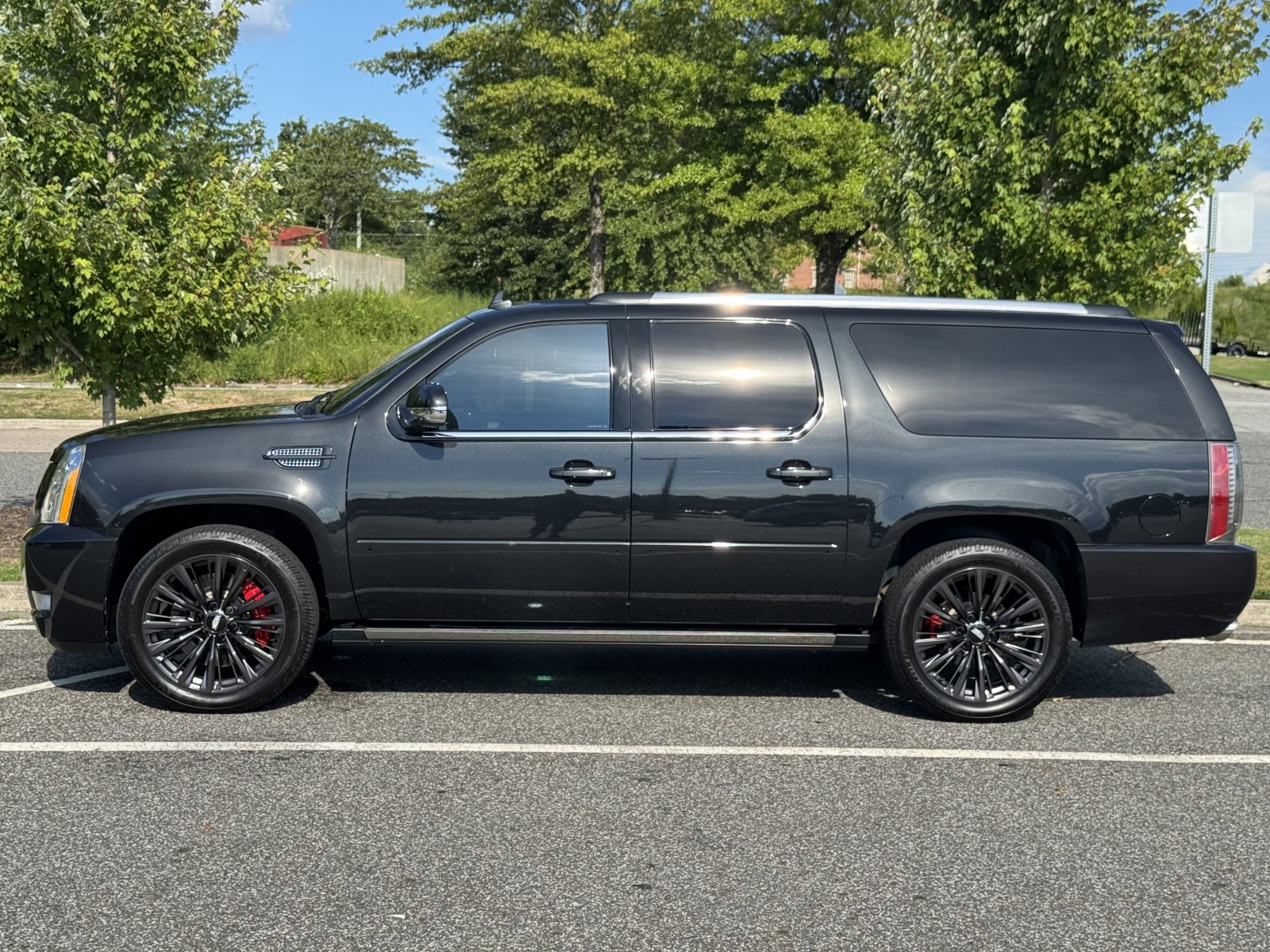

I am not sure if ours is “fixed” because we haven’t taken any long trips, but I do believe it is improved. I did the Fox coilovers, GM rear air shocks from the K2 trucks for 22” wheels, put the stock steering knuckles back in to put the front at stock ride height again, changed the rear springs to Maxtrac 2” drop springs with the matching shock extenders, removed the rear lower control arm relocators, installed the Energy Suspension steering gear bushing - right side only (because I already have the gel filled K2 bushings installed), and did a custom alignment with higher caster.
It still had a vibration so I ended up replacing a bent left rear axle shaft, warrantying three tires, and balancing the wheels four times in a week. I haven’t driven on the highway since the last balance, but the rear brake pulsation is already back even though I machined the rotors when I replaced the axle, so they may just have to be replaced. The vibration was one of my huge issues on the last long trip so this will have to be sorted for me to be happy.
I like the Fox’s a lot, they are definitely more compliant and comfortable than the Mag Ride. They pair well with the feel of the rear GM air shocks and Maxtrac springs. The truck still has the same “character” so don’t buy them expecting it will make your truck feel like a new GLS or something. It doesn’t handle as well but I would definitely put some of that on raising the ride height. I expected this and don’t care. I wasn’t able to quite get the ride height down to stock height. I went a little lower than they told me I could go (I lowered the collars 16 turns), but it doesn’t bottom out even over speed bumps. The passenger front is still the highest as it was with the stock suspension. I do not miss the Mag Ride at all, but this still goes with what I’ve always said, that getting good results from deleting it will cost as much as keeping it. The cheap crap will feel as such.
I definitely think everyone could benefit from the Energy Suspension steering gear bushing. I bought another set of the bushings and I’m going to try and full kit on my 2008 since I haven’t installed the K2 bushings in that gear yet. You can buy them on Autozone and get a 20% off coupon right now.

That's a sharp looking ride for sure. That Black Ice Metallic paint is kind of rare.
What are the part numbers for the Energy Suspension steering gear bushings you got?
So your suspension set up is stock springs and stock steering knuckles(spindles) up front and you're running Fox Coilovers in the rear, plus GM rear air shocks from K2XX Gen SUV w/ 22" wheels, and Maxtrac rear 2" lowering springs?
How you are running the Fox Coilovers and GM rear air shocks? Got any pictures on how it's all mounted and installed?
Do you still have the rear air auto-ride compressor hooked up to the rear GM air shocks and working?
What model or part number Fox Coilovers are you using in the rear?

The color and 2WD is why I bought it, even though I knew I shouldn’t have. Now the only original paint left is the liftgate, I’ve replaced most the the truck inside and out, and I’m fixing to go ahead and delete the AFM hardware and just get it over with since I’m buried in it now.
Energy Suspension Bushings: 3.10103G
Fox Coilovers: 985-02-018
Maxtrac: 201220
The coilovers are in the front with the stock knuckles. The rear air auto leveling suspension is still working. That was my hang up with deleting the Mag Ride in the past was I didn’t want to loose the air and wasn’t sure how the feel of the GM shocks would compare to something else in the front. But I finally got so fed up that I was willing to try it. I’m glad I did. I don’t really care about the auto leveling in the 08, but I feel the Auto Ride is much more comfortable than the Mag Ride and don’t really have the desire to change it.
