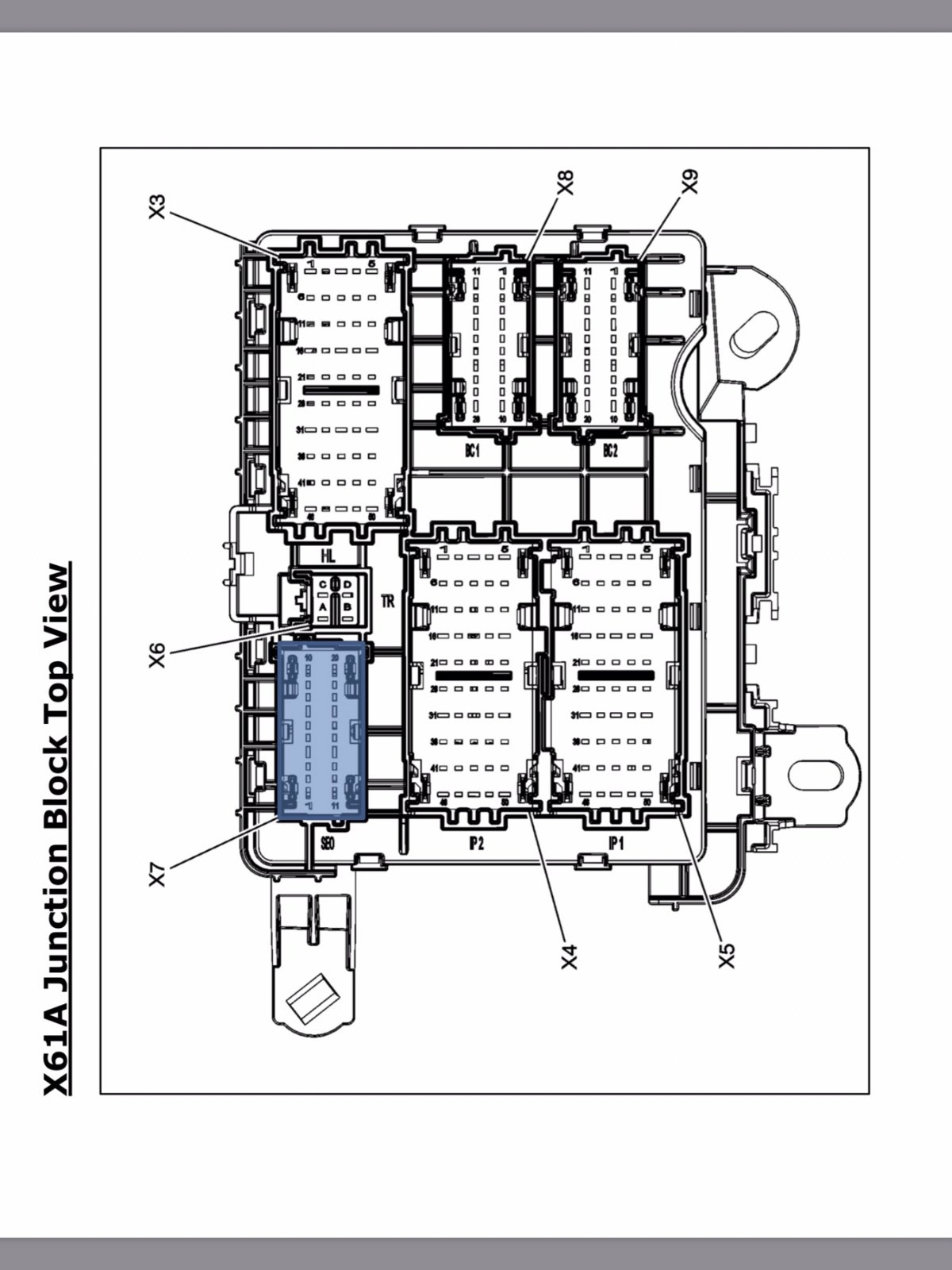

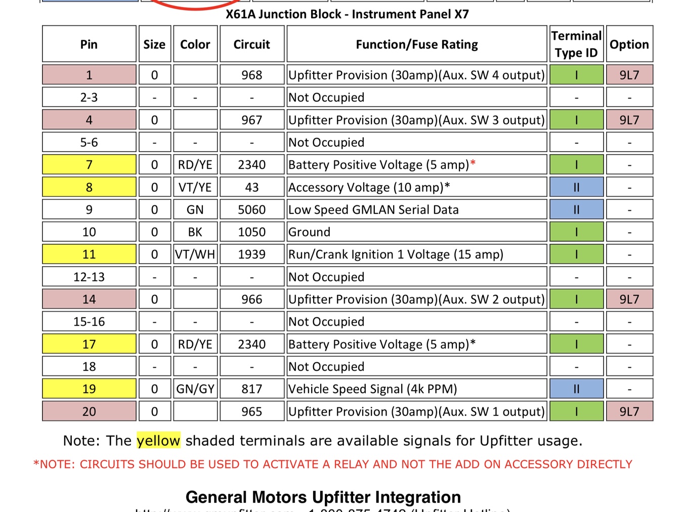

can you share suggestion of where to get constant power out fuse box I don’t wanna taps into a wire or cut one off or snip it . I thought of fuse box to hardwire a gps. Some many fuse box any idea which is the easy way also need a ground too . Is a plug in fuse adapter a good idea those fuse that a have a wire all ready all you do is put it in a fuse box. What your suggestion. New to this need all the help I can get . Thanks all
