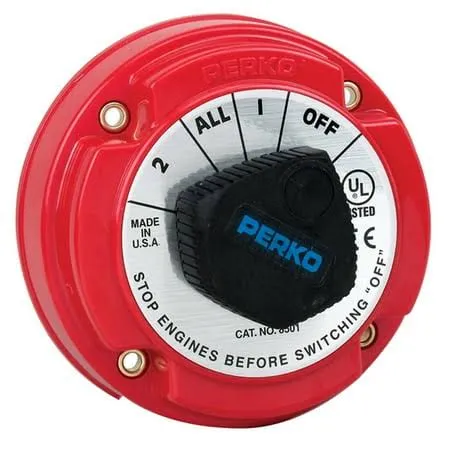

Would it make any sense to install a 1-2-BOTH-OFF switch for a dual batt setup?
5StarCustmSolutns
Nov 25, 2022
275
389
Almost Heaven, WV
Aside from being able to disconnect all in the event of an off-road accident, is there a practical use for one?
Ask because in looking for info on this over the weekend, I came across this doc.
At first I wasn't sure if it even applied to our vehicles, but after looking over diagram on A-11 I changed my mind. Then again on A-27 > A-33 put to rest my lingering doubts...
But what I found fascinating was the info on batteries, grounds, and aftermarket accessories from A-13 > A-22. On A-22 the Auxillary Batt charging, to me, reads like there is an onboard relay if use STUD 1 Fuse 68 for accessories? as described on A-16(?)....
I feel like @swathdiver has read this and could pull out the physical copy, when properly staged, faster than my LC9 can pass a 1/4mi strip of pavement....
Part of me still thinks that only certain pages pertain to the GMT900 (poorly indicated/marked if so), and that the bulk of this pertains only 3500 dsl's? Fascinating if it does apply though..
And if it does, and it is that intricate, could not a dumb battery swith have a role? If both batt have a constant digital Voltage reading, just switch to the batt in need or to BOTH while running and let the onboard regulate the rest?

For camping type use where you might have a slow draw that might deplete one battery, I think a switch would be great.
My thinking is, the parallel setup is simpler, and will be gentler on the batteries by spreading the load and not running one battery all the way down. BUT you lose reserve capacity..
thank you for the insight...
it is camping im concerned about... have 2nd yellow top mounted but not connected, not until I figure switch situation out? have the marine 4pos and a VSR to choose from, and really just dont want another smart anything in my life...
off-road lights and KL5 fan draws mostly only happen when its running...
sleep in it for the HVAC, but it idles until hot or frozen inside then off
reserve starting is what Im hoping to preserve... kind of feel like with the dual voltage gauge I can be SURE i have reserve w/manual switch?

An off switch might be nice to have for theft deterrence.

This is old school manual battery connectivity from my years of EMS in the 70’s. Our ambulances had dual batteries and we had the option of 1 or both and off. We usually turned the switch to off when at the firehall,parked, etc. Occasionally, some times we our ”friends” would engage the lights and siren equipment while in the off mode, expecting us to power up and get surprised. It only took once! But payback was fun!
a bonus perk.. lol
I really just want to hear someone say it's too old of tech. or It wont work w/this charging system?
