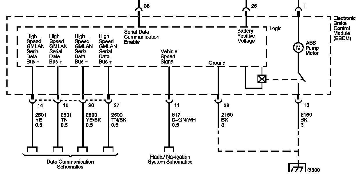

I've owned this Tahoe since Nov '25 and it's had an sporadic ABS issue since I purchased. The code I get is C0110. I've replaced all 4 wheel speed sensors, bought and swapped in a used ABS module off eBay, cleaned the main ABS ground under the drivers door and checked the fuse/relays under the hood. Nothing has made a difference yet. What's bizarre is the truck works fine with no dash lights for entire trips some days, then other days warning lights go off just after start. About the only thing I can think of is there's a connector in the ABS pump that's loose and the pump needs repair or replacement.
Anyone know if there's anything else I can check or where to get a replacement ABS pump besides eBay?

Fless' link says this..
Conditions for Setting the DTC
^ The EBCM motor drive circuit detects a short to battery positive, or open ground circuit, and a continuously on or off motor.
Maybe you get a good enough ground for the logic circuit, but not good enough to activate the pump motor.. ?
One last thing I might try before buying an the ABS/EBCM module, check this ground connection..
(disconnect and clean G300 in the link below, looks like it's under driver side door)
Diagram of G300 ground to EBCM..
