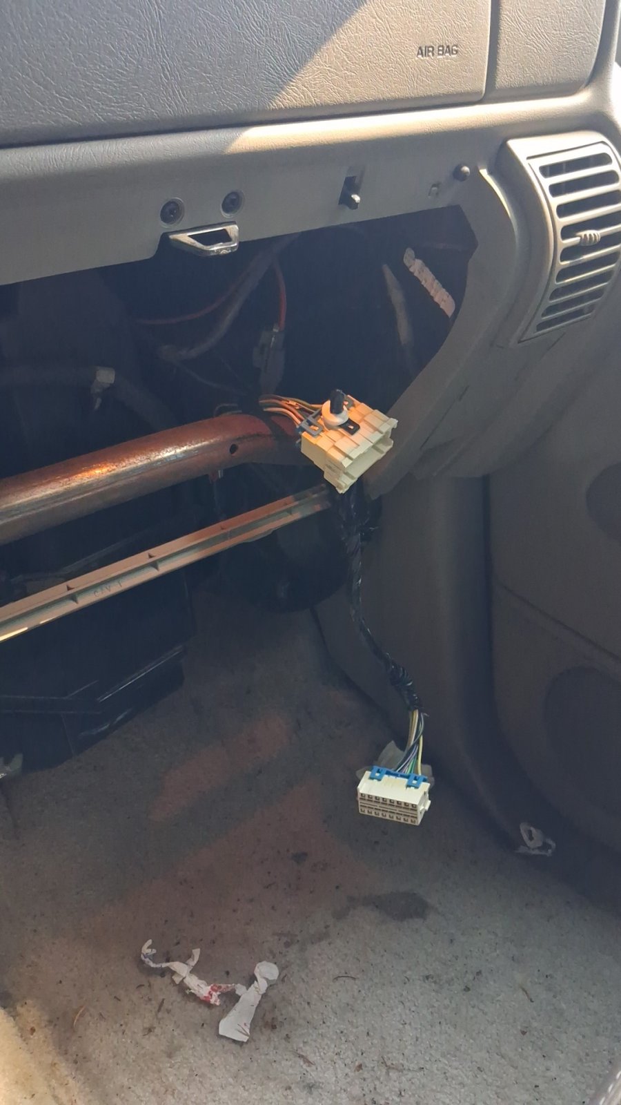

Picked up a 99 hoe on a trade. Kid having issues with it running right. Runs like total shit no power tries to die. I was curious since he installed the deck recently if the plug behind the glove box had anything done with it for the rear speakers to work if I remember correctly, sunlit helped me years ago with this but I can't remember what exactly I did to get rear speakers working.
Funny thing is when I unplug the harness behind glove box it runs perfectly. Has power like it should. But my cluster has no power. Plug it back in runs like total shit again. All the 4wd lights stay lit up and neural light. Turn key off power cuts to everything. 4wd doesn't engage. Kinda lost where to start here. Any help much appreciated

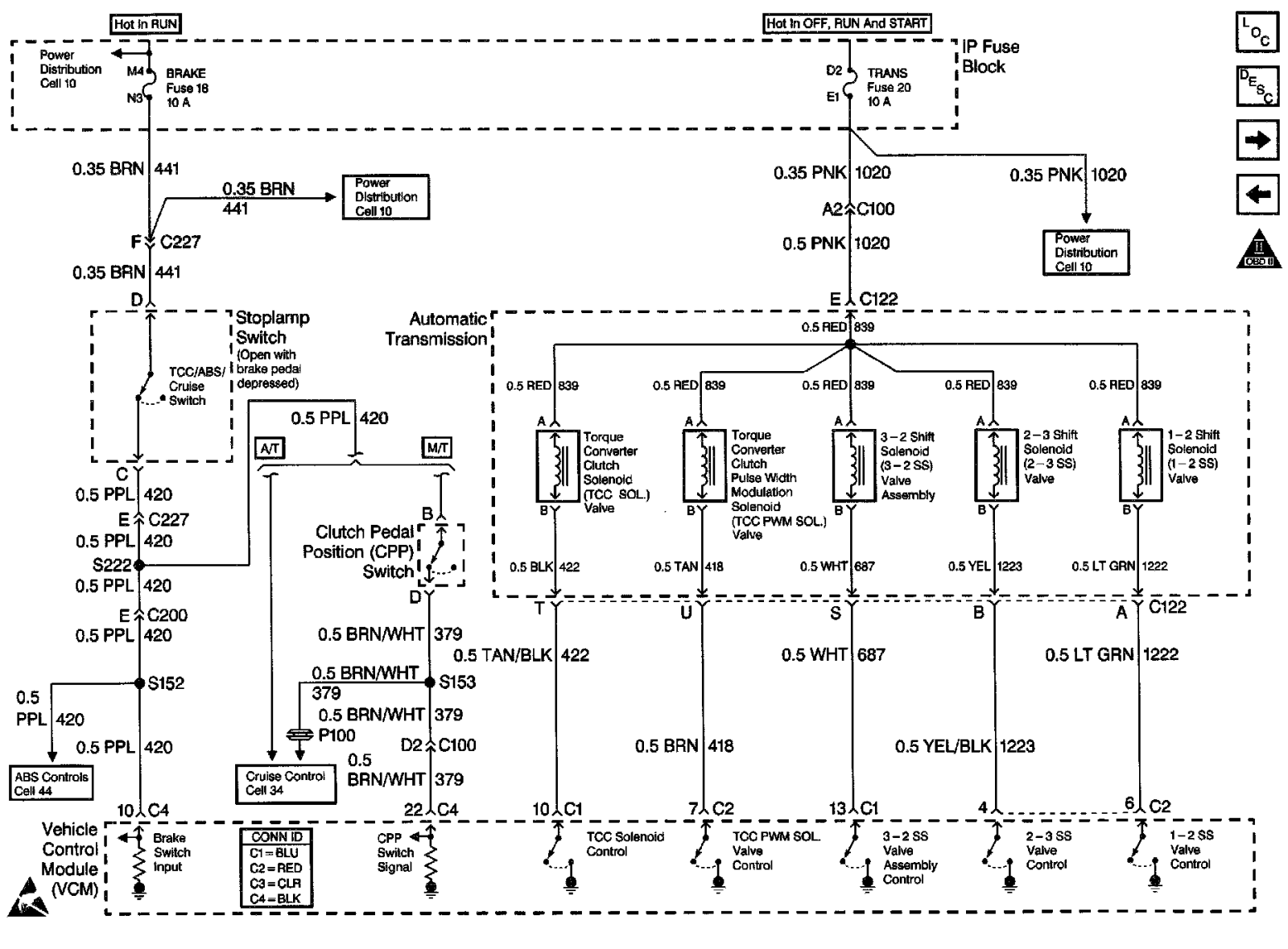

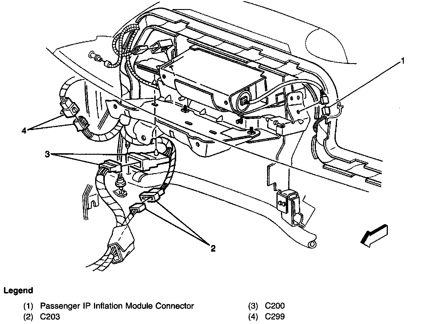

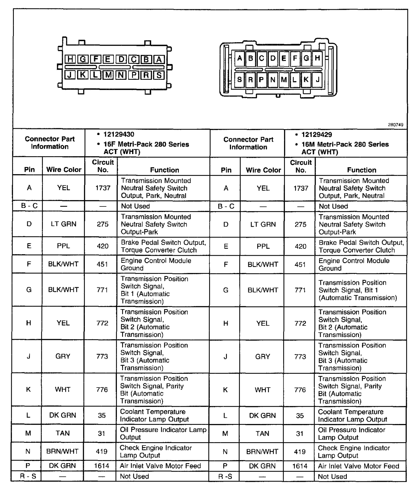

The connector behind the glovebox should be C200, but check the wire colors to see if it matches:

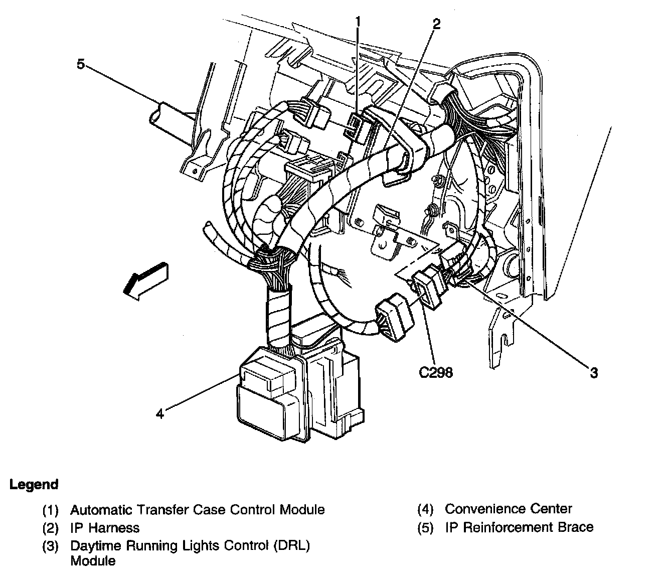

Glancing through the circuits, it’s largely transmission mounted controls but I see one circuit for the brake switch. It’d be worth checking the wiring on that - does the gear indicator show the correct position? The lights on the 4x4 switch could point to the transfer case control module (driver side dash) or suspect wiring going to it.
As mentioned earlier, undoing any “human intervention” in the wiring is probably the first step. JoeBlobs linked the factory manuals above, they have the diagnostic procedures for any codes and symptoms.

Definitely the connector you said. Gear indicator is correct when that plug is connected. With it connected it stumbles to shift almost dies and falls on its face no power at all. Unplugged runs and shifts great. Just got this in a trade hadn't had time look over much yet.
The 4x4 lights are all lit up and the neutral light constantly. 4x4 dont engage low or high. Ill check more like you suggested.

If you have a scan tool, it should read whether the brake pedal switch is engaged or not. That brake switch would impact torque converter lockup so I guess it could throw the computer off if it’s getting the wrong signal.
It’s circuit 420, purple wire on the left of the diagram…
Disconnect C200 and check for voltage at pin E on the connector end that does not go to the firewall. It should get voltage when the truck is running and brake not applied and no voltage when the brake is pressed.
Check the other end too (the one that goes through the firewall). If it’s hot when disconnected, then that’s not right.
Or…if your brake lights are on all the time then that would be an indicator.
