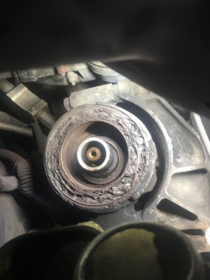

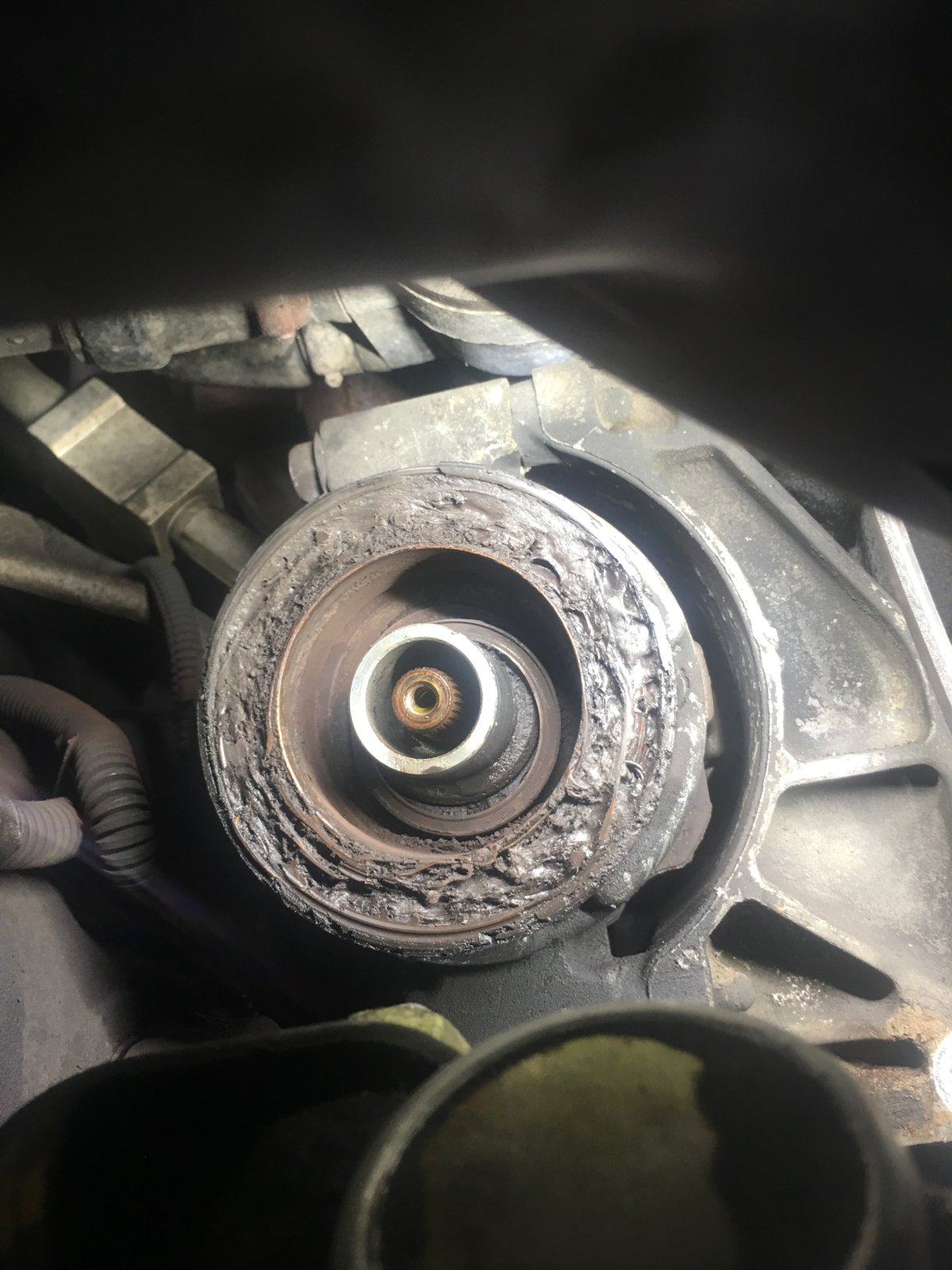

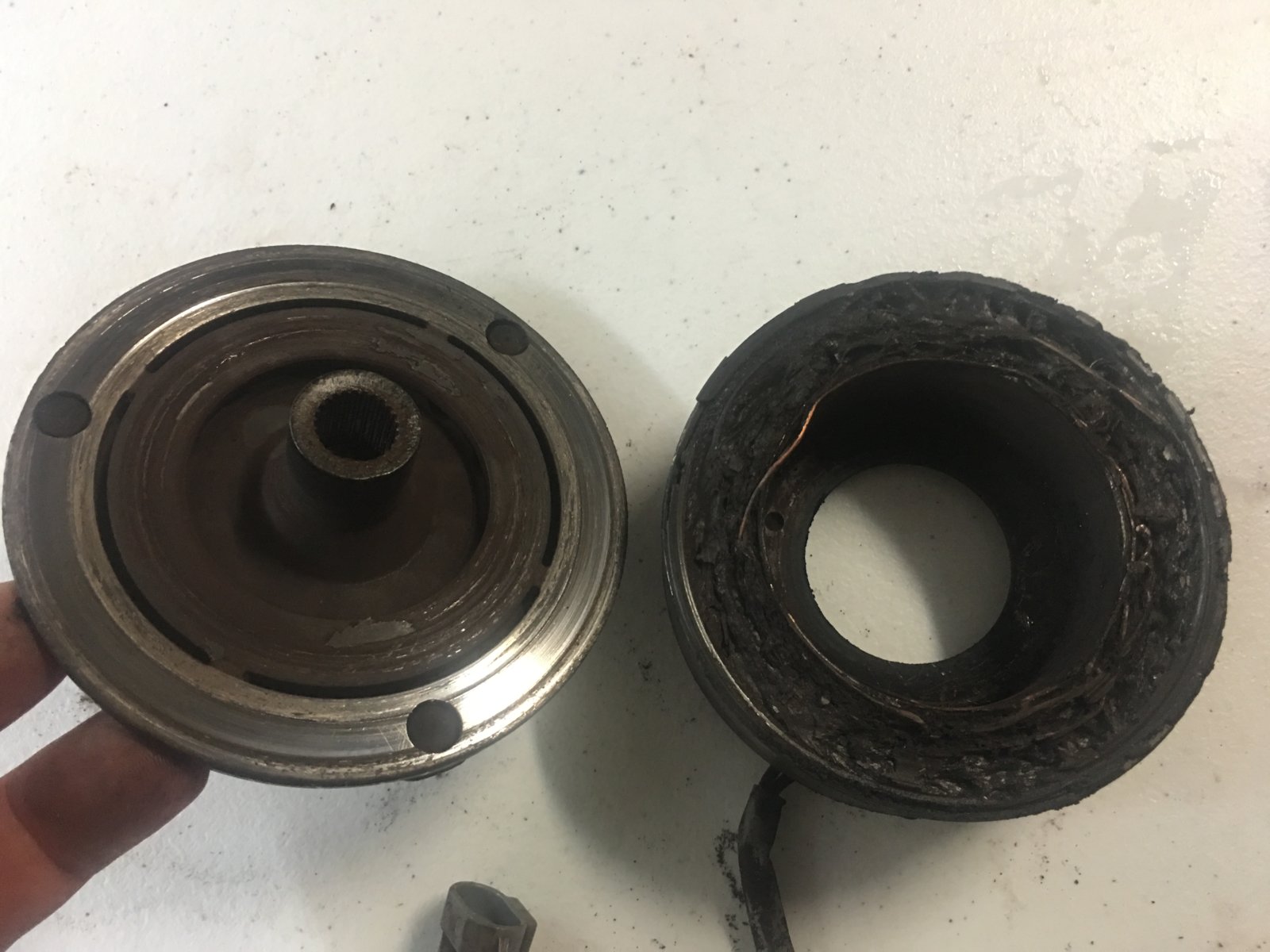

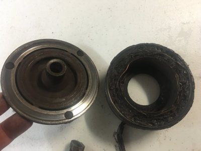

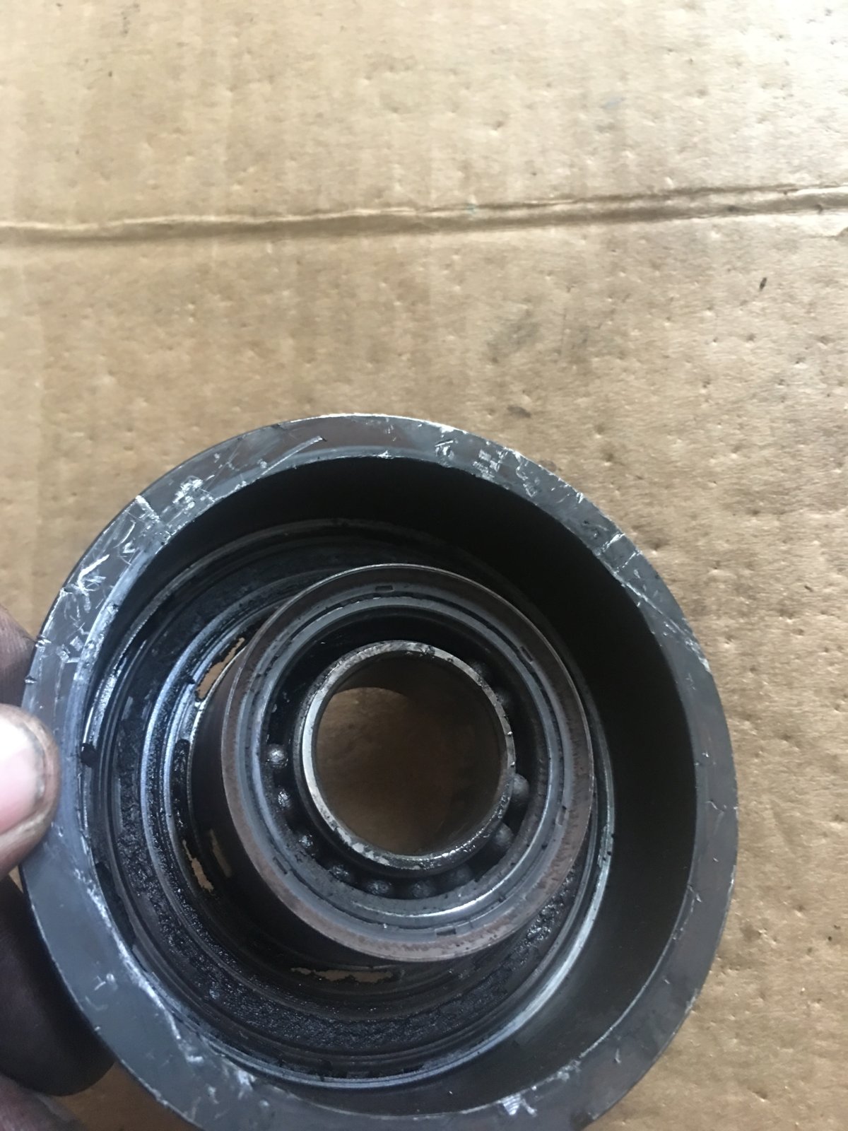

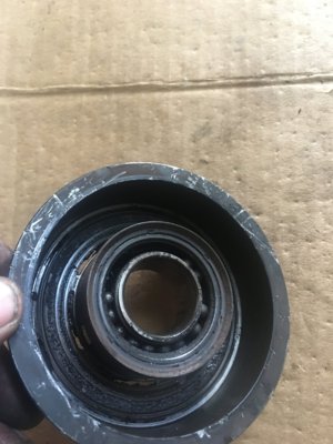

Welp, my ac compressor pulley bearing gave up the good fight. Ended up replacing the clutch, coil, pulley and bearing with a -$100 rebuild kit. Didn’t have to evac/recharge, replace accumulator or any of that jazz. Now back to frigid winds lol I still call it a win in my book. The coils snap ring was a pain in the D I’ll have to admit.

So how’d ya fix it? Bad harness connection? The good ole solder fix?
I've always wanted to do that but could never find the parts. Where did you get just a clutch/rebuild kit? Part number?

@swathdiver The only place I could find it was Autozone p# 47362 it’s normally 144ish but got a couple discounts thrown on it which dropped it to 105 and some change. I just really didn’t want to have to evac/recharge and replace the accumulator etc with replacing the whole compressor and breakin open the system when the compressor itself is still good.
The kit is available online as well but it was cheaper buying it in person which is bass aackwards lol I think online the kit was 160-170? At least what I came across.

Thanks Jason! I could not find and was always told that these didn't exist. Well, maybe they didn't twenty-five years ago when I was looking! We had a number of cars that just needed clutches back then and it was frustrating to go through all that work and expense when something much simpler was all that was needed.

10.4 brother, it just makes sense to me. I don’t get why you can’t Get kits to service every compressor like this. It’s like “ah, crap! The counter weight on my harmonic balancer just broke loose and shifted. Guess I have to replace the whole engine.”
